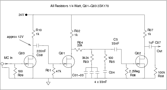

peranders said:Have you checked the working points for all three JFET's? Are the JFET's capable of 12 mA Id?
20mA max...
D
You're at the mercy of whatever current flows with the gates grounded (Idss?, I forget), and this can vary. You might have to adjust the upper three resistors to get the voltage drop you want. Other than that, it looks like it should work fine. I assume the gain is rather low and another gain stage has to follow this.
Conrad Hoffman said:You're at the mercy of whatever current flows with the gates grounded (Idss?, I forget), and this can vary. You might have to adjust the upper three resistors to get the voltage drop you want. Other than that, it looks like it should work fine. I assume the gain is rather low and another gain stage has to follow this.
I guess so...
Conrad - this design stems from here: http://www.diyaudio.com/forums/showthread.php?s=&postid=1550522
and the unit, as designed by Mads K works just fine as it stands with my Kiseiki Purpleheart Sapphire low output MC cartridge...!

If you really want to optimize the circuit, read the optimum Voltage supply idea of Nelson in:
http://www.diyaudio.com/forums/showthread.php?postid=1552988#post1552988
and posts before there...
