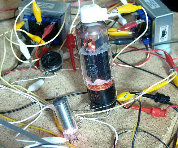

I did some experiments along these lines when I was torturing some sweep tubes at plate voltages that would melt the screen grid. The results were promising but there is only so much to be gained. If you use too big of a zener the G2 voltage can approach zero on low going plate voltage excursions. For those who are sandophobic a gas regulator tube can be used. The photo below shows a 6CD6 with an 0B2 between the UL tap and the screen grid. Do not copy my unique breadboarding method. I think that an 0A2 migh have been more suited because when I really cranked it the 0B2 would extinguish on peaks causing some really rude distortion.
