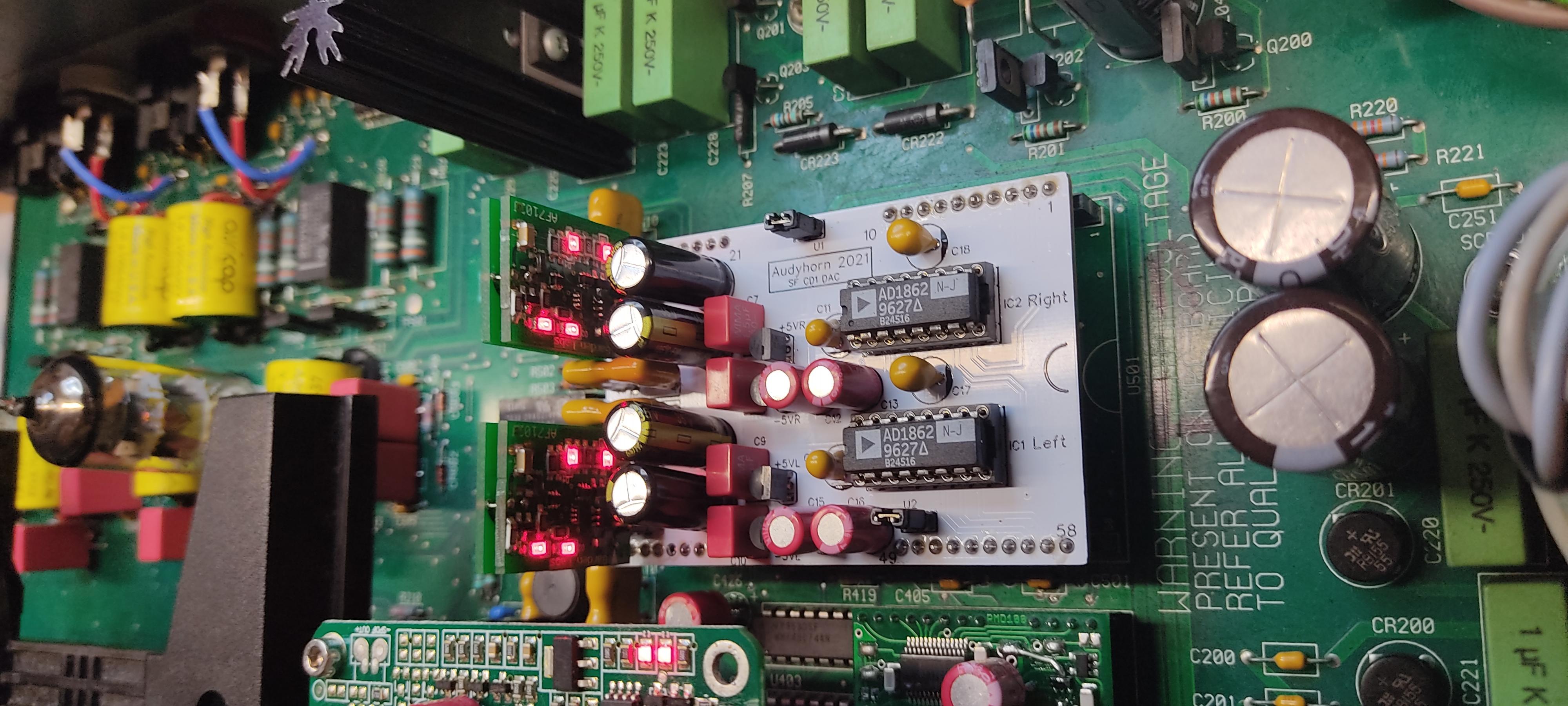

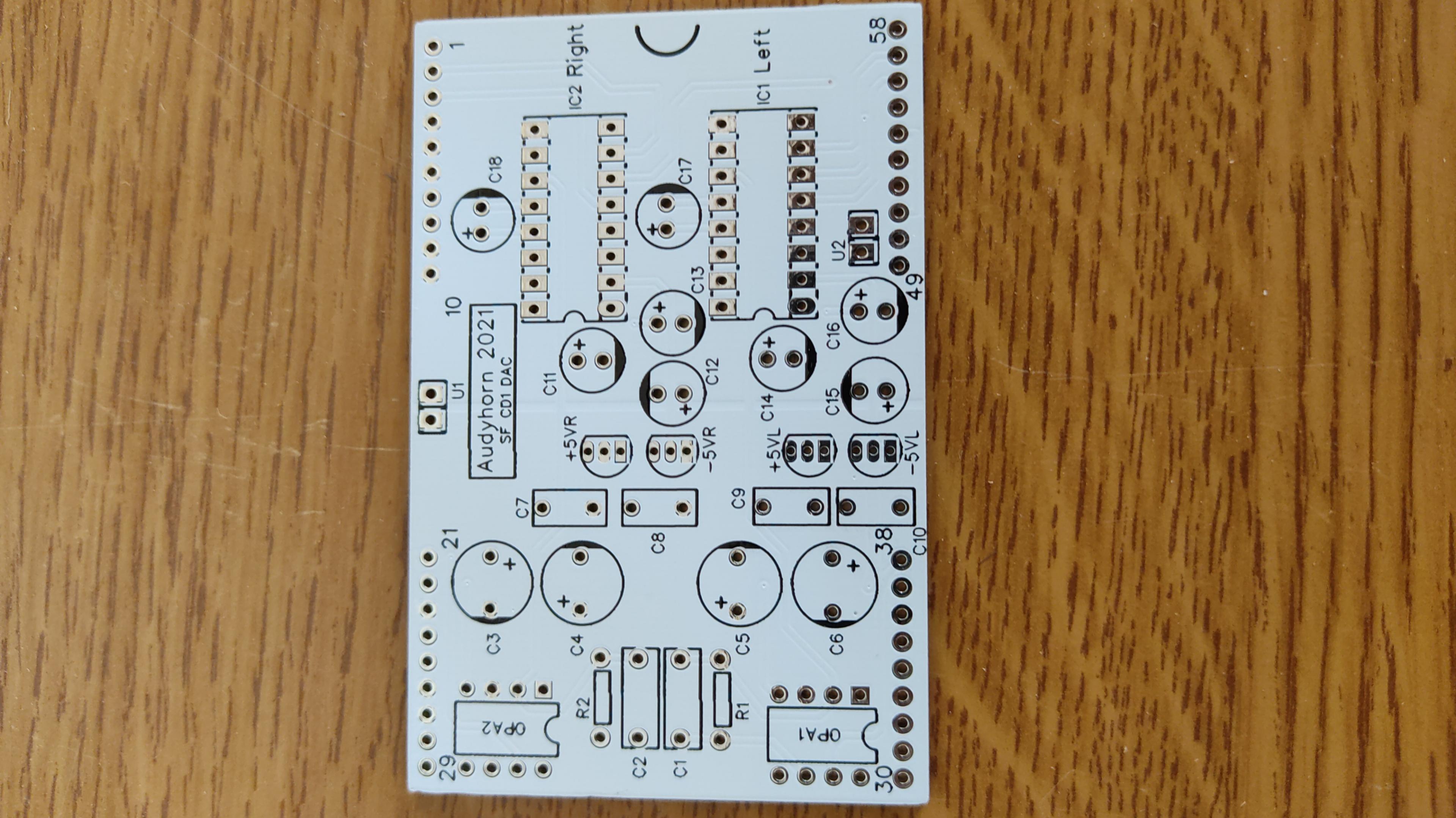

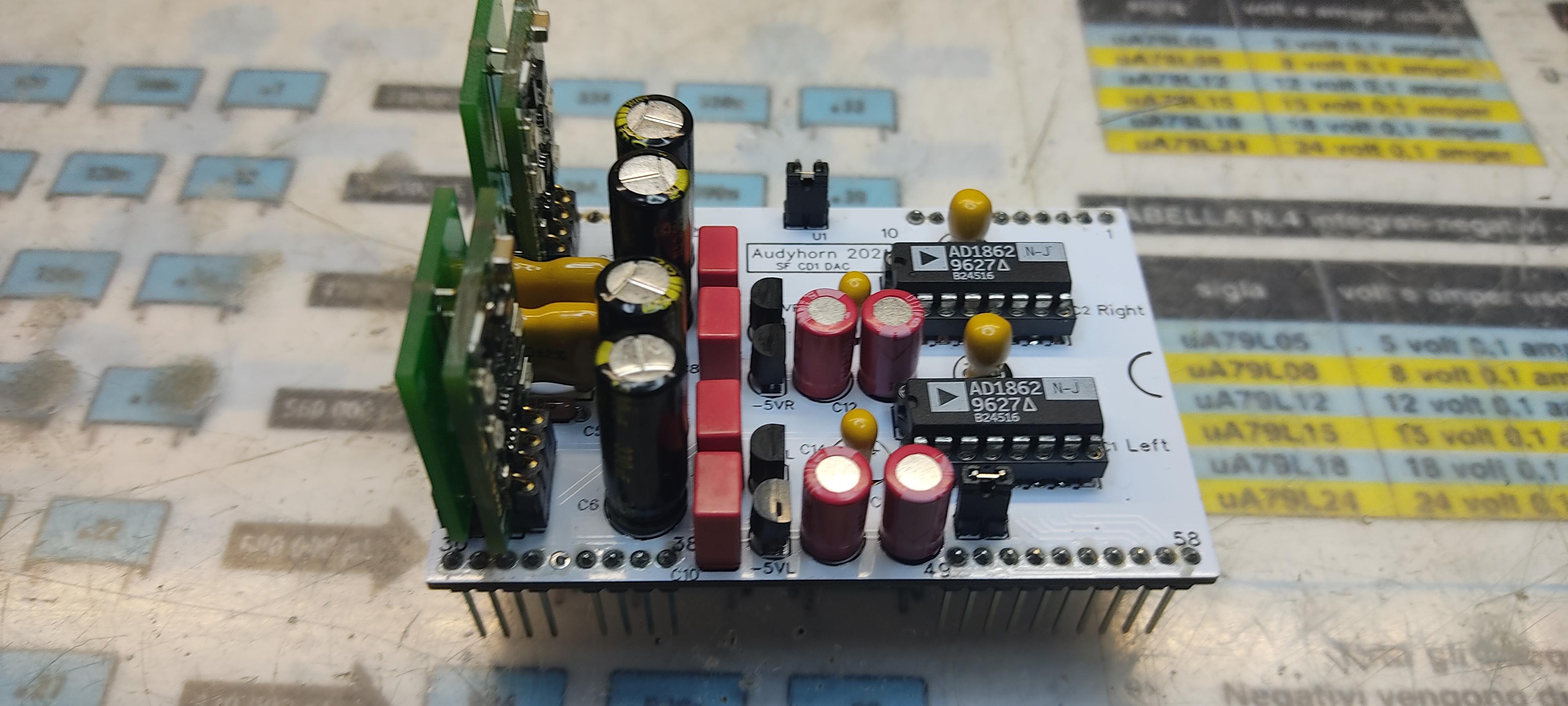

Sonic Frontiers sfcd1 PCB replacement ultra Analog D20400A with dual AD1862
Hello! This Is my solution for UA D20400A
It work fine and It give a very nice sound.
