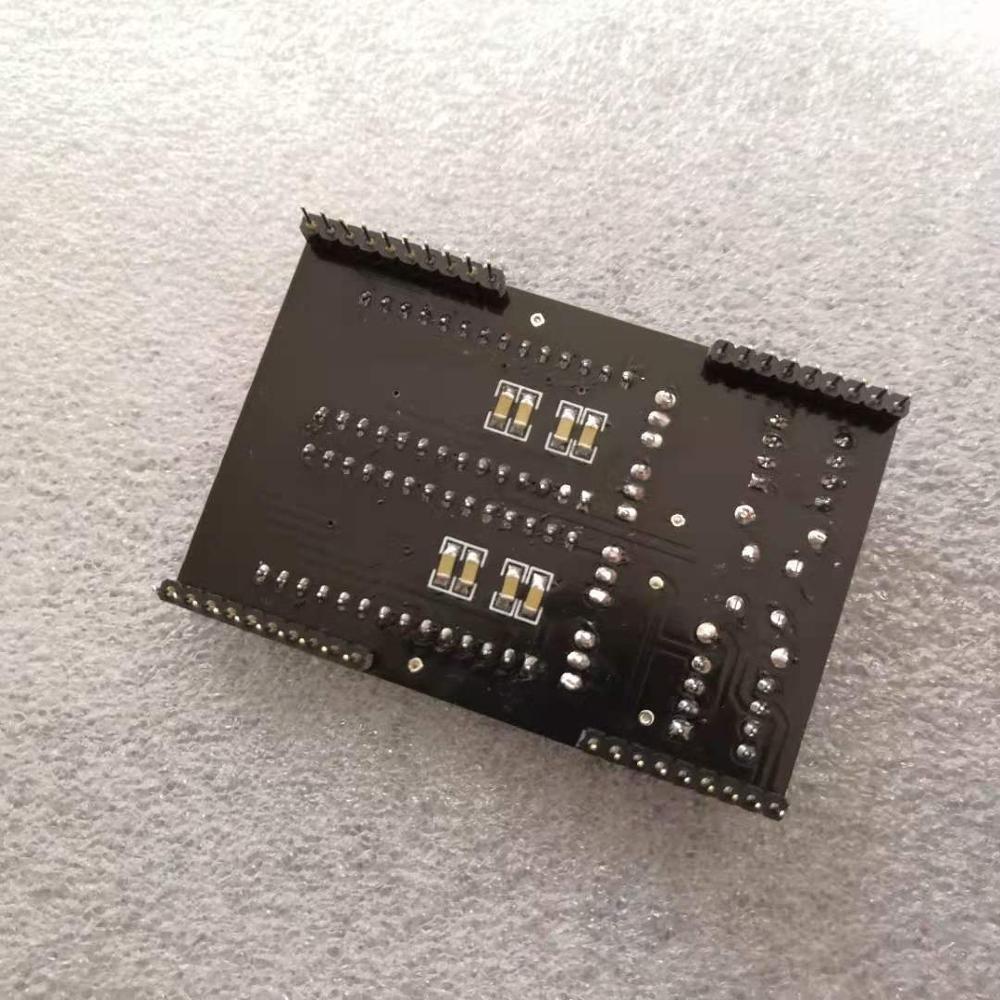

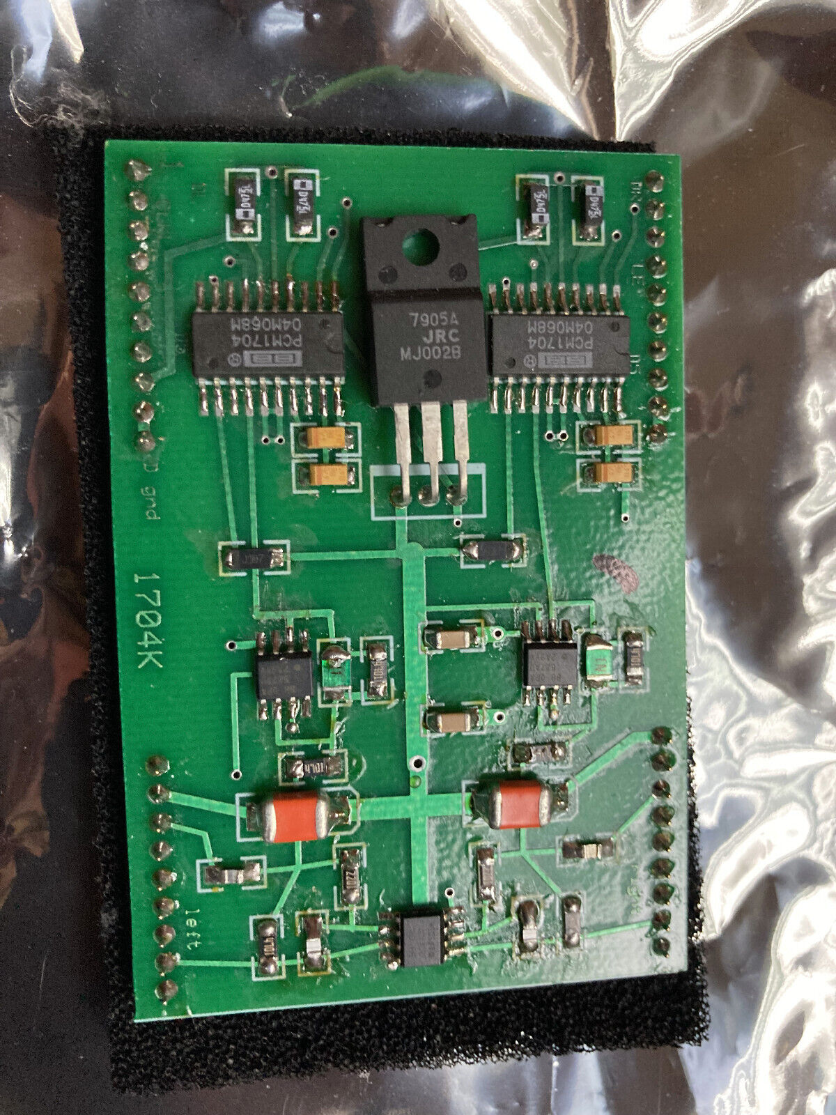

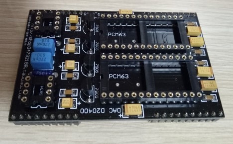

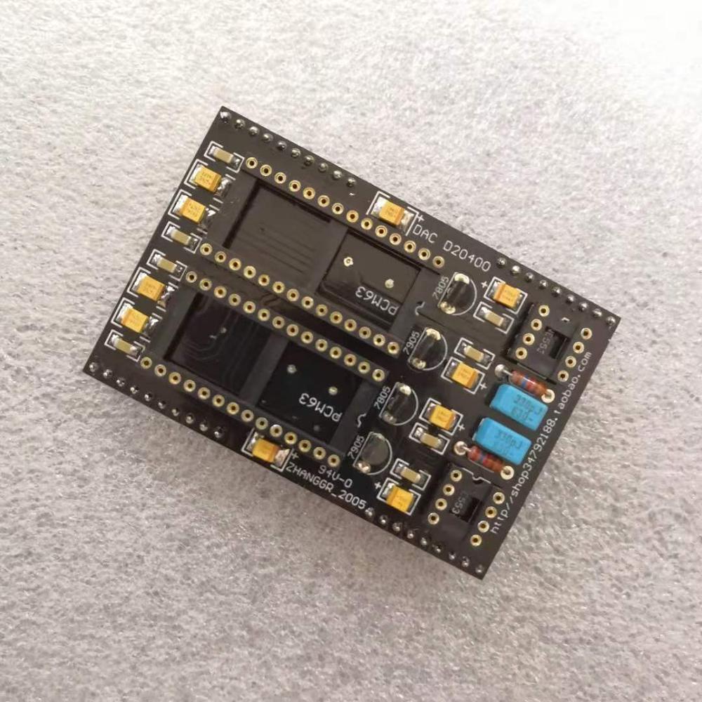

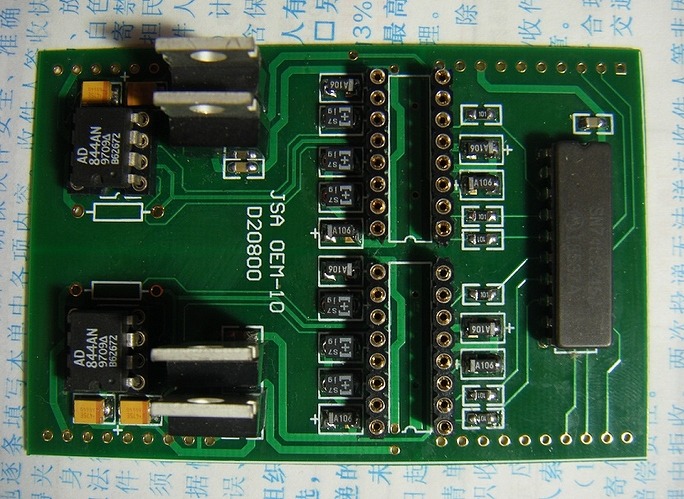

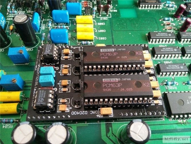

But I cannot believe, that an I/U converter with NE5532 for PCM63 provide sufficiently good sonic results.
What of the replicas from attached images is is closest to Ultra Analog' D20400/D20400a ?
I guess, those with AD1862, but I know it exactly.
How difficult is a replica by use of the old M72H035 (no datasheet and other information on the web) from OKI/Mitsubishi (of course, this only comes into question if this MCU is not the cause of the fault from defective potted original modules) ?
1pc-HIFI-PCM63-DAC-module-Replaces-UltraAnalog-D20400-Dual-2-0-Audio-DAC.jpg141.1 KB · Views: 377
After closer look into that schematic I see that the first 8 MSBs are not string but classical R-2R.
AD1862 is close but not closest, ... PCM63 is also not the closest.
It is difficult to replicate. It can be done with the use of DAC7541 (or another R-2R DAC with parallel inputs) + a discrete R-2R DAC for first 8 MSBs ... best if driven by CPLD (because sample and hold is used).

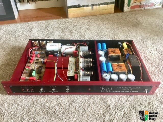

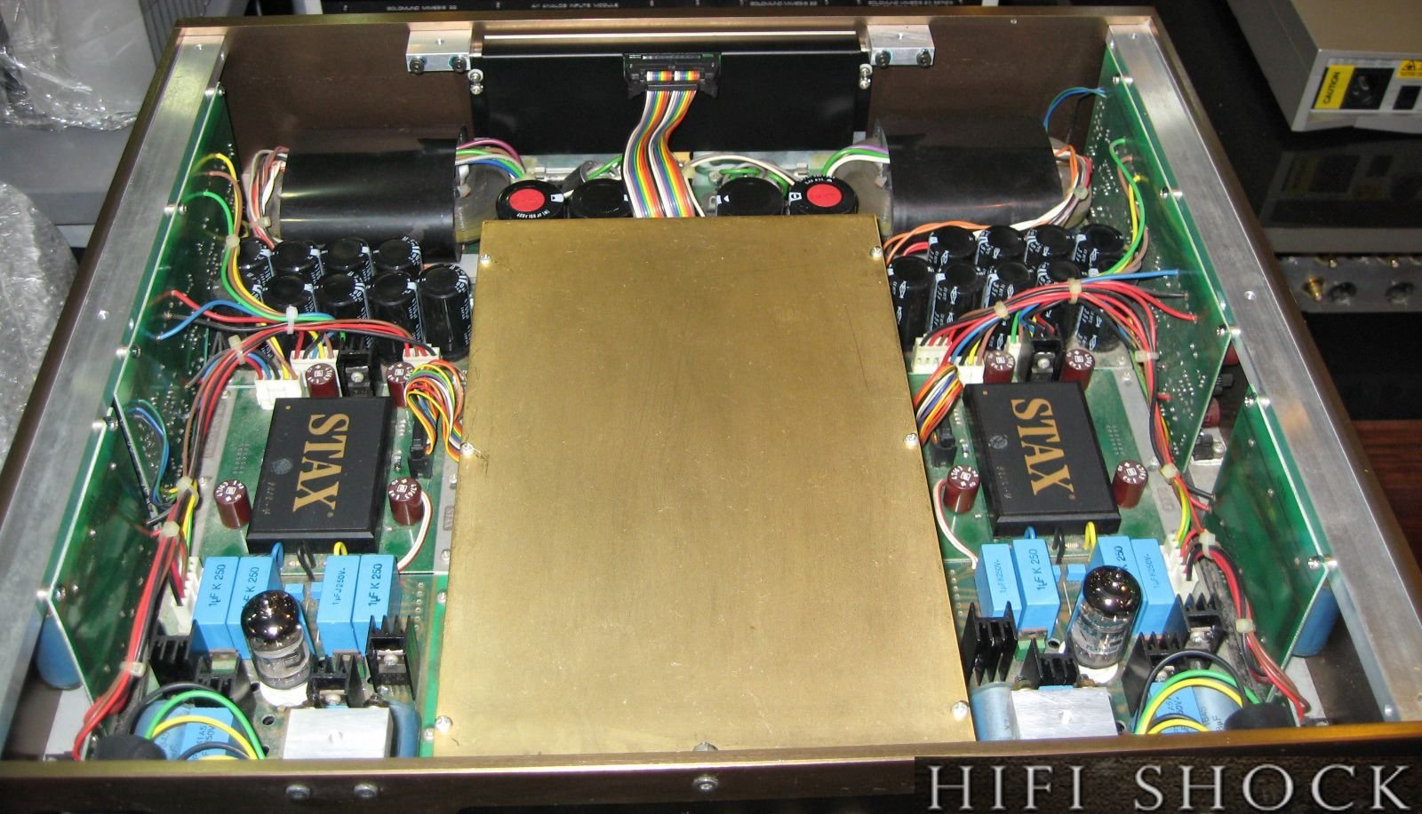

Der D20400 without suffix "a" was in use here (both with tubes for output stage - maybe also for low pass filter:
1) VTL Reference
https://www.stereophile.com/digitalprocessors/vtl_reference_da_processor/index.html
2) Stax X1T
https://www.hifiengine.com/gallery/images/stax-dac-xt1-vacuum-tube-output-da-converter.shtml
https://www.audio-markt.de/en/market/stax-x1t-tube-dac-converter-5400829550
Maybe there are additional papers not to find on the web.

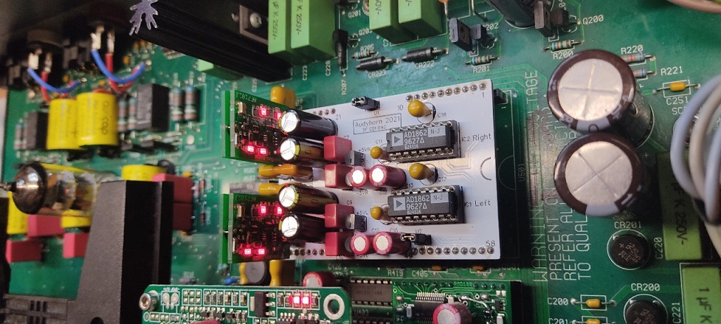

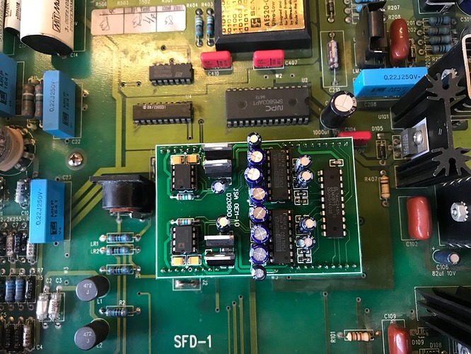

Hey all,
I have an 30-year-old SFD-1 DAC with the epoxied UA module in it, and I think it's failing...
The DAC has audible crackling, hissing and all around distortion, that randomly comes in and out at any time (used to be just upon startup). I've tried troubleshooting all areas I could, next is the power supply caps and tube sockets, but I've already tried everything I can think of to rule out other causes.
Question is: is this what a dying D20400A module sounds like? Or could it be some different issue?
2nd question: does the AD1862 replacement module sound at least similar to the OG UA modules in SFD-line DACs?
