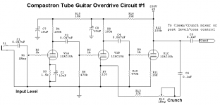

Hello!
I am lookin' for an ultra-easy distortion effect to build. If you guys can help me I would love that coz I have tried to find in google, but couldnt find anything interesting. Plus I dont know too much, so I dont know exactly what is a good, working and easy schematic. So I basically have hard time to find. If you guys can help me that would be Awesome! 🙂 Thanks! :eguitar:

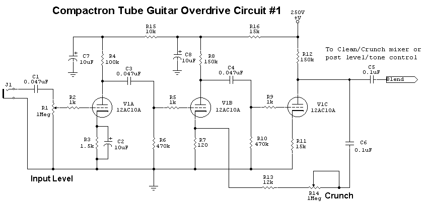

you can forget the input and output buffer (BF245a and related components).. just straight in the opamp (cap, biased at 4.5Volt).. and striaght out to a 100K pot...... that's how I build them... higly recommended...
offcourse a tube schematic is a totally different game.. both sound and build-wise.. 250Volt on a stomp box is not recommended ......:hot:
