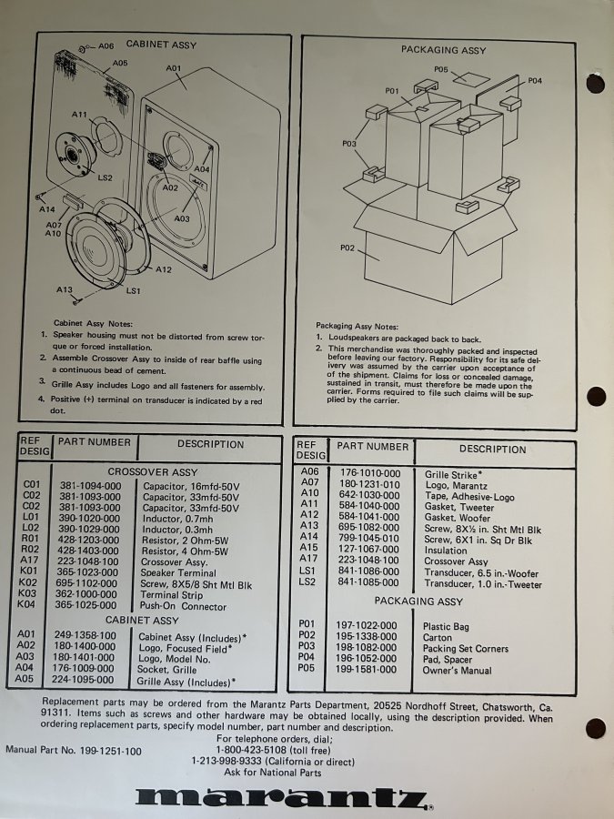

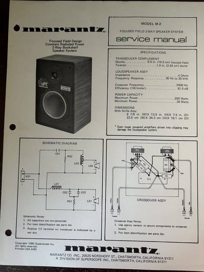

Hello,
i recently acquired a pair of extremely rare Marantz Model M2 'Focused Field' bookshelf speakers and would like to replace the 6.5" bass drivers as the ones they came with are very cheap replacements and the originals are basically impossible to find.
i am a neophyte so please bear with me, and i have attached all i could find after much searching. i hope to gift these to an ailing friend and realize there are some variables to consider, but i am not familiar with the calculations and time is of the essence in this case. i did find something within my budget and, assuming i needed 4ohm drivers, wondered if they might be suitable or if anyone could recommend something better:
Maybe a Scan speak 18W/4424G00 would fit with a little work and has a response that should allow you work up a Xover if you have measurement capability and can use a Xover design package.
I haven't checked the SB acoustics website maybe their 6.5 Polypropylene 4ohm driver would work. Although its dimensions are slightly smaller .
As to its T/S params you will need to go over them to see if they are in the ballpark. Both drivers can be made to work at a 2.5K Xover. I don't know how they will perform in the bass if it is a sealed cabinet?
I do not know if your Marantz is a vented design. If so Both drivers would work,. If sealed the Scan maybe give a little more bass for the box size.
Actually the Peerless SDS 830657 6.5 inch driver may be a cheap and effective quick fix however its 8 Ohms impedance which would mean a redesign the bass portion of the Xover. I Imagine it all comes down to how much time and effort you want to put into this.

For that damage, you might be better of looking at an existing two way project for which that sealed box size (about 12 litres) might work for you. Something with Peerless, Dayton, SB Acoustics or Vifa drivers - low cost but good performers.
There would still be the rather important issue of finding drivers which fit, unless you particularly want to perform surgery on the baffle. Could you please let us know the measurements of the cut outs and rebates in your cabinets? Are the dimensions of the possible replacement woofer the same as what you have - if so, we could work with those but we'd still need those details for the tweeter, assuming you want to go down that path.

Unfortunately, i do not have much time at the moment to research design. i just wondered if there happened to be someone in the forum who might know of a driver that would be a (more) suitable swap-out based on the attachments, which contain the speaker's dims/specs, The driver i was considering seems to fit the opening and has a good bottom end and fairly high power rating for the size.
They don't make midwoofers with anything like these kind of specs (for closed box in 4ohms) anymore. You may find any number of things that fit the cutout, but the likelihood that the acoustic response of the replacement with the existing crossover filter will still match anywhere close the original design is almost zero. Closest I could think of that has anything remotely close to the original specs and is still available, is the 8ohm Seas CA18RLY.
Reactions: OneTakeEd
I has a quick optic at various drivers; there are some 4 ohm rated drivers which would fit the cut out, such as the SB16pfcr-4 and Dayton DC160-4, but the specs such as dB, QTS and FS are different, sometimes markedly, and that's without considering the sound. I haven't seen any sealed cabinet projects for your sized cabinet and those drivers, so I don't know how they might perform in that situation.
Of the two, the SB is higher quality, more expensive, higher efficiency and has better mid-range than the Dayton, IMHO. It would also better suit the brochure's stated XO point of 2400Hz.
A Peerless 830657, which can be surface mounted, would be cheap and could work in that size sealed cabinet (I think, someone please correct me if not) , but it's an 8 ohm woofer so the crossover would have to change anyway. Not many two way projects for it, although I've done one with a Vifa BC25TG tweeter. Driver cost in Canada for that one would probably be around the same as the woofers in your initial post.

These are air suspension.
