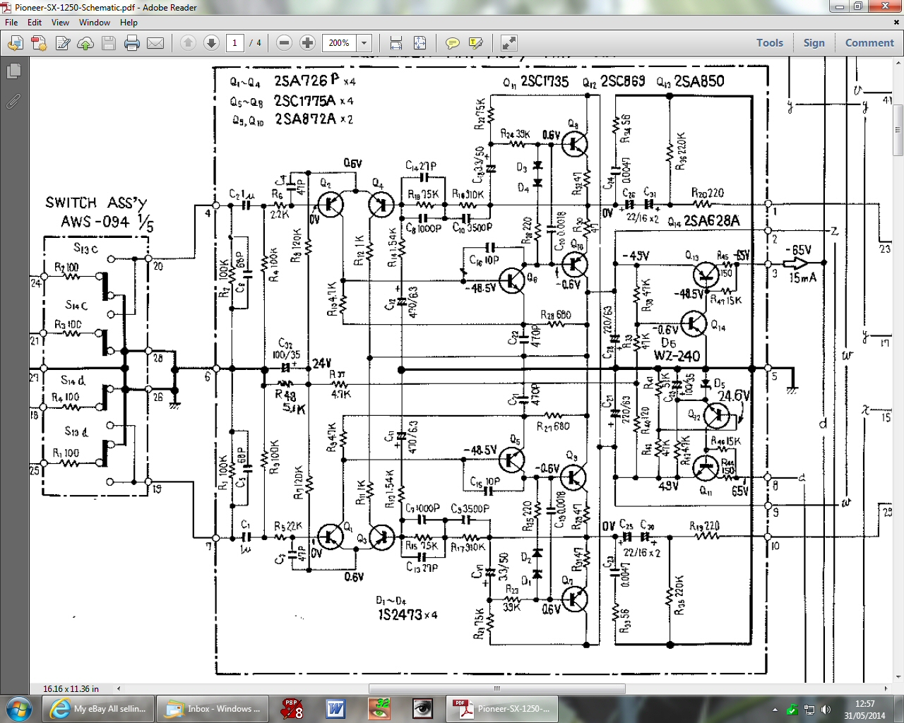

Replacing the electros, yes. I doubt you would gain much replacing resistors tbh. Sony stuff of that vintage used decent parts, and they are low value anyway so noise contribution is minimal. The transistors... maybe... but Q101 and Q102 could be more specific than you might think. You would have to try it. Q102 might be worth looking at replacing with a larger device (bigger die) such as a BD132 as an experiment.
-/+20 volts ? It looks single rail to me apart from possible negative bias for the FET muting.
Regarding the resistors, in the schematic I see 47 ohm in series with the input and a 100 ohm series feedback resistor. I wouldn't consider that low value at all, they are far above the resistance of a moving-coil cartridge. Still, if you want to drastically reduce the feedback resistance, you basically have to redesign the head amp. The 47 ohm at the input can maybe be replaced with a lossy ferrite bead.
The bias point seems to depend on matching between D101 and Q101, which will complicate transistor replacements. If the VBE and/or hFE values are substantially different from the original Q101, the head amp may not bias properly.
Sorry I forgot this is a diagram for the pre-amp I am going to use (when it arrives:grumpy:) )
It runs on +/- 65vDC which is the same as the power amp rails so I will see first how it works out.

According to the datasheets:
2SA1455K: noise figure of 3 dB at 100 ohm source resistance, 1 kHz and optimal collector bias current (1.8 mA)
Not quite as good as 2SC2547, 2SC3324 or 2SC2240, but certainly not bad. However, I don't find the 2SA1455K on the Rohm website. Is it still in production?
2SC3722K:
minimum noise figure of 3 dB at 200 ohm and presumably 1 kHz, 1.4 mA, the frequency labels of the graphs appear to be mixed up
There are no noise graphs in their datasheets, but judging from the data that are given, they could be quite good.
That is, RB=2.8446 (2SCR293P) or RB=2.3056 (2SAR293P) is a very good value and it sounds like Rohm seriously tried to extract base resistance, rather than just plug in some number (unlike the libraries that were supplied with PSpice that had RB=10 for all transistors). Of course this is no guarantee that they extracted it correctly for noise modelling, they could have extracted a number that gives the right VBE at high base currents without modelling the base resistance's current dependence.
These transistors also have a high hFE, that is, a favourable ratio between collector and base shot noise. The hFE versus collector current graph shows no sign of hFE roll-off at low currents; at least not down to 1 mA, they didn't measure any lower. That's important because the non-ideal base current component that causes hFE roll-off usually has a large amount of 1/f noise associated with it.
You would have to do noise measurements to be sure, but they definitively seem interesting.
