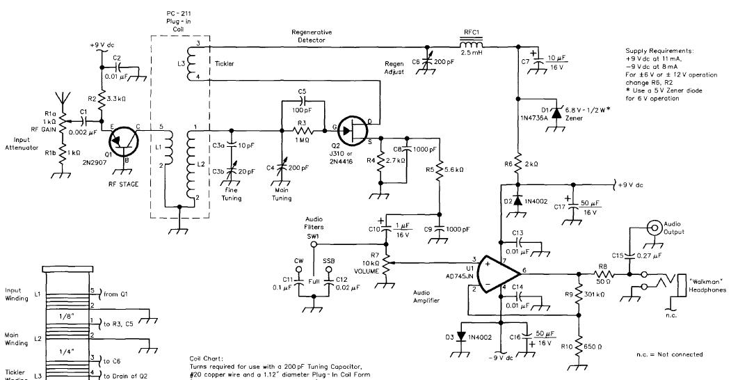

I need an ultra low noise very low distortion preamplifier for driving mainly headphones.
The source will be the output of the FET in the attached radio circuit. I will replace the opamp so a good headphone preamp is needed there that will be capable of handling the very low power input signals produced by the detector. Very low noise and distortion are needed.
I know it may be hard to beat the opamp, but I would like to make it using discrete components.
Any proposed schematics to look for?

Do you know the S/N of the detector output? I would expect it to be much worse than the opamp. In that case, it is useless to mod the preamp for extremely low noise because you will still hear the noise in the source signal.
The switchable low-pass at the detector output will also give a hint that noise at that point may be problematic.

I really do not know that. I just need a good quality preamplifier made out of discrete components, that will be able to amplify the very low power detector signals up to the headphone level, without adding much more to the receiver audible noise and distortion.
Since I need practical circuit it would be very convenient to me if anyone could propose a such tested and well known circuit. Class of operation is not of a concern, although class-a may be better for lower distortion.

For very low level & noise, you could look to a mic preamp. These are designed for such a purpose. There must be many here on the forum.

That is a slightly strange circuit, a cross between a regenerative grid leak detector and infinite impedance detector. The output will not be particularly low noise anyway, or low distortion. Any decent opamp should easily exceed the performance of the RF part of the circuit. Alternatively, two or three discrete BJT stages would do, at greater expense and complication.
N1TEV states in his article that is good compared to a single conversion superhet in terms of audio quality as it uses only one mixer stage and is avoids the 3db noise that the image signal would add in such a superhet. Anyway, do you think a microphone preamplifier would be suitable, and could you suggest such a good circuit using discrete devices?
Having only one mixer does not affect audio quality. This circuit does have image noise, its just that the image is 3kHz away instead of 2x455kHz away. Either you have misunderstood N1TEV or he has misunderstood what he is doing. In my opinion it doesn't need anything as sophisticated as microphone preamp. On the contrary, it would benefit from a severely restricted frequency range - say 300Hz-3kHz. My advice is to build it as shown in the circuit. You will learn quite a lot about electronics by playing with it.

When receiving AM that circuit, like most circuits, will pick up both sidebands. When oscillating, to receive SSB or CW, it will receive both the desired signal and the unwanted image. It does not have anything like enough selectivity to reject the nearby image. It is possible, with much more complex circuitry, to eliminate the image either using filtering or phasing but these simple circuits can't do it.
People may be getting confused by so-called 'zero IF' receivers, also known as 'direct conversion'. Some of these do eliminate the image by using image-cancelling mixers. It does not follow that all DC receivers eliminate the normal superhet image - simple ones just have it adjacent to the wanted signal.
You need to bear in mind that radio websites and discussion boards can contain just as much nonsense as audio ones!

Your explanation of DC SSB reception is about right, except for a minor issue. You are confusing 'beat frequency' with 'difference frequency' - people often do this at first but it can lead to more confusion later on.
In a single-conversion superhet the image is filtered out, so does not contribute to the noise, apart from internally generated image noise within the mixer. This internal noise is still present in an AM detector, so there is no 3dB advantage. Some crude receivers do not filter or otherwise remove the image, so they suffer a 3dB disadvantage when compared to a better receiver.
