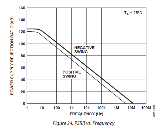

With a 9VAC transformer and a bridge rectifier made from four 3A, 100V Schottky diodes, it appears to me quite straightforward to implement a Jung-Didden "Super Regulator" with all thru-hole components. I'd suggest the 30 year old, ultra low noise OP27 opamp in the DIP-8 package. It's been in production for decades, it is manufactured and sold by more than one semiconductor company, its minimum operating supply voltage is compatible with this set of requirements, it has excellent supply rejection (image 1), and it has ultra-low noise as requested (image 2).
The only circuit change is to undo the supply bootstrap. Instead, power the opamp from a filtered version of the input. RCRC ladder with R=47 and C=1000uF (25V).
I'd also increase the filtration between the VREF generator and the opamp's VIN+ pin, perhaps also using Walt Jung's excellent GLED431 (LINK) as the VREF.
Ultra low noise, easily obtainable components, proven design, thru hole construction, what's not to like?

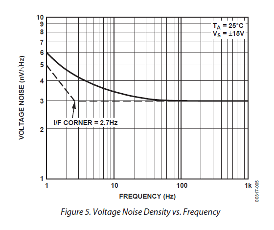

The noisefloor, on noise density scale, sat around 220pV/sqrtHz for my discrete design, and a bit higher for LM3x7/LM338. I think around 330pV/sqrtHz (without the LNA+ADC noise). In audio band it comes out at around 45nV total.
PSRR is ~150dB, especially with the NoNoiser.
