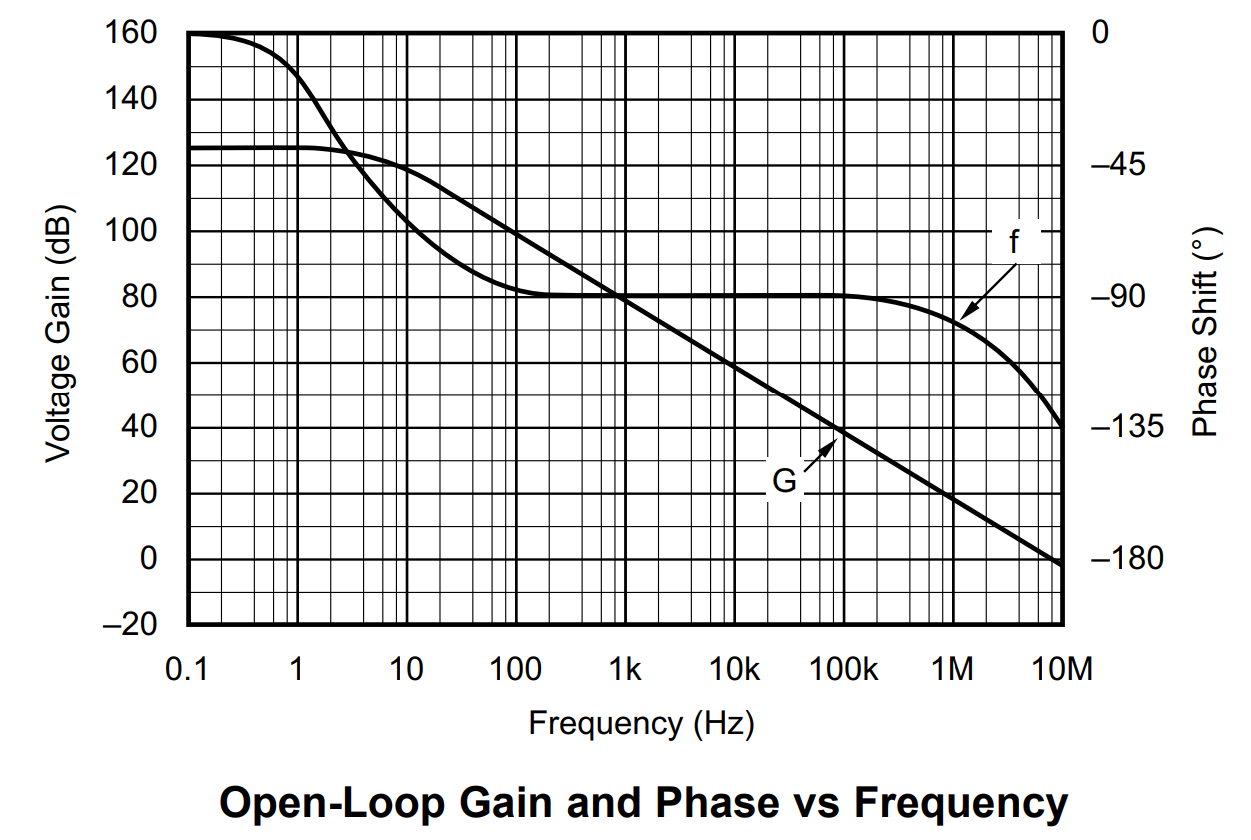

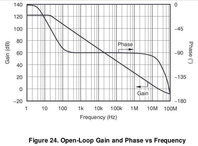

yes Pythagoras helps a lot - but if you calc a need for >10 MHz GBW then I'd buy something with >20 MHz "typical" spec
OPA827 would be a candidate by my thinking
If the source Z is low enough to warrant then the OPA211 but feedback layout may be tough
even have to watch the op amp's open loop gain low freq response - need lots of excess gain where it flattens out

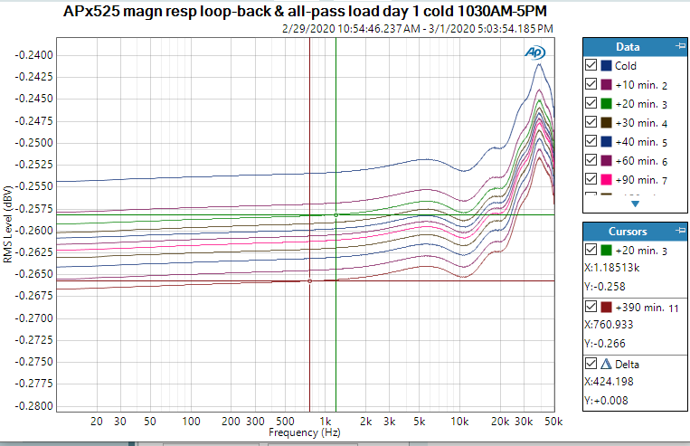

Did you see the AP performance in #41? It is not perfectly flat, but the shape doesn't seem to change while it drifts. So this seems gain drift indeed.
But it is on the same order as the non-linearity.

Sorry I thought the legend said it all. It is the AP in loop-back, essentially measuring its own oscillator. I was working on a very low gain drift circuit as well, and it showed some drift with temperature. In the first hour, each curve is at 10 minutes interval, later the intervals are longer, see the legend in the right column.
So then I tested the AP itself, with the test you see in #41, and found that the AP drifted more than my circuit. Note that you cannot conclude from this whether it is the oscillator that drifts or the analyzer.
So if you can do better than this, you are in good company ;-)
Jan
Jan
