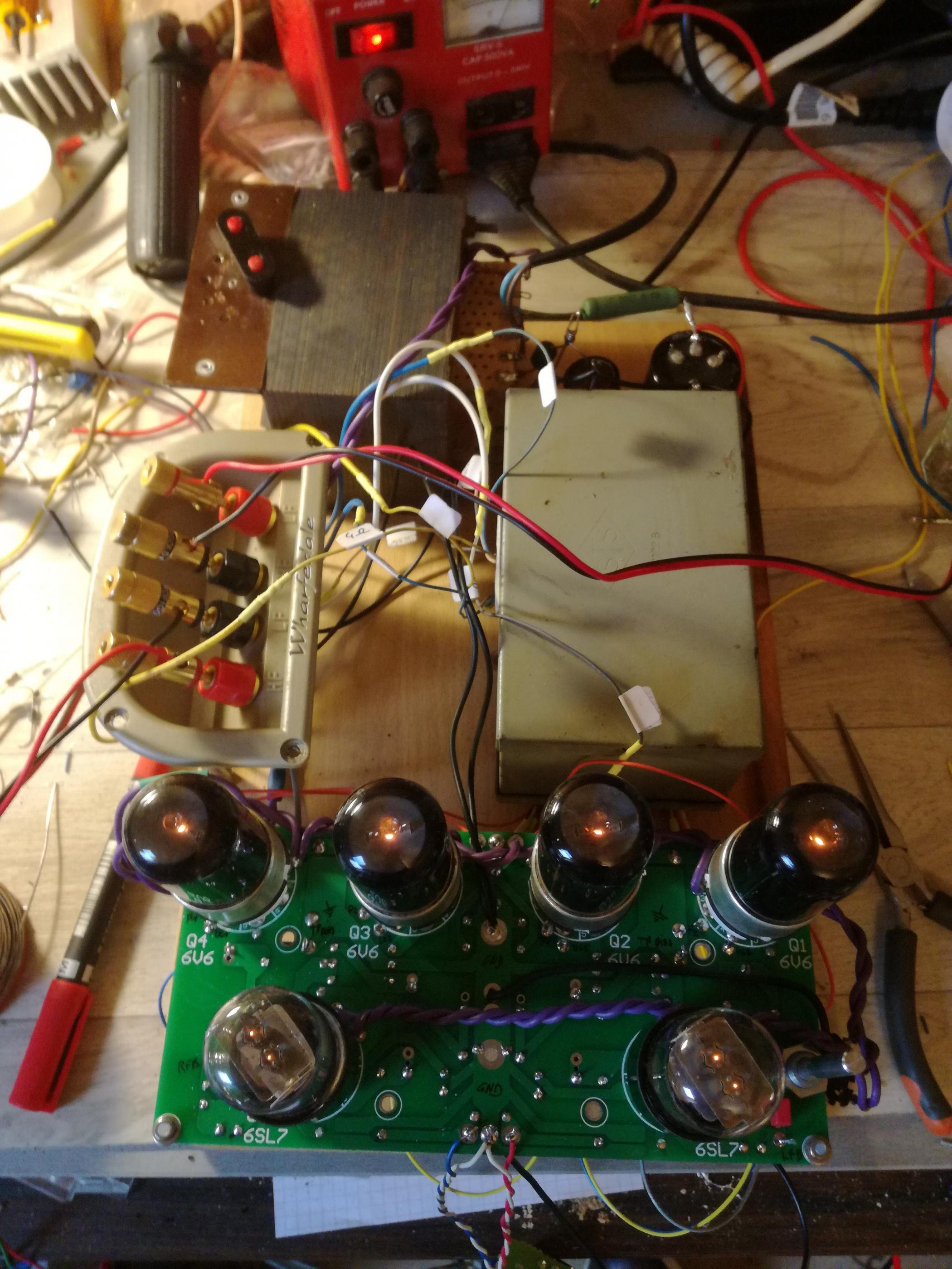

he is still on the bench the time to finish the test. for now he's still on suicide speakers, realistic minimus7. my diet is a little low in tension, and the bias is also a bit low but it is already working very well.
i have an old industrial power supply box from the 70' for him,it will fit him like a glove 🙂
it is a little bit clear with a real speaker (jm lab opal19) ... in fact, I had mounted with 6p6 Chinese because it does not matter if I burn them, but in any case, they are really bad (I had never listened before), I went to Russian 6p6s and it's already much better then I'm doing a test with tungsol and it's not bad also now I'll try in pentode mode then triode and also as suggested before, with 6sn7. it's a bit tricky for me, I do not know the floating paraphase well, but I'm going to learn

I still have one of these boards sitting in my project bin- I cut some traces and modified the front end to a gain/concertina setup, and populated the board but have not yet completed it, as I don't have any suitable iron on hand. Using a 6N9S input tube for it. The plan is to go tetrode mode output. I have a dozen Russian 6P6S to dig through and use with it, lovely tubes 🙂

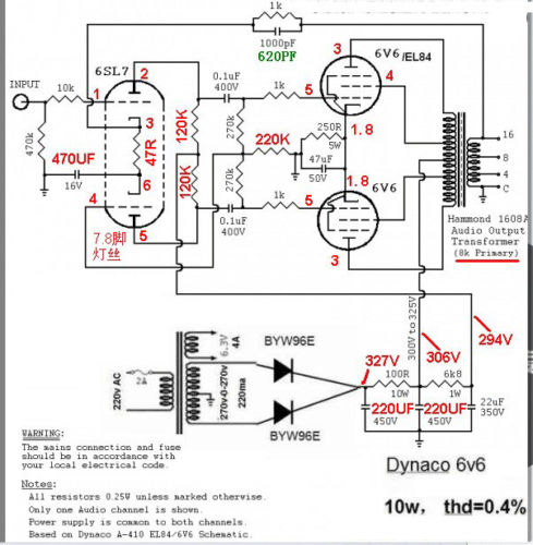

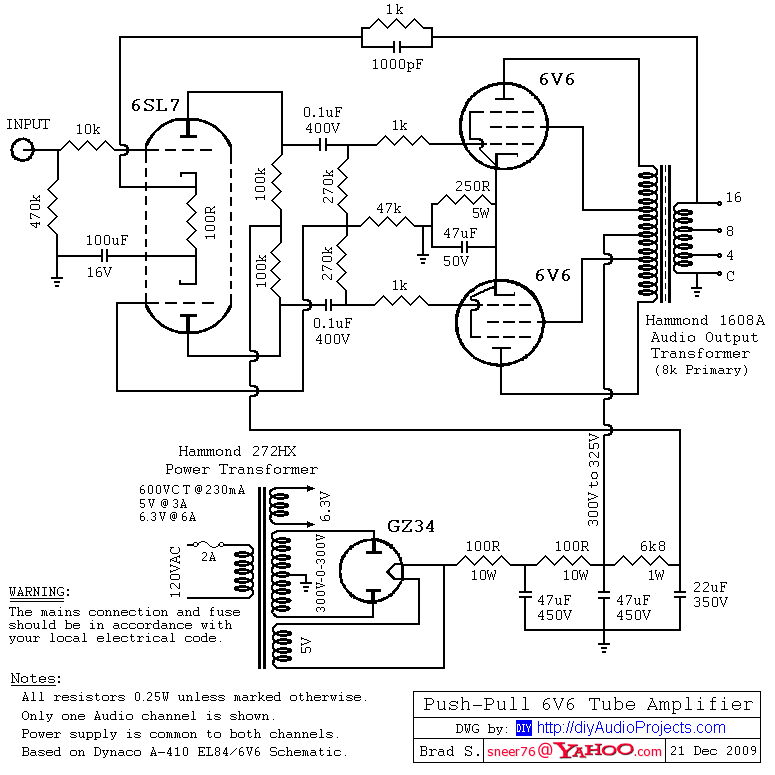

if anyone know how to check the bias off the 6sl7 in floating paraphase ,i would like to know too 😀
always for my learning ,if anyone can tell me why the original schematic have is modified and what is a consequence ?

I found some answers to my question but not all. Dynaco low Power Amp if someone wants to help me understand the changes from the original schema. I'm struggling a bit on the classic scheme but this one, I have trouble.
