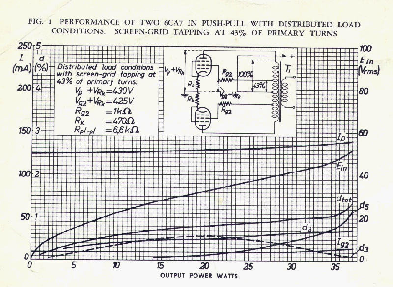

To be honest, the only reason I pick 300V is because I thought it might be safer and simpler for my first attempt at building a valve amp. But I guess bumping the plate voltage up wouldn't make the design anymore complicated.
Do you reckon 300V is not suitable for a EL34? If so what would be your plate voltage recommendation for the EL34 without adding too much complication and hazard to the design? My design is a pull-push bias in class A.
450V is the "standard" used by Mullard and Dynaco UL amps. If you are just starting out, it would be best to build a proven, well documented circuit as the two mentioned.

Maybe is good just to ad this graph for 2 x EL34 ( 6CA7) working UL in A1 class and supplied from 450VDC B+ , open loop characteristic of course without any GNFB applied .
What we can see is that Dtot is under 1% up to 30W output , where D2 dominate up to 12W , from that point D3 start to dominate up to around 22W , and than start to fall , where D2 takeover again up to max.out 37W but never exceed 0,8 % , finally D5 appear to be generated only from 14W up .
That's the sort of graph I like . Never seen d5 like that and it is an excellent way to get me to look. Must say my own designs have not asked it to appear. d3 opposite which I have seen. I use pre-distorion and make sure it is reliable by not asking too much. This must be why my amp sound so open. It is tempting to think pre-distortion is adding sugar. It isn't. It is just maths. UL is a similar thinking ( not the same). It is said d5 must never exceed - 70dB. d2- 30 dB. d3 must not be rejected. - 40dB would about right and - 50 db 4th.

"Mullard quote the power output for the EL34 tube as being the same for pentode and ultra-linear connection with 20% turns screen-taps, but for minimum distortion the screen-taps increase to 43% turns, which provides a power reduction of 15% (but distortion is halved)." - from Grimwood.
