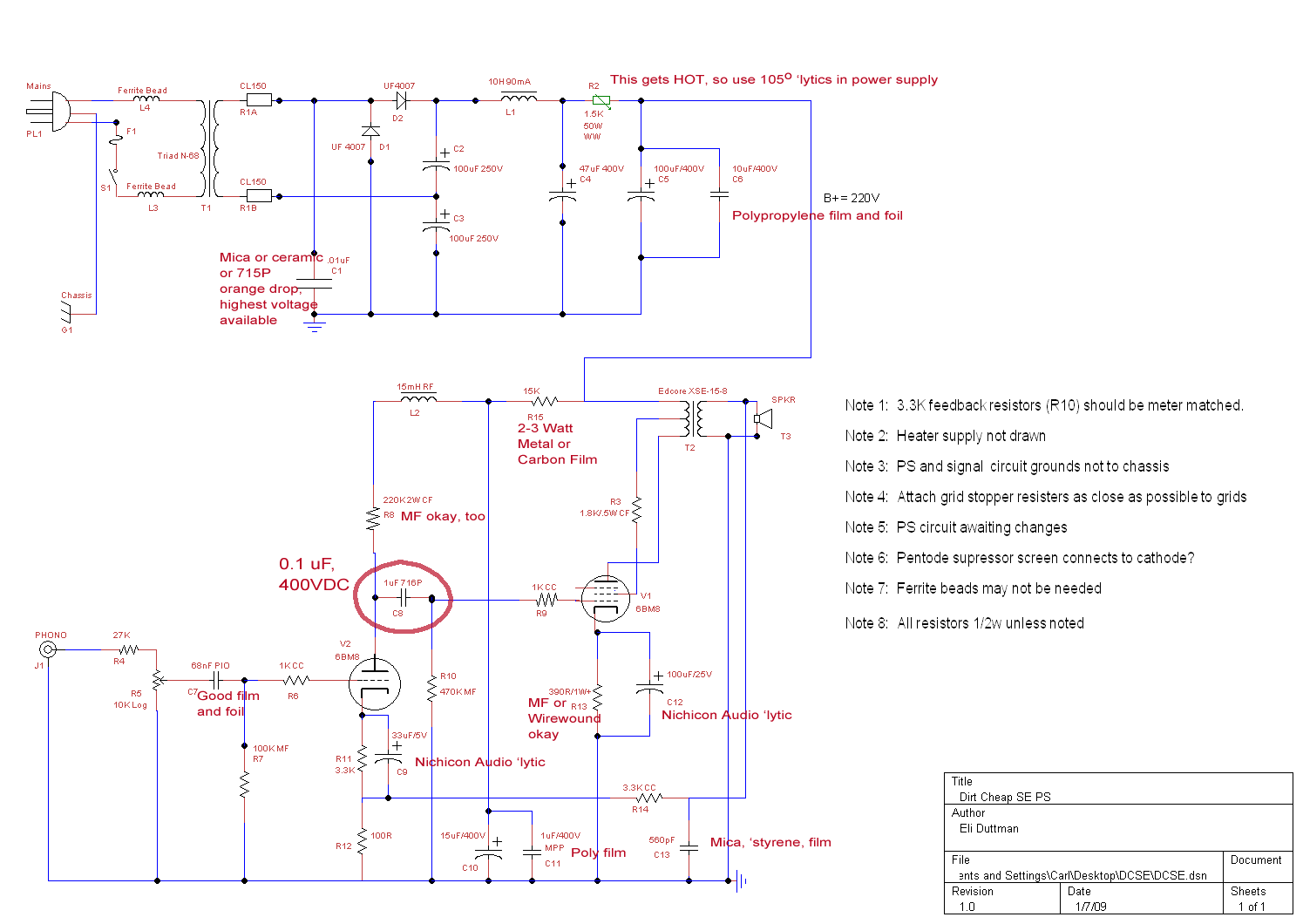

You don't have to use UL mode "finals", if you regulate g2 B+. Full pentode or UL, some form of loop NFB is (IMO) indicated. Even horn speakers need some damping factor help.
FWIW, I'd avoid the small signal tubes and go with the 6BM8. About 2 WPC is what you get. Better to have power that's not used than have a speaker wrecking amp that's clipping most of the time. I've taken the liberty of uploading a 6BM8 design that's based on something Mullard did.
A "weird" option would be 3X 3V4s running full pentode PSE. If you regulate g2 B+ at about 70 V., cranking the anode B+ voltage up to 110 V. should be safe enough, provided you watch the anode dissipation carefully. Each 3V4 requires its own "floating" filament supply of 2X alkaline "D" cells, which should last a reasonable amount of time. Also, "fixed" bias, with individual trim pots., is needed or "current hogging" will be a problem.

For the users of horns or other high efficiency speakers who build amplifiers with 700 or 900 miliWatts maximum power; would a small signal pentode running Ultra-Linear make a musical amplifier?
Why not just use a triode connected 6E5P ? That would hit your power requirements . Use a 3k-5k output transformer , 330 ohm grid stopper , 220k grid leak and 3 x schottky diodes in the cathode circuit for the entire power stage . I found the 6E5P to make a better sounding spud amp than the 6S45P , trouble is a slight lack of gain with my 97dB co-axes but should be fine with horns

I see several of those caps are electrolytic. Are any of them in a position where a change to film & foil, or metalized plastic would improve the sound?
