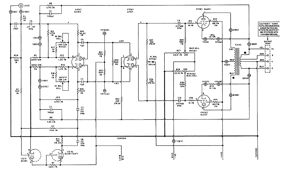

That amplifier claims a damping factor of 12.5 and a very low static dissipation. This can only mean a low idle current (near class B) and a lot of feedback.
the audio research D40? I assume its running AB2, because the quoted maximum clean output is 42W
The capacitor coupling between the driver and output stages will not allow going very far into class AB2 due to bias shift and recovery time issues. I don't think 42 watts is out of the question for 6L6GC's in AB1 with 400 volts across them. I have cranked far more than that. I have seen 100 watts from a pair in AB2 with only a little glow! The driver stage is a pair of cascaded LTP's. I have a similar circuit driving the same 6L6GC's that made 100 watts. Audio Research is famous for their symmetrical feedback loops and cathode feedback to the output stage from the OPT secondary. Trust me, you need a good OPT to do this. Try is with a Walmart grade transformer and the distortion will get worse, not better. The Plitron toroid OPT is the only one that I have that works in this manner.

A text clipping from Roger Modeski (sp?).......At the 700V B+ (yes, 700)
OK, this leaves me only one choice....turn the knob to the right! My big power supply only goes to 650 volts, but puts out 1.7 Amps, so if the tube blows up it's going to look really cool. I got to set up video for this one!
Seriously 700 volts at 15 mA of idle current (per tube) is a rather unusual operating point, but obviously it works for him. If the idle voltage on the plate is 700 volts the plate voltage can swing from near zero to almost 1400 volts. Cheap plastic tube sockets need not show up for work here!

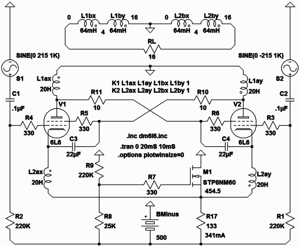

Its just a sim, and a rather strange one at that....
But it does hint as much as 60W clean sinewave
power might be possible in AB1 without violating
conservative spec sheet limits of a 6L6.
Its a faked McIntosh topology with twin OPTs.
I'm not sure where the extra power comes from
exactly... Could just be a mathematical error?
You need LTSpice and Duncan Amps 6L6 model.

Are the cross coupled plate to screen connections a form of negative feedback? It looks to me like it is, but does it certainly does not follow UL, nor Schade.
In triode mode, the plate and screen are locked together.
In Pentode(tetrode) mode, the screen is fixed and the plate can go above or below the screen, which has a strict limit on it's voltage.
In UL, the ratio of plate to screen voltage is fixed by the transformer tap , but the plate will not go below the screen unless the screen is also going below it's normal bias position so this is ok as well.
In the case above it is possible for the screen to go greatly positive wrt the plate (the full peak to peak plate swing value). Is this acceptable?
The cross coupled Plate to Screen connection is a pure Pentode mode.
There is however, 50% cathode nfeedback. Which is a form of Schade.
Screen strapped to own plate = Triode
Screen strapped to own 43% tap = 71.5% UL
Screen strapped to B+ = 50% UL
Screen strapped to opposite 43% tap = 28.5% UL
Screen strapped to opposite plate = Pentode
Remember what counts for "Screen" is really Screen minus the Cathode.
In both the McIntosh, the cross coupled, and the previously mentioned
D40 to some extent, the Cathodes of these designs are not sitting still.
So the Screen feedback maths may not be as you are accustomed.
