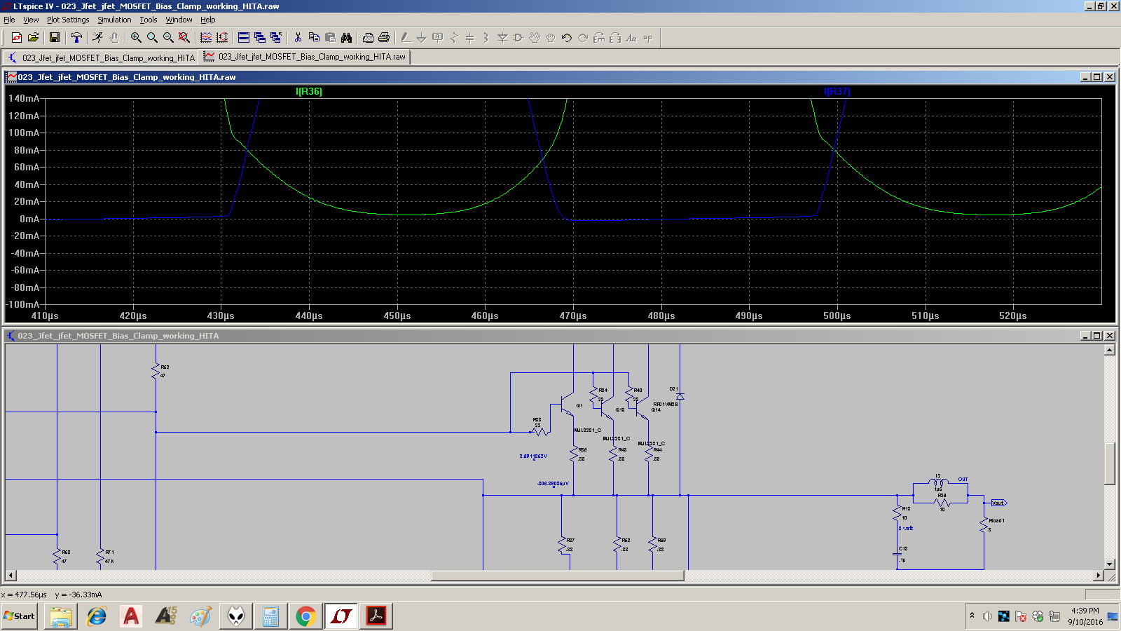

Attached is the schematic of my VHex+ amplifier.
Q5 is the CCS.
Iccs = (V(LED) - Vbe) / R15 = (1.8 - 0.65) / R15 = 1.15 / R15
Here there is one strange phenomenon happening with the ops switching from the sansui way. There is not clamping of the wave happening. Just check the sch.
It will not work this way.
Q27 must be PNP, Q28 - NPN.
Did the change but this time the bias is not increasing with various resistance values for bias increment.It will not work this way.

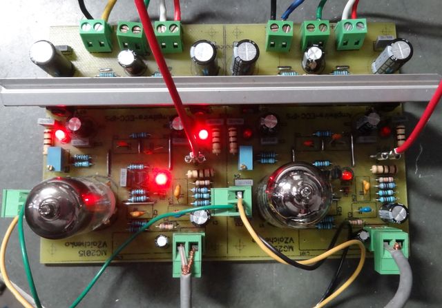

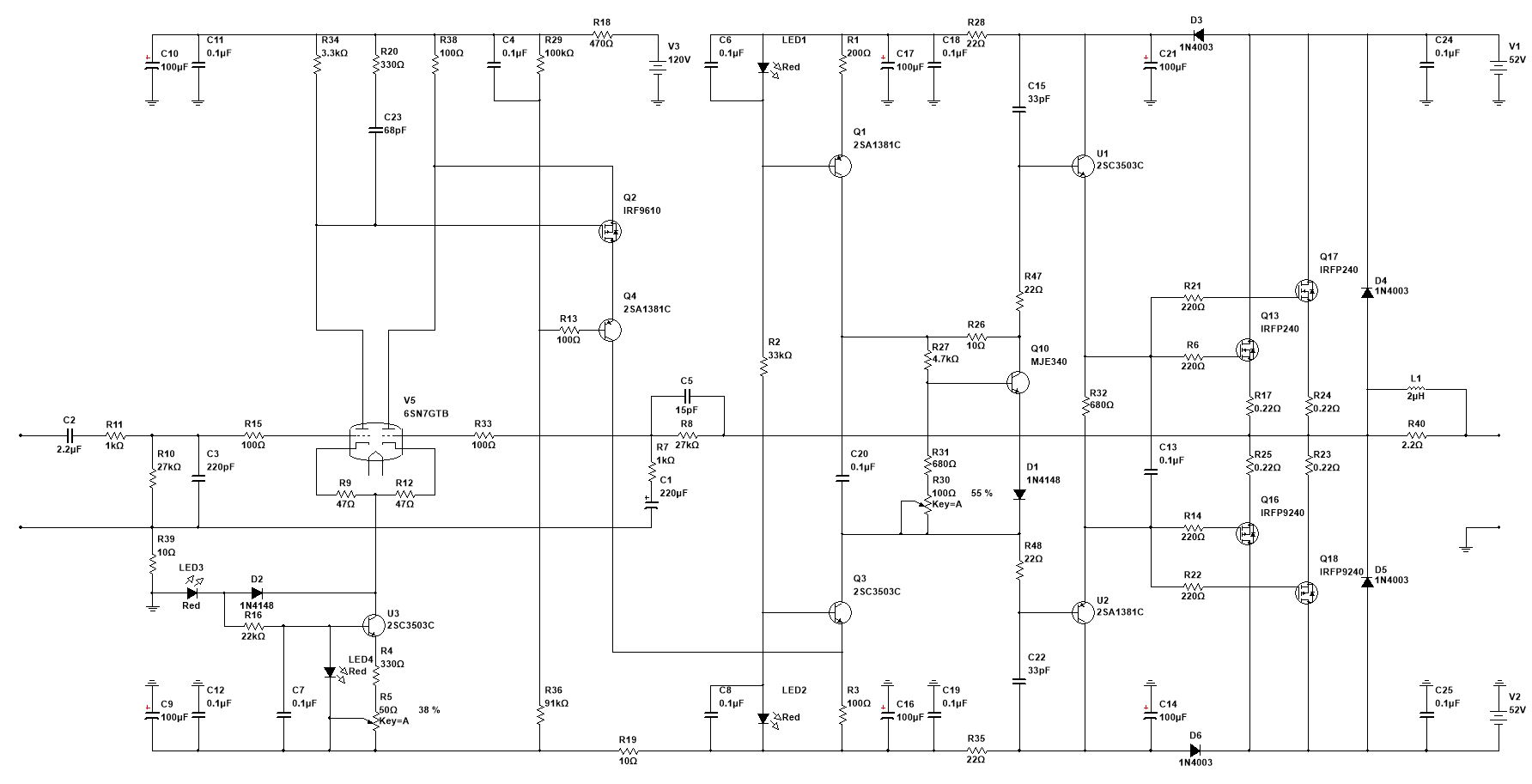

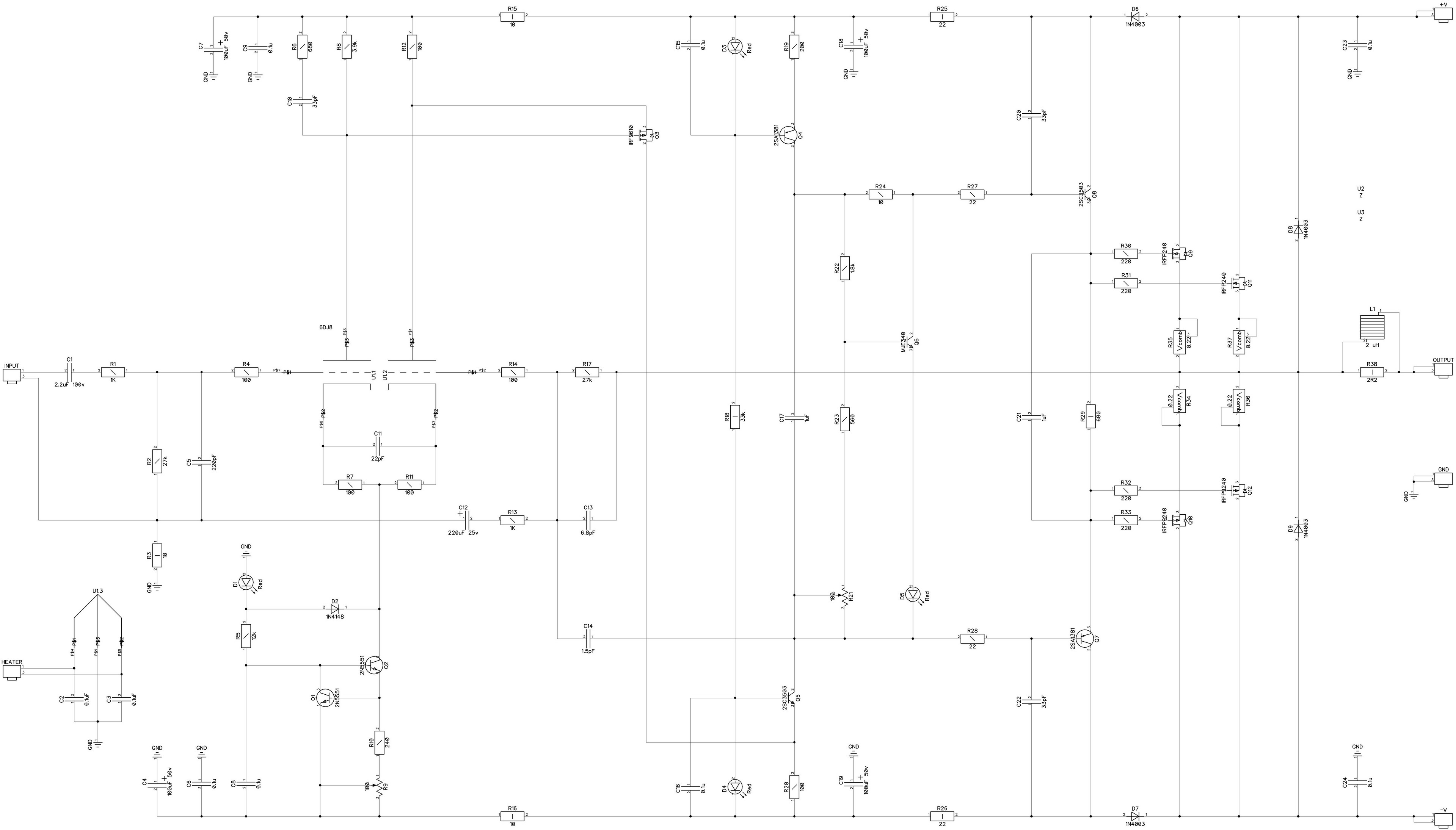

TubeHex+
Just for fun. Attached are 2 schematics I designed some time ago.
1-st one has got 6SN7 at the input.
2-nd one has got 6DG8.

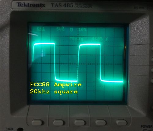

I personally prefer the variant with 6DG8 (from designer's point of view). This one is tested by Terry - see the square wave response pictures. 6SN7 version has never been live tested.
This is the part of a separate project - "Sons of VHex".
Rhythmsandy, if you've got enough energy, you can build both of them and see if there is some difference in their sonic signature. Not that difficult - project time frame depends on the builder's skills level. One evening exercise for Terry 😉
