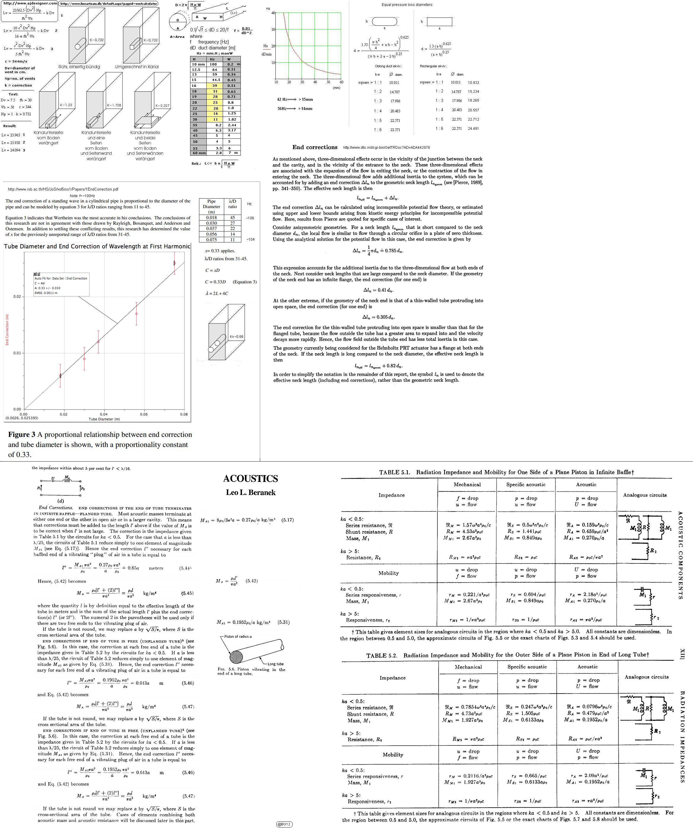

They don’t tune lower it seems you’ve only used the wrong end correction factor(s) as the triangular ports are not 'one end open and one end 'IB' terminating at the baffle .

Everything thing that I've seen says that as you move away from a round port, you end up with a lower tune than the equivalent round port. Regardless of end correction. Probably because the sound propagation isn't quite as linear. This also explains why if you model a folded horn in hornresp, with round sections, if you then build it with rectangular sections, you get a lower response than modeled.
Youre partly right on your observation but the valid end correction factor depends on Port diam. to lenght, wavelenght to diam., sound pressure and air velocity... baffle placement..speaker placement to room boundaries...and so on.
Dont know if this picture(my notes) can be of any help:
b🙂
PS: For PA I use the notes under 'End corrections' for a conventional simple port with aspect ratio <= 3:1 L/Diam. placed away from the corners and the sides.
the valid end correction factor depends on...
Dont know if...my notes...can be of any help
Bjorno, regarding end correction factors, I'm hoping your notes and expertise might be of some help to me regarding a slot port for an enclosure not flat on the floor, but placed on a stand.
In the interest of getting some clarification from you without distracting from the topic of this thread, I have sent you a PM. Please check your PMs, and thanks in advance for any help.
