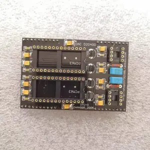

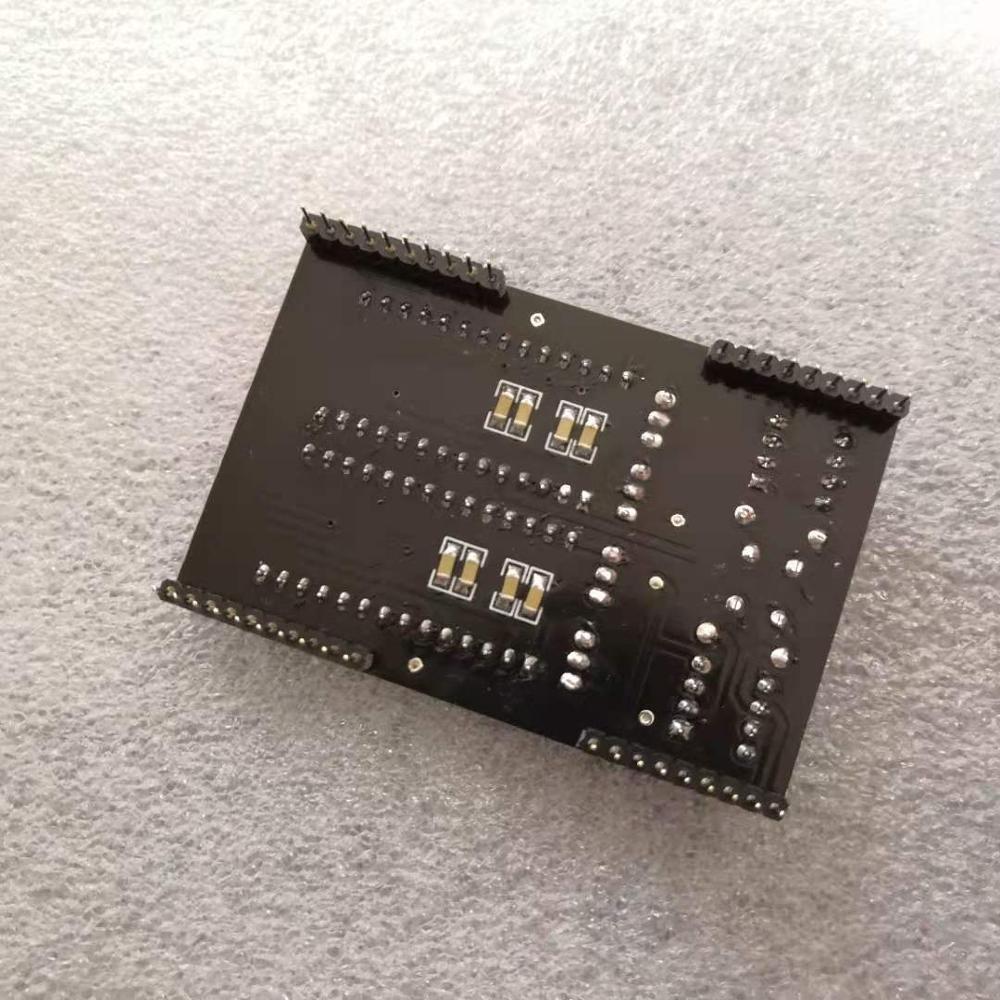

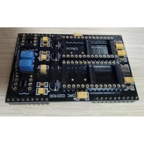

Did anyone tried the adapter from da20400 to pcm63 like in the added pictures
Thanks for any reply

It's vice versa, PCM63 to DA20400. I personally haven't, but i believe it would be far simpler to get ad1862 version, as it is a more readily available chip. What is sure, is that you shouldn't expect same sound coming from your devices, as these kind of adapters are there to bring the devices back to life. That being said both PCM63 and AD1862 are top of the multibit dac game, and it will sing nicely 🙂
Thanks for your reply
This adapter is available on aliexpress
Regarding to ad1862 I don't know, but i have in my stock 8 pieces of Pcm63p-KY
But my dac consist of da20400.
Since i love my dac and da20400 tend to fail when it's not cooled properly, it's good to know that I have replacement in a case of failure.
