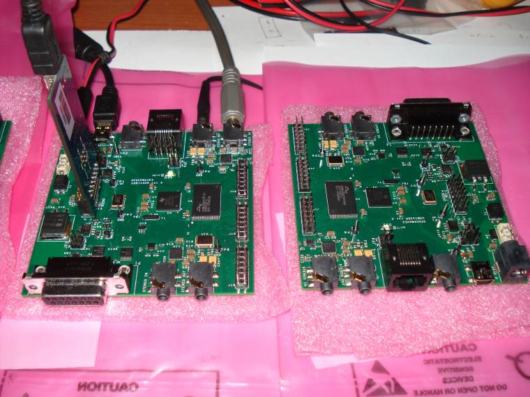

Hi guys and HNY,
There is a group buy that might interests you.
Although it is targeted to another group (radio amateurs, Software Defined Radio) it seems to me that you could benefit too.
The product is a USB to multichannel I2S board, it has a USB2.0 highspeed port on one side and can attach two codecs on the other side via I2S.
It provides concurrently (4+4) 4 mono input channels (2 stereo) and 4 mono output (2 stereo) channels streaming over USB, having all channels up to 192KHz sampling rate with 32 bit.
A necessity is the ASIO driver thats gets implemented right now, yet although not ready but more likely will be ready by the time the boards will arrive from the factory.
So, if you feel that this interests you, please pm me.
Best regards,
Christos
