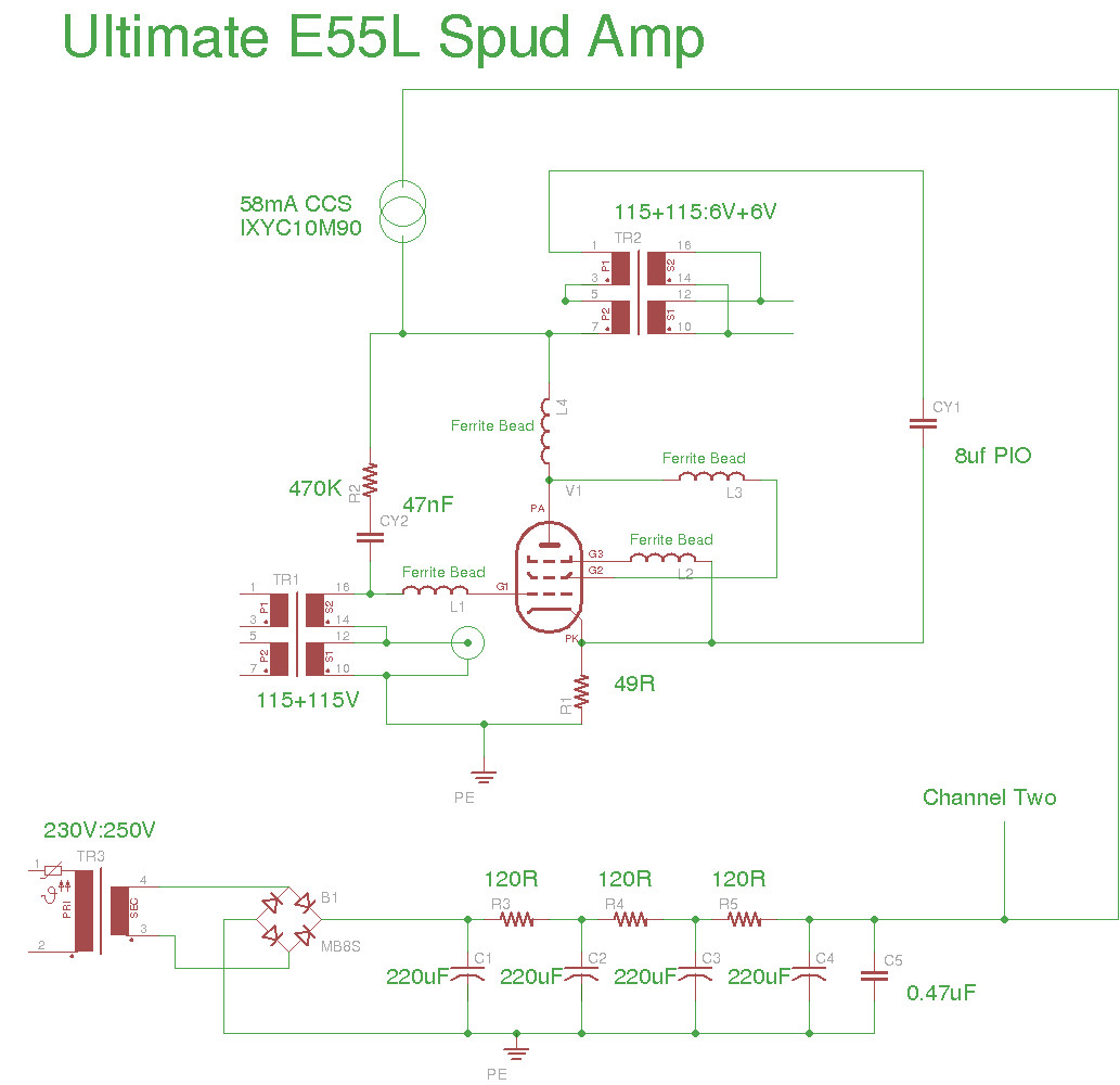

Just finished my Ultimate spud. I went with a E55L in the end.
Configuration is;
-Grid choke using a telema encapsulated power transformer, configured for a 2x step up
-E55L configured as a parafeed. All pins have ferrite beads and the g1-a connection is 1K. resistor bias is 39R unbypassed
-plate load is a IXYc10M90 with a B+ of 250V, output transformer is a Triad toroidal power transformer 240V:6V. Negative output of transformer is referenced to an 8uf vintage PIO cap and the negative of this is sent to the top of the cathode resistor.
-There is a 820K resistor from the anode to the top of the input transformer to introduce a small amount of plate to grid feedback (DC current is small enough that it doesn't appear to saturate the transformer).
It worked first time which is a miracle in itself. The feedback tightened up the bottom end a little. It sounds remarkable good, in fact its really not much different to my bigger PP amps.Haven't yet done any detailed listening yet.
Will lash up a schematic later and post it up.

So here is the schematic.
I made a few alterations to the amp as described initially.
-It wasn't placing enough voltage on the plate's of the E55L's so I increased the cathode resistor to 49R (anything from 49-63R would do just fine. which placed the anode at about 130V.
- I decided to see if I could replace the 1K screen resistor with a ferrite bead - I can and it remains nicely stable.
- I wasn't happy with the rather bloated sound of the amp with the 830K feedback resistor, so decided to replace it with a 470K and add the cap in to remove DC from the input transformer. Sounds a lot tighter now which is very good.
It has the right amount of gain for my system and is capable of driving my very sensitive vintage speakers into distortion.
Overall it fits the description of been the Ultimate Spud amp IMO😀

Autoformer ?
Thats how it works.
The transformer probably has about 100-150H inductance, which is very low when compared to some grid chokes with inductances out at 1000's H. Resonances is the main issue to consider here - and interwinding capacitance. However I am running this from a transformer coupled preamp with an output impedence down at 10's of ohms and no coupling cap. As such it seems to work just fine and isn't doing anything particularly nasty to the output that i can tell. The plate to grid feedback might be helping. Other people may feel far more comfortable using a conventional grid leak resistor which should work similarly well. I may even try it myself to get a comparison.
So the input choke's success is likely to be very dependent on the type of preamplifier driving it.
Its been running for a few days now - and I am finding it very likable. Its relaxed but with tight bass. I really am finding it difficult to tell much difference between my Class A PP DC coupled amps.
I think the main thing which can be taken from this - so far - is that ferrite beads work very well to stop these high gm pentode's/triodes from bursting into spontaneous oscillation and becoming AM transmitters which is a great result.
Shoog

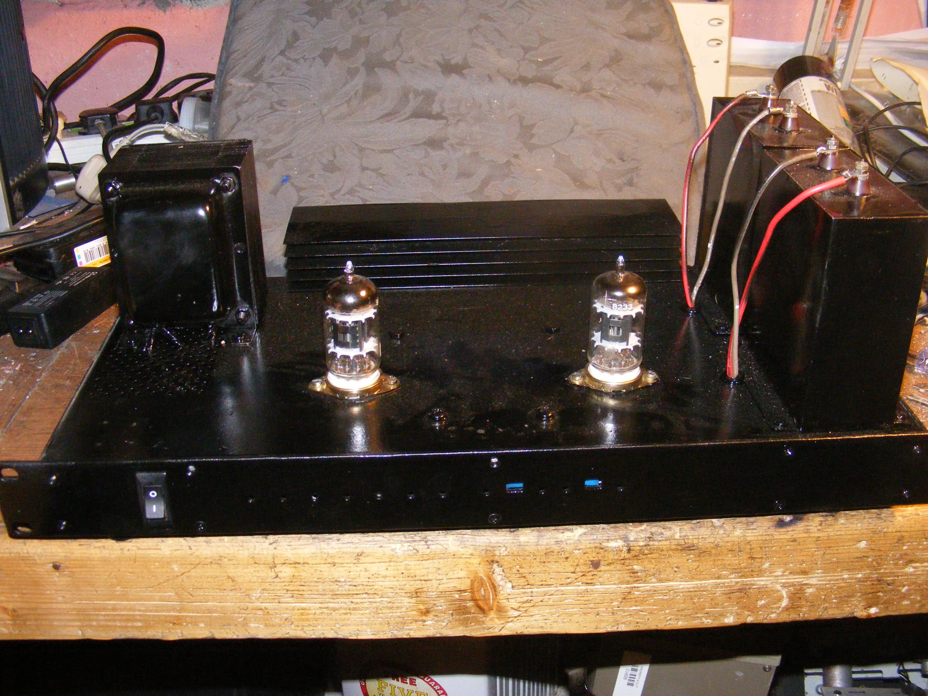

Here are a few pictures. Looks better in the flesh than the photo's imply. I will add some form of top cap for the big exposed capacitor terminals and I hope to add a wooden front panel.
I had a friend over yesterday to do a comparison between it and my latest PP amp. The PP amp was considered to have a fuller sound without giving up much detail. The Spud was leaner overall with a better top end. Overall the PP amp had it by a very small margin.
Since then I decided to reduce the feedback by changing the 470K resistor for a 640K resistor to see if the sound would fill out a little.

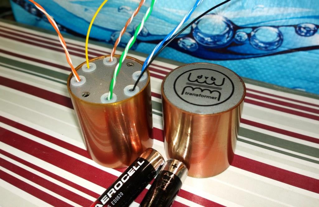

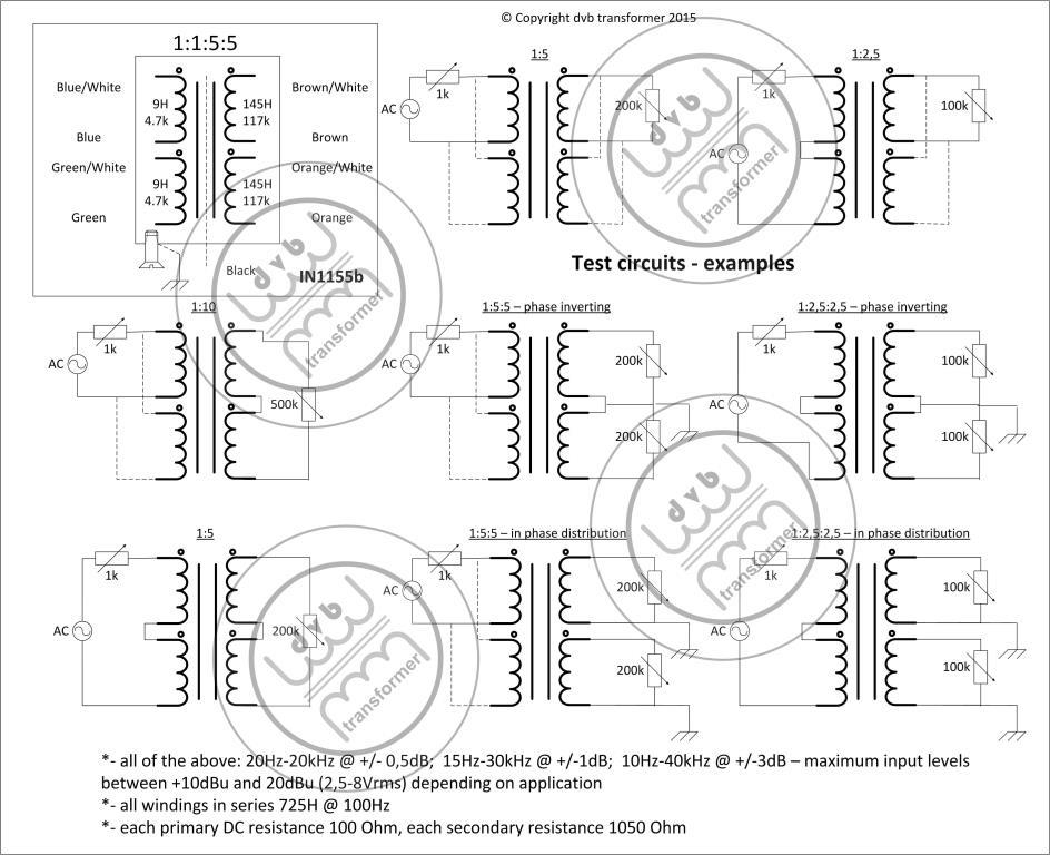

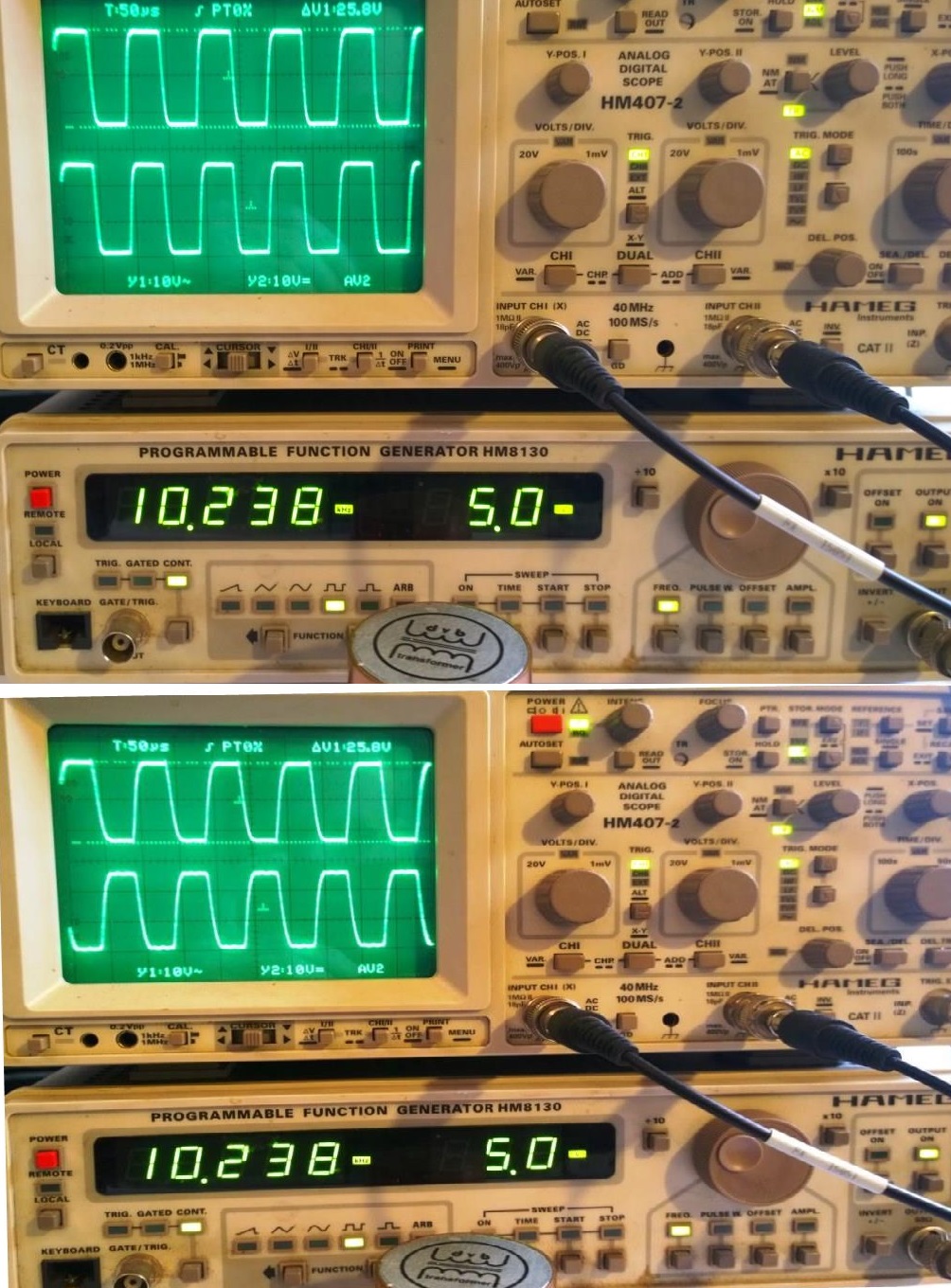

Hi there! Because the name of the thread is " Ultimate spud amp - any ideas?" please allow me to give you some ideas guys... ☺ This is a multifunctional input transformer that I have designed lately for SPUD apps but not limited... It drives directly from CD/DVD/smartphone/PC/DAT tubes like EL84/6BQ5/6P14P, 6L6GC/6P3S, EL34, etc, etc ... both in SE or PP configuration! ... this being the toughest challenge, to keep the high specs both for SE and PP and also to be able to deal with balanced/unbalanced sources... I have a full set of measurements if someone is interested. Cheers!
