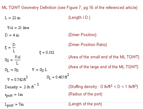

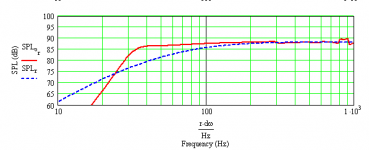

Dave Jones said:I played around with Martin's software for about 5 minutes and came up with the graph below.
Looks nice. What are the specs?
It's a bit late now to reply, but... I did indeed mistake the measurements on the Jordan website for inches instead of centimeters, habit you know - forgot I was looking at an English site.
Sorry 'bout that,
Chris
Sorry 'bout that,
Chris
Here they are. No warantee expressed or implied. I literally didn't take over 5 minutes to do this.
