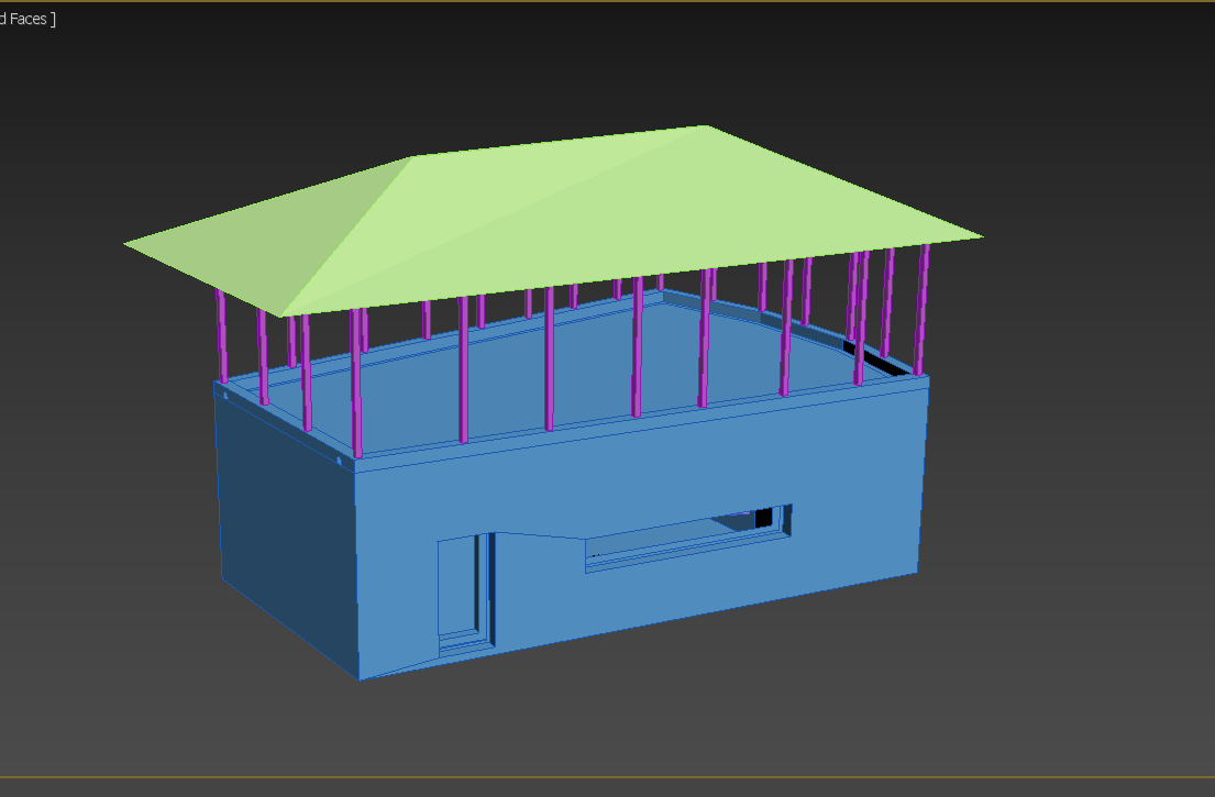

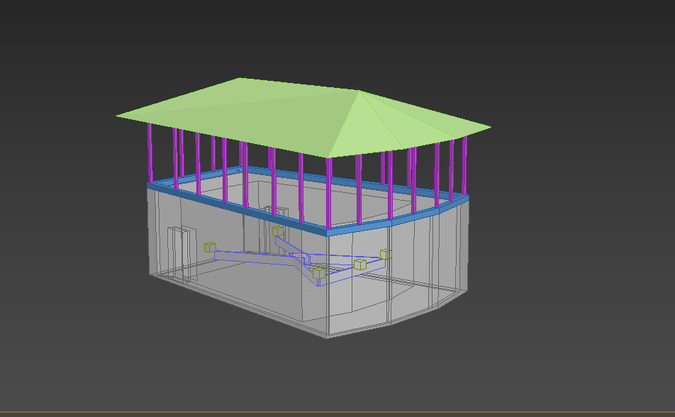

Just about the polar-opposite.Seems some kind of LEDE setup, isn't it? I think studio design has evolved since then.
The LEDE approach was for the front wall to "dead" and the rear wall to be "live". (I'm pretty much suggesting the inverse of that.)
This was done for mixing where most consoles were relatively close to the front of the room and their mixing speakers were even closer to the front wall - not wanting that short-delay reflection to disturb center imaging (..or really any point of imaging between the speakers). The rear end was to compensate for the overly "dead" sound that the front wall generated. Later some idiots tried to compare that "live end" to envelopment as found in a concert hall saying that the late reflections were "good" (but in point of fact those "late" reflections are almost never late enough, given the small room condition, to actually be "envelopment").
LEDE can still be useful if you have to put your loudspeakers very close to the front wall (notably with Home Theater).
Note that what I've suggested isn't like that at all: with the speakers at about 65% of the way into the room from the front wall (assuming a larger room) there should be many feet from the front wall to those speakers (more than 12 feet). This compensates for the near-reflection (loudness) problem at higher freq.s from the front wall and allows the speakers to generate considerable depth of field (if they are capable of that and the recording is as well). Moreover the front wall and all the walls floors and ceiling should be reflective up to just slightly beyond the plain of the front of the loudspeakers. This allows for easy to ignore-(mentally) specular reflections.
Much beyond the loudspeakers however the walls, floor, and ceiling should be "dead" particularly to reduce near wall/ceiling/floor reflections. You don't want it all the way up to the loudspeakers themselves (their *frontal plane), because you want some of those side-wall reflections (in particular) to generate some added spl slightly left of left speaker and right of right speaker to marginally help with lateral expansion (..this is in respect to head-shading with HRTFs/head related transfer functions). In this respect the listener should also be about 8 feet from the loudspeakers (..again, head-shading and lateral signal and pressure differences), and the speakers about 8 feet apart from each other.
*basically start into the rear "dead end" about 2 feet in front of the loudspeakers (at least laterally/side-walls, sometimes it's advantageous to "push" either the floor or the ceiling absorption closer to the loudspeakers).

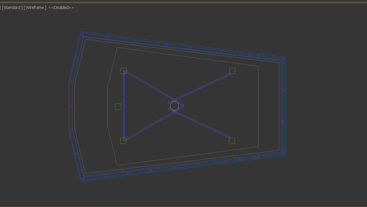

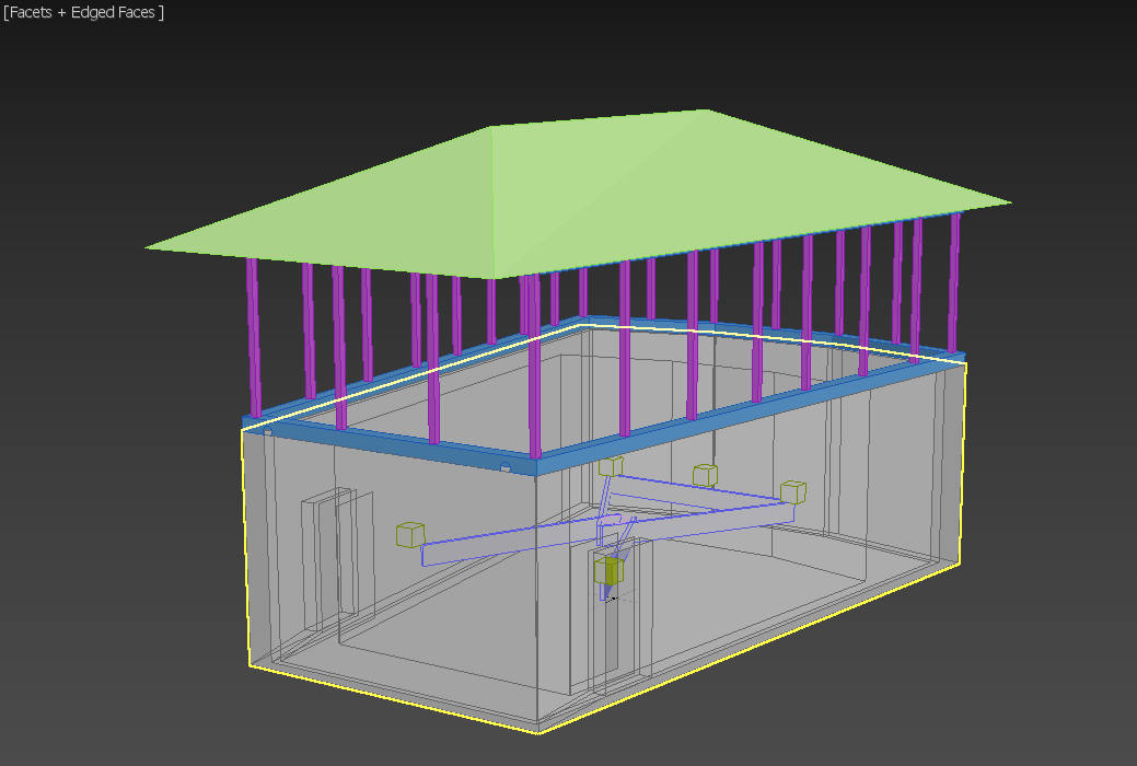

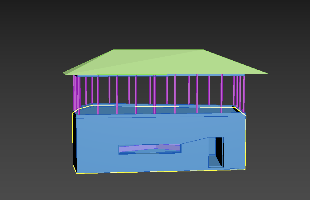

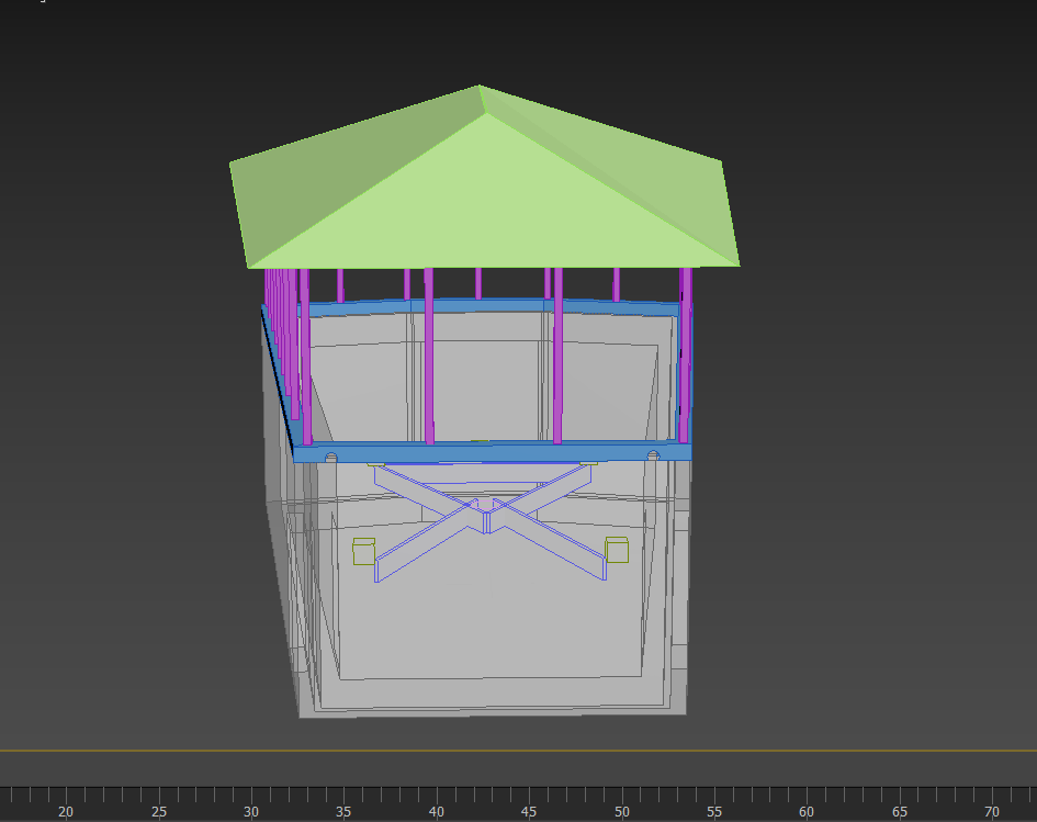

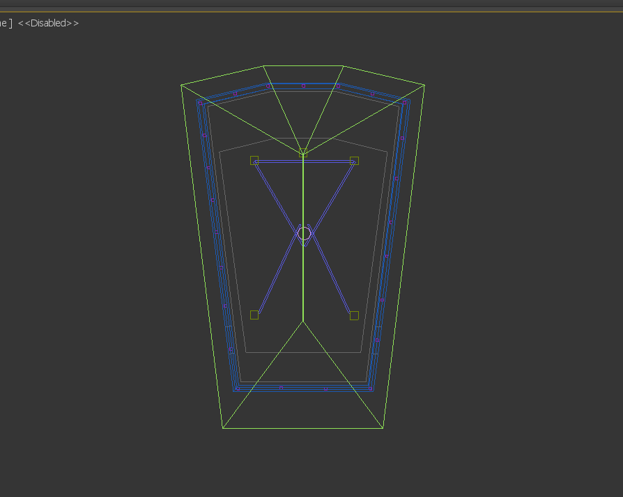

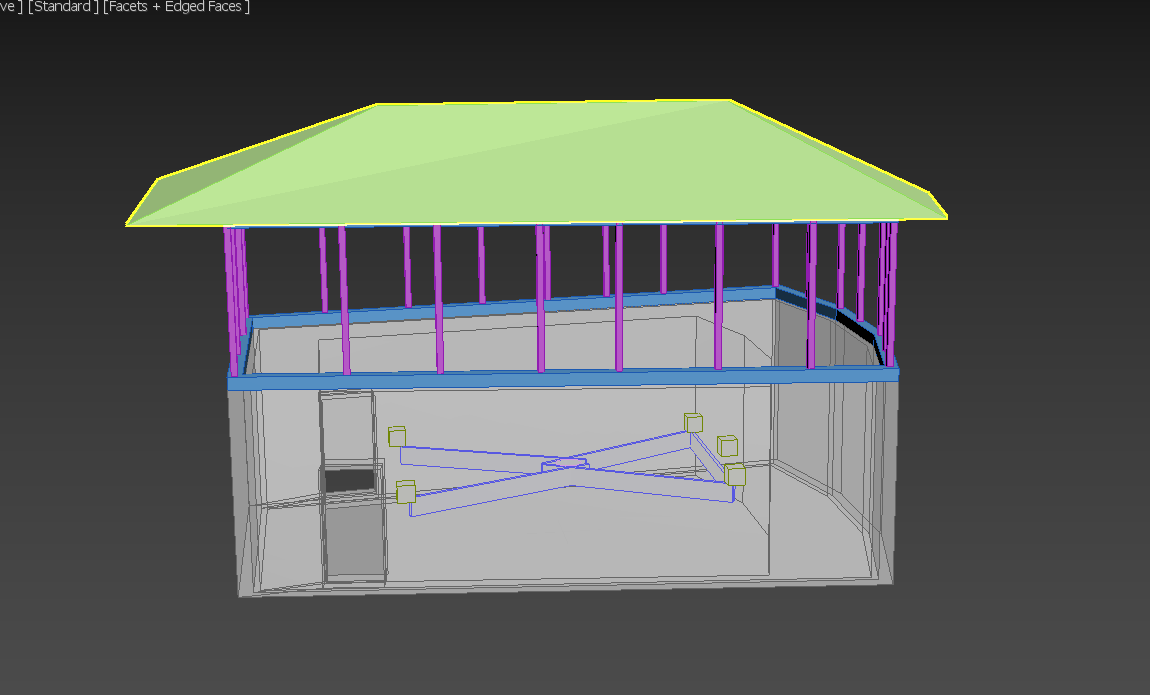

..looks like a multi-channel setup.
This brings up the question: is this going to be primarily for multi-channel work?
The non-parallel walls and the front (along with the other sides) acoustic bass trap is interesting.😎 Note however that unless there is sufficient and properly spaced rockwool/mineral wool absorbers (that's air-space between the absorbers) - that lower density fiber works better to absorb low freq.s as thickness increases. Ironically here cheaper fiberglass batting rolls do a better job than rockwool. Just a foot in thickness with about 25lb material can do a better job than higher weight material like rockwool (which is often nearing 65lb); as you go thicker in material its weight should also go down some to achieve the best result.
As Storm Mastering is commenting on (Reverberation Time): as a guess it looks well designed for low freq. decay and reduced mode activity (and that is something that needs to be modeled).
