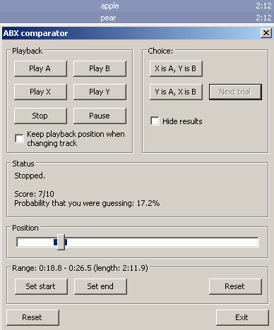

It really does require a relaxed form of concentration to hear differences between pear and apple.
It isn't clicks and pops of foobar ABX. Last night I did trials using fixed starting point, using section with sax line with lots of sustained notes and runs.
A certain warm up period seemed necessary, then I got a good run:
As testing continued I became habituated to both sounds, and found that I needed to pause for >30 seconds to relax before doing next trial, and also found that if I couldn't clearly tell difference in <20 seconds that I tended to guess, but if I paused and waited to relax that I could identify differences.
I continued above trial and got to here:
I paused for a few minutes, but my partner came home, and I got distracted.

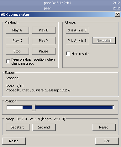

I just applied 2.4Hz Butterworth filter to pear three times to emulate DA>AD process used to generate apple.
With foobar ABX this is my 10 trial score:
I've uploaded the modified pear file to a drop box with link here for anybody who would like to give it a whirl.
Now I will create files with cascaded Butterworth filterings as normal versions and linear phase versions with identical frequency response and see how they compare.

Perfect! It is really not easy to get a repeatable result in case the sound difference is small and it of course depend on our momentary condition, ability to be relaxed when listening etc.

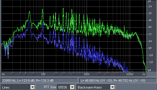

Look at diff file of pear v with the 3x cascaded Butterworth filtering:
Wide separation at high frequencies show that these all match very well. Differences accumulate at low frequencies with group delay. Listening occurs with exact same electronics, yet are relatively easy to tell apart with foobar ABX.

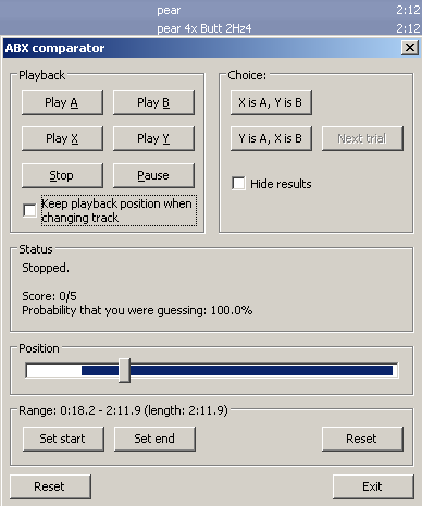

I've done foobar ABX of pear with 4x cascaded Butterworth filter. It was relatively easy to tell them apart compared to differentiating pear with 3x cascaded Butterworth filter.
To make it a little different, does 100 percent guessing result mean that I'm a good guesser?
After a break I will try ABX with linear phase filter.

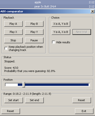

Comparison of pear v pear with 3x cascaded 2.4Hz Butterworth filter is half of equation with a comparison of apple v pear with 3x cascaded 2.4Hz Butterworth filter.
Such filtering removes high pass filtering of signal as possible difference that is discriminator. It leaves noise and other distortions as possible discriminating factors.
Here is my first go at apple v pear with 3x cascaded Butterworth filter:
4 out of 10 is rough territory. It could be expectation bias, or fatigue.
I encourage others to try these comparisons.

I don't understand what you mean with "rough" territory.4 out of 10 is rough territory.
Theoretically, 5/10 is PURE guessing. Knowing a lot of things including how random numbers are generated in computer I would propose 6/10 as the mid value of pure guessing.

Comparisons of pear, apple, and my modified pear files indicate that group delay is primary audible feature.
1) pear v apple shows that group delay or other feature make discrimination possible.
2) pear v pear with group delay eliminates noise and other features as source of discrimination.
3) apple v pear with added group delay cannot (thus far) be discriminated, indicating noise and distortion of apple's DA>AD process is not discriminating feature.
With 4 out of 10 result is more random v negative correlation that would form with 3 out of 10 result. Ability to discriminate in case 3) leaves possibility of discriminating against unintended effects of electronics. Not being able to discriminate in case 3) suggests that electronics in apple path are blameless, beyond adding readily identifiable high pass filter. This filtering can be completely avoided with DC coupled circuits, or if trying to compare different components, such as op amps, that comparisons must be done using circuits that have highly matched pass band characteristic.
