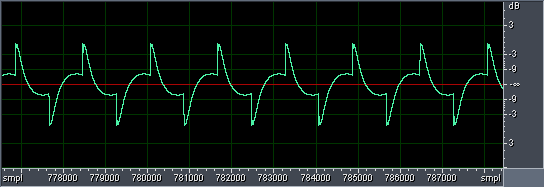

Do you expect everything else in the recording and playback chain, except for this CR input coupling 1st order HP, was DC coupled and able to transfer 0Hz, i.e. DC signal? I guess you do not. Please check headphone 30Hz square response. I am sure you also know how speaker square response look like. Your comments are misleading. There is nothing like square waveforms in music signals. There is no microphone/preamp system that would capture DC and there is no way how to produce positive or negative DC air pressure in the non-sealed environment.
Yes, what you've got pictured is quite typical;
Here is 30Hz square wave response of $10 ear buds I used:

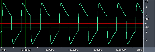

For comparison here is Sennheiser HD650 response for 30Hz square wave:
