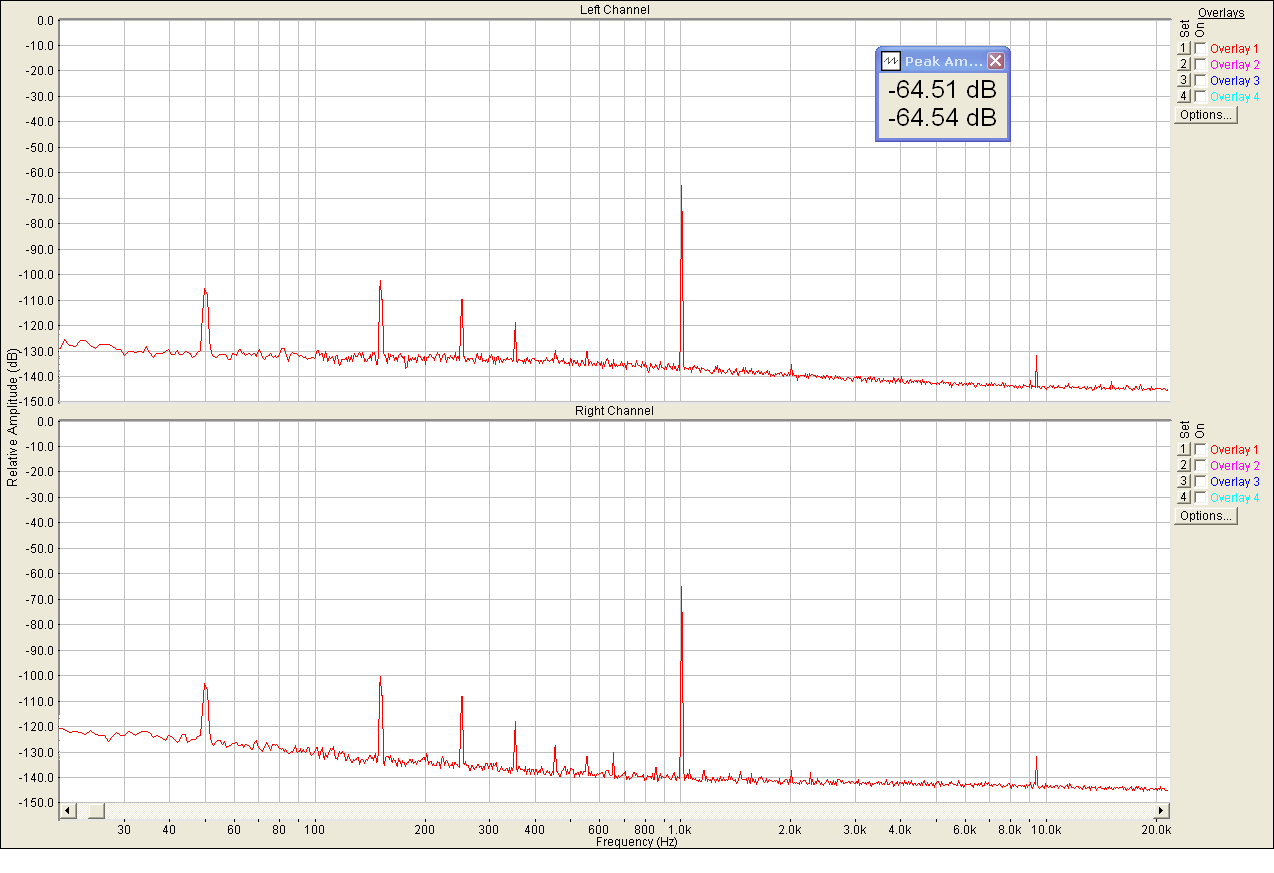

Speaking about cables, groundloops, clean humfree files etc., see the effect of 12V transformer table light lamp turned off and on, just magnetic coupling to link cable groundloop. Speaking about -125dB yesterday, right? 😀

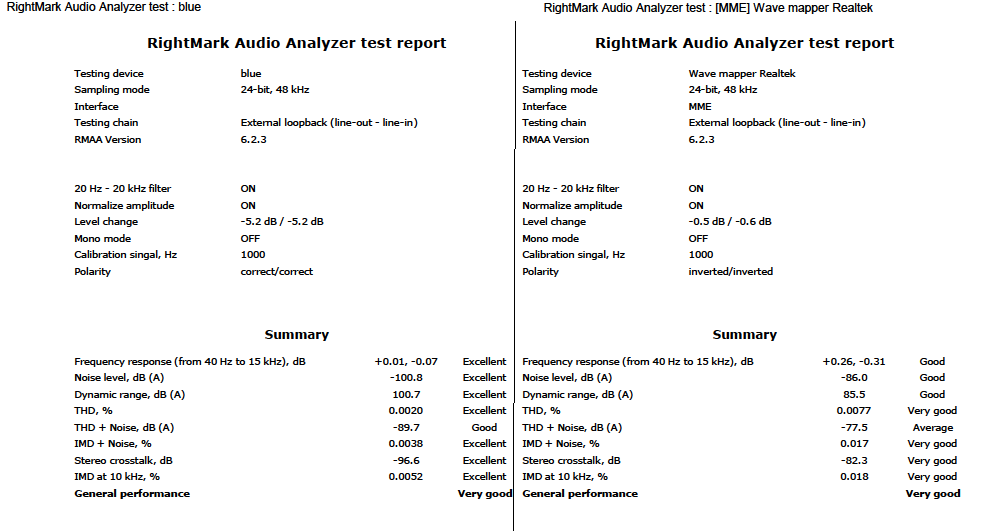

Thank you. This might say a lot. Remember I have already posted full set of the Realtek measurements.
Now, for short, see Realtek compared to the 'blue'. Usable dynamic range of the Realtek is about 15 dB worse than that of the blue. And blue is set to -5dB, so in fact the difference in dynamic range of both is 20 dB. That's a lot.

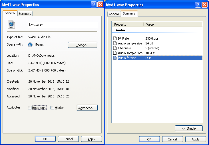

Tried other media players, still the same problem.
Absolutely correct, PCM 48kHz/24bit. You should hear something.

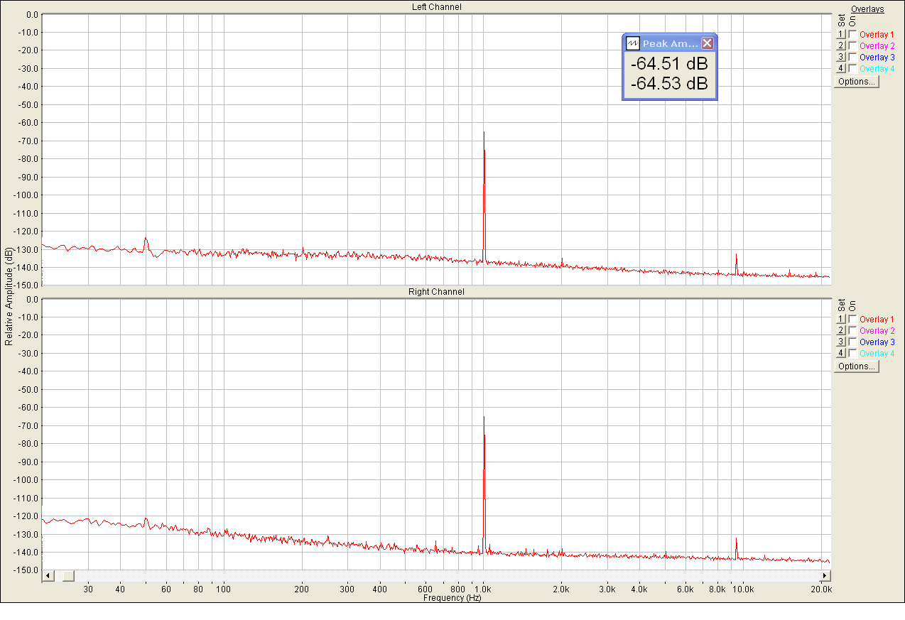

With 2 files recorded through the same chain, just 5 days between the 2 recordings, Diffmaker is able to make a great job (even though the files are not sampled simultaneously), resulting in no audible sound. So this is my 'repeatability'.
(Remark, this spectrum has nothing in common with the 'orange' and 'kiwi' sound files).
