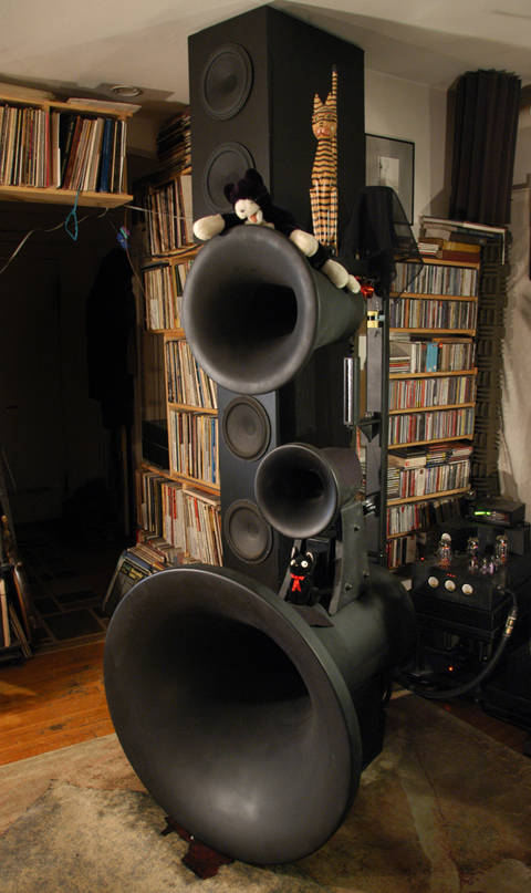

Hi Scott. Good thought.
But, its covered.
The modal range of standing waves is covered by the sub only.
Cause what happens then, around 100Hz and up, is not a standing wave, but early intense reflections between speaker<->first wall OR narrow walls (floor<->cealing 3 meters only)
Dips cant be FIRed, peaks are too slim. So what happens when u put the speaker on the wall? One is gone. Rooms got 6 walls.
So I put the speaker into the corner, 3 are gone, response gets lot better -> use a corner horn 🙂
Still not perfect. Cealing is the first n earliest. Lets stack more Khorns then, vertically up. Cylinderwave, cealing gone, only 2 left.
Well now it gets dramatically better. Lets fill the cealing with foam, let the other 2 walls come very late as theyre on the other end of the room, hit the foam on the front part of the room, and gone. Tiny decay, short n weak, no modes left.
Thats why i run the Khorns that unusual high. Which requires some mods in the foldings and phaseplug. Cause K's often get very dirty above 200, some even >100.

This is a pure off-axis problem. Not relevant for the listening position.
Hmm. Different people hear differently, but I can't agree, not even a little with that statement. Turn any speaker away from you in any practical domestic room that is as damped as you can -- you will still hear the speaker playing almost as loudly, subjectively, as if it were pointed toward you. Off-axis is always a problem in any listening room (and anechoic chambers don't sound very good or comfortable).
Also, people move their heads quite bit while listening (at least I do) and perception of the source location of a sound and its reflections can be very sensitive. As far as I know, the only way to work around that is with a coaxial arrangement that has (at most) smoothly varying directivity. You can't just consider only the acoustic pressure sources make directly at the listening seat. I suspect that with the system you propose that it wouldn't be hard for a blindfolded listener to point with some accuracy at the location of each of all those drivers with their different positions and shifted radiation patterns.
Well well. Youre saying the right things. Ive been thinking how to solve this.
I cant deny, itll be challenging to compeed with the focus and lobing of a constant directivity point source.
1. what i meant, in a high reflective surrounding the off axis sound is important for the on-axis lis.pos. as well. sure. But in a anechoic chamber it would be completely irrelevant.
But the an. chamber sounds inconvinient. As you say.
So I made a live end - dead end installation.
In my case, that would limit the vert./hor. dispersion to reflective surfaces from normally +-180° down to +-about 50° around the axis. Thats a lot less to focus on for optimisation.
It didnt have the "in head" localization like the an.chamber anymore, but the stage lacks depth and gets very close. Thats where i have small 1x1 meter diffuser behind each main with the slot tweeter making the diffuse stage for depth. And that one's completely steerable on its own, in level + time + response. Like a "shape your reflection" toy.

Im not a dreamer 🙂 Heres my single K nearfield in mouth
no gate, no smoothing, FIR filter applied (!), after first mods (tbc)

about the vertical offset issue....
So. I made a test with two mini speakers, both fullrange, stereo-triangle very small.
1. stereo horizontal triangle 30cm, fullrange: localization in the middle. Of course. No surprise 🙂
2. same as (1) but vertical. I noticed the phantom source gets sharper.
3. same as (1) but changing the distance. The closer i get (10cm) the blurrier it gets, the further away the sharper the center
4. Horizontal triangle 30cm, left speaker low / right high-passed.
Perception is kind of weird. A bit diffuse. But mostly it comes from the right side.
5. like (4) but vertical, gets a lot sharper. less blurr. closer worse, further (1 meter) its like a point source sharp on the tweeter.
My conclusion, nothing new but nice to see live, vertical offset is half that bad, and especially on long distance. The brain cant catch the fake. The focus should be on high freq. drivers (getting them close).
I heard big horns like Avantgarde etc which have small issues with precise localization vertically (jumping up n down). Thats too much then.
But smaller ones, like the usual standing speaker with 1 meter overall height of sources, but half meter for mid-high, are fine. We all know such.
But heres an interesting speaker i heard, huge offset, BUT the sounds all sharp centered on the tweeter:
And why is that?
Instead of designing bottom up - low mid high...
They designed low high mid. In principle. More relevant there with so many XO.
Well if u think of having the center between low-mid where the tweeter is...
Where else normally you build bottom up the center BELOW the tweeter...
Inspired me 🙂
So, heres a proportional correct drawing of the components in place. 1 meter width, >2m high:
The bottom horn is still to be built. Others are resting in the basement.
Tweeter is about 1 meter heigh from the floor.
You see, the mid-high spectrum is mostly within a 70cm range. Not that bad.

Ill try. For sure. And then modify. First thoughts are direction to head to, then see where to optimize.
Whats the alternative? Downgrading to standard setup? What revolution u can expect then? 🙂
I can still take 1 driver out, move around, use steep NevilleThiele filter, etc.
Unless you have a stecific proposal ??
Ive been to Romy's side. Interesting stuff. I share lot of his opinions, not all.
Discovered his nice explanation why my resonant chambers (top horn on the drawing) sounds so nice but measures horrible.
But I'm also more familiar with modern stuff such as measuring and the correct psycho-acoustic interpretation of such (its long path to walk). Also correct use of FIR filter. Stressing correct. Because u can do a lot of things wrong being naive.
Once u understand that, theres no way back to analogue crossover or EQ.
Same as understanding non-linear distortion, theres no way back from multi-way horns.
Reg. the pilgrimage. I had several inspirations of speakers that are absolute "wow" to hear live, and i can only recommend to listen to:
Klipsch horn for its fundamentals
Vox Olympian - for its resonant chamber and tweeters
Fostex Laboratory Monitors - for its depth of stage and tweeters
Electrostatics for understanding how to use rear-reflection for advantage (stage depth)
Western Electric Mirrophonic - for the joy and ease
So. im trying to pick the best of each, and merge it with new ideas.
Lets see. Still hoping someone will say "better make this that way because..." 🙂
