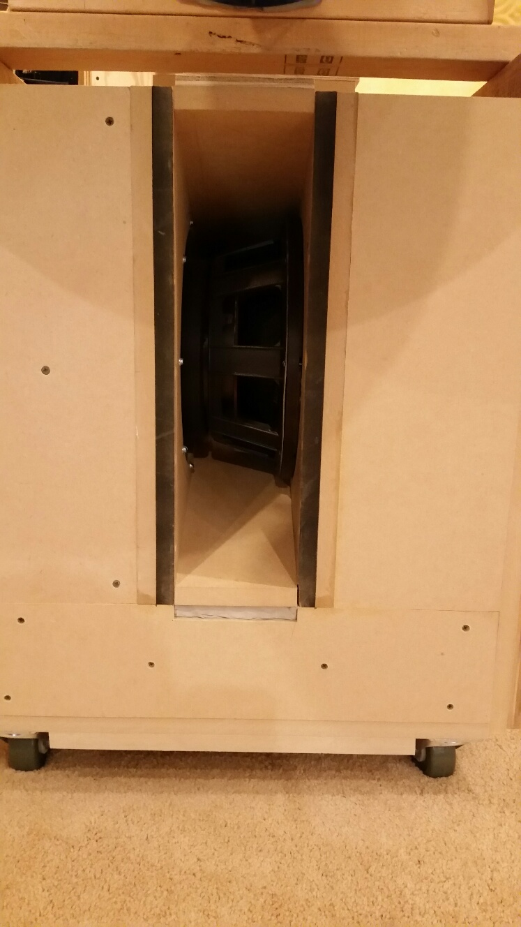

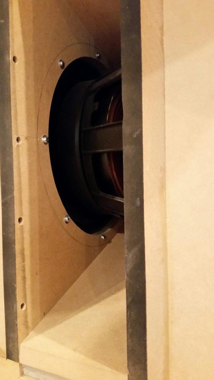

PMA! has an excellent thread on a horn speaker using dipole woofers. Nelson Pass also published a note on slot loaded dipole woofers. This "stack-them-up" woofer construction might fit your design goals.
My DIY Horn setup
S.L.O.B.S.
Slot Loaded Open Baffle Subwoofer
This dipole cabinet generates a high impact bass wave launch with a focused air pressure energy that travels several feet before diffusing. In a small room, the slot is aimed at the listener in an effort to increase the perceived dynamic impact. This directivity control is a good match to horn or dipole polar pattern. At modest SPL levels, the slot's focused energy wave is linear over a wide frequency range. The slot dimensions are smaller than the crossover wavelength to avoid resonances. JBL measures a directivity index DI = 13 on their dual 15" slot loaded woofers.
Does not have to be di-pole in order to work. As a matter of fact, I think that an even greater pressure wave is created when there is no wrap around loss.
Hi. Do you have experience with this type of OB? I find the pressurisation of a sealed box in my small room uncomfortable (one of the reasons I prefer OB speakers). I presume a SLOB could be a good compromise for the reasons you state?
