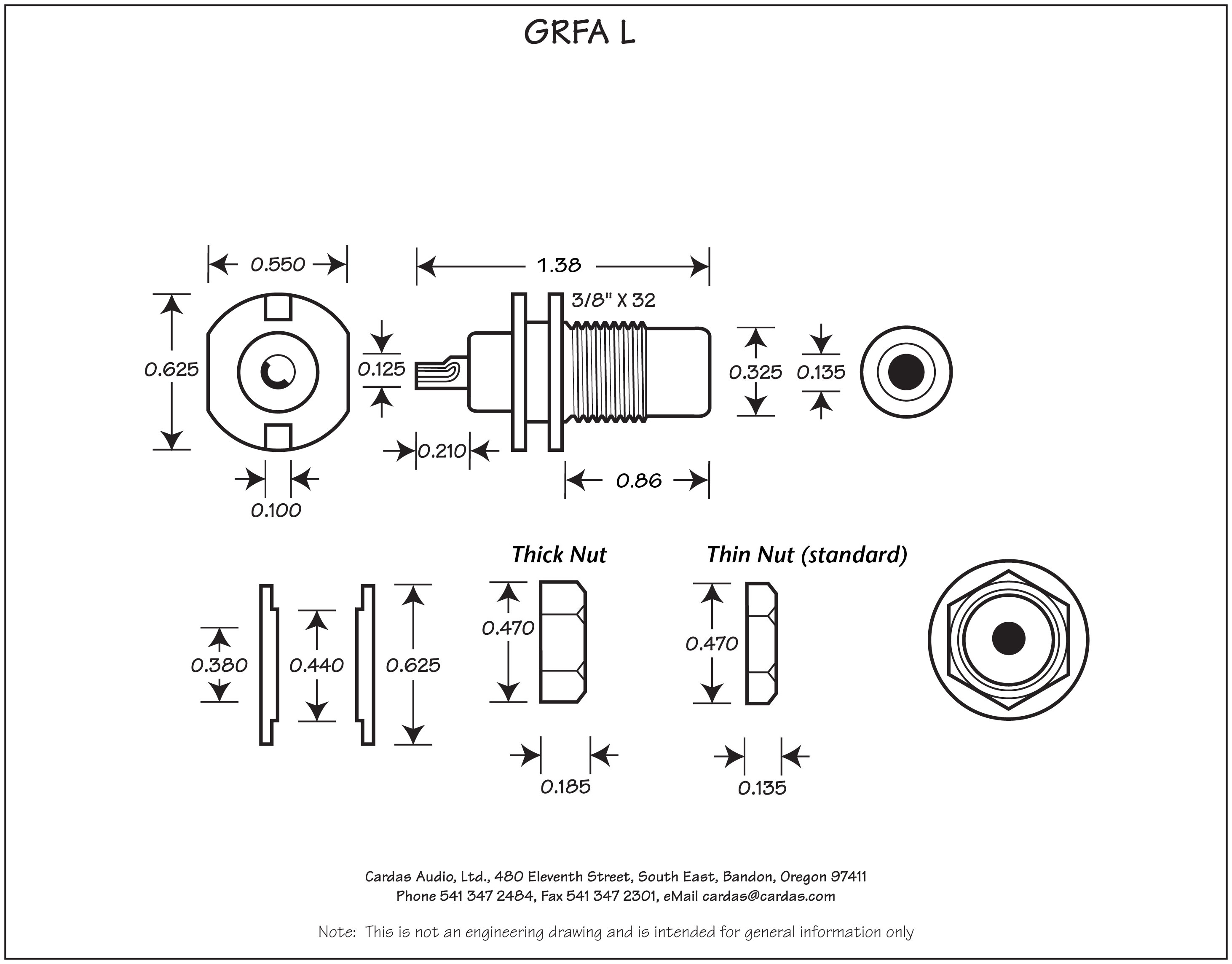

Cardas Drawing - RCA
Diameter of Isolating washer insert is 0.44 inch
0.44 inches = 11.176 mm
I have allowed a cutout hole of 11.5 mm diameter for adequate clearance
Any objections to that, please raise now.
Good work pico as usual. I will go with the pilot hole option.
For those interested, can you post the Cardas part numbers your cutouts refer to for the RCA inputs and speaker binding posts, thanks.
Also your recommended XLR connector as well.

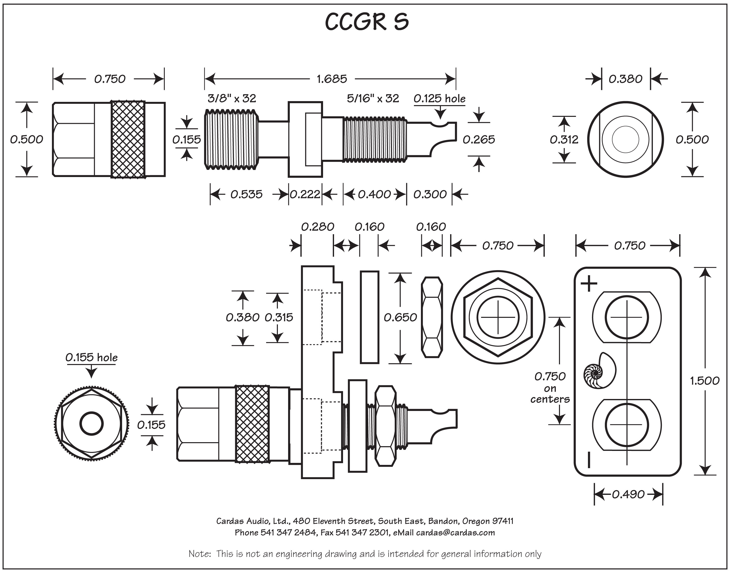

Cardas Drawing - Binding Post
Looks like the binding post cutout for the plastic mounting plate is 0.49 inches in diameter.
0.49 inches = 12.446 mm
I have allowed 13 mm holes to ensure adequate clearance.
It's not easy to interpret from the drawing if the underside of the plastic plate is a perfect circle or the same as the front face.
Any issues with this please raise now.
EDIT: CARDAS PARTS SUPPLIED BY SONICRAFT
Binding posts
Cardas CCGR S Binding Post, Sonic Craft
RCAs
Cardas GRFA L RCA, Sonic Craft
XLRs
Cardas CM F XLR Chassis XLR, Sonic Craft

I agree for your cutout dimensions based on the Cardas drawings you show.
For some reason your soniccraft links come up with a 404 error for me. I was too quick as you have removed the post I was referring to. The new links are fine, thanks.
