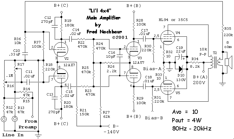

How on earth did they get that round a (I suppose not the best quality) output transformer? I thought going past 26 dB was pushing it.
OK, I found the original web site, Here. As you can see from the schematic, there is one helluvalot of open loop gain there. Considering that a 50C5 (and cousins) typically work at a V(gk)= -7.5V (15Vp-p audio) you don't need that much open loop gain unless you're really going to pour on the NFB, which is what he does.
As for how to get that around an OPT, he limits the bandwidth at both ends so as to avoid the large phase shifts that occur at frequency extremes. This, in turn, makes the thing useless for almost everything but a guitar amp.
As I said before, it's mainly a "let's see if I can do it" type project. There are way better tubes for an amp of that power level (6AQ5A -- down-rated 6V6 essentially -- would be far better).
Schematic:

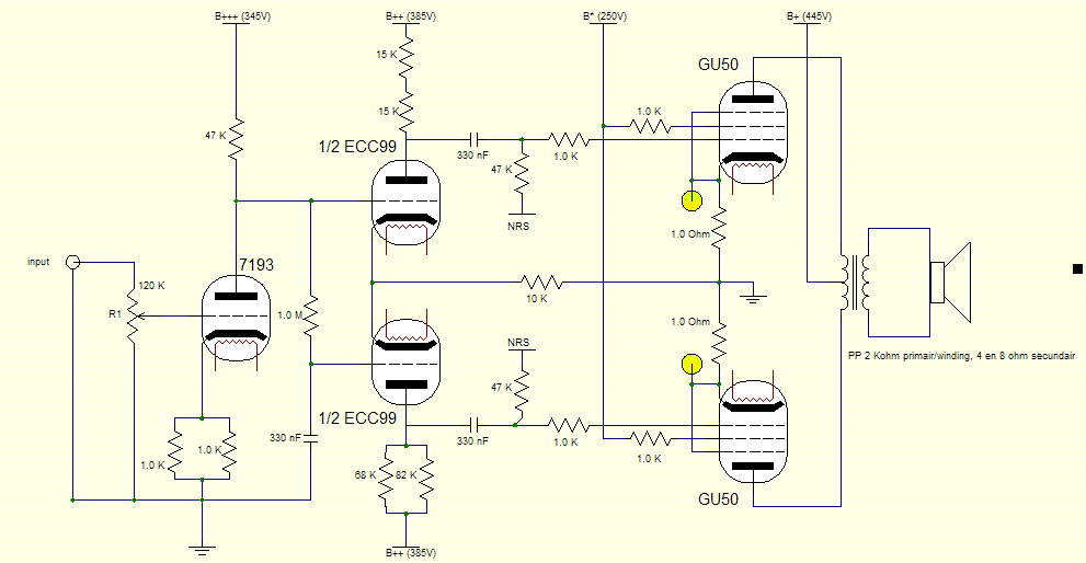

Hello,
Monday i went to Mattijs de Vries (www.machmat.com), he did some measurements on my amp.....
bandwidth -3b: @10hz-@80khz
output (triode PP): approx 12w @62,5ma 380v
distortion: 0,68% @70% output
-distortion is exactly symmetrical- many thanx to the longtailed pair splitter with current source (5965 @100v 5ma)
Some changes have been made to the amp:
OLD PSU = 2xpy500A - 47uf - 10H - 300uf - 1k5 - 82uf
NEW PSU= 2xpy500A - 220nF - 47uf -10H - 450uf - 220nf - 3k3 - 82uf - 220nf
the increase of capacitance for the output stage with the adding of little fast ones solved the bass issue...got plenty now!
the grid resistors of the 7027a from metalfilm to allen&bradley's
the current has been turned op to 70ma
and the coupling capacitors have been changed from auricap to PIO
Sorry for eventually subjective use of language; i find it very difficult to translate what i hear into words....here goes
these changes together make the amp sound really nice!! i'm listening to my music collection non-stop!! the PIO condensers were a little bit cloudy at first and things got a little unclear (although high freq backgroundsounds in music were like 3d immediately!!!) now after 2 days they're beginning to show their potency...it's gettin better!!
And a question....why feedback?? it's an error solving device...you send your signal back into the parts line, thus getting more 'parts sound'; stability problems; loss of sound...try not to make an error....then you don't have to correct it.
I'd like to see what you people think about feedback
-@prr@cerrem@johan potgieter : i very much appreciate your answers and the loads of information that i can look into because of them....
Unfortunately i just started with tubes about 2 years ago; with no technical/electrical study whatsoever...
Now i can calculate a common cathode -simple- schematic and i know what is going on in my amp and why things happen.
this is because i read and i read and i read and measure my amp and try to calculate these measurements...so i'm collecting bits of information and try to link these together with common sense and formulas i find...
the point? i try to understand but am not able to give an answer that makes sense
So, i wonder are there people who'd like to device some tube-setups which can be built at home by beginners....then they answer the questions given...which could be corrected and faults in thinking about the tubes would come above...a bit like a tube course?? in addition to the info for newbies (say moderates 🙂)

One of my early teachers ("triode dick") is a non-feedback guy.
i built his kt88 design
Maybe of some value to this thread; i switched from UL to triode to. actually a strapped pentode (?)
I know little about the details, just made the bold move to swap the kt88 for GU50's.
I've been listening to the amp for a few weeks now. I think it sounds good. But then again, it's my first amp and don't know houw good it "should" sound.
Th bass is very neat. No hummy humms and lots of "pop".
But i think it might be a little weak, as my highs sometimes get a little metallic.
I can think of a few scenario's:
- I completely messed up with the GU50's
- The GU50's need bigger coupling caps
- My speakers suck 🙂
-I'll have to get used to "real" sound and not the exaggerated bass of commercial amps
I'll post the schematic. Maybe somebody could criticise in a way that makes the output stage better understandible for me and everybody else that's relatively new to this?
Bas
