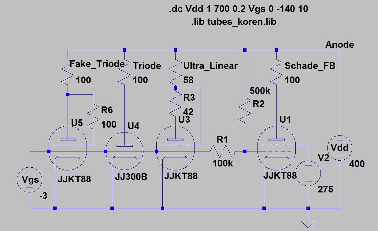

I understand (I think) how to draw a loadline on the tube characteristics for a given load. The characteristics one can get from the data sheets for various operating conditions. Now if you have a pentode or beam tetrode, you can tie g2 to a fixed voltage (pentode mode) or to anode (triode mode), or to a tap of the output transformer at a certain percentage (ultralinear mode).
Imagine that you have a kind of Variac output transformer, where you can continuously adjust the g2 tap between 0% (tied to B+) and 100% (tied to the anode). It will realize a continuous shift between pentode mode and triode mode. Or perhaps better said a variable local feedback to g2.
How could I draw the loadline for a given percentage of g2 tap?

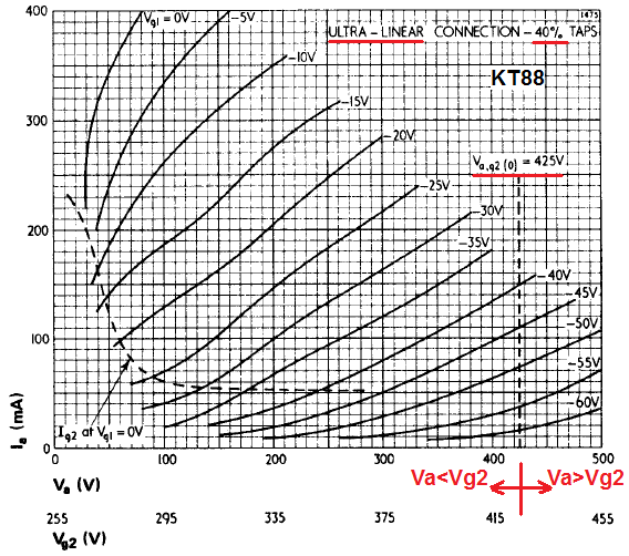

No, at least not for UL. Without signal Va=Vg2. If Va goes up Vg2 follows with a x% above Vb, Va allways higher then Vg2. And when Va drops Vg2 goes down a x% less and Vg2 gets more positive then Va.

For UL the starting point is Vb=Va=Vg2. If Va goes up from the starting point Vb for ΔV, Vg2 goes up x%ΔV from Vb. Result Va>Vg2. If Va goes down from Vb for ΔV, Vg2 goes down only x%ΔV from Vb. Result Va<Vg2.
Have a look at the UL curves from Genalex.

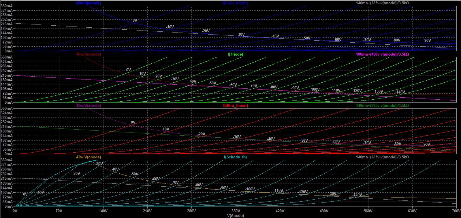

The actual way the tube UL curves were plotted is with the Tek 570 curve tracer.. The 6550A and 5881 UL curves you see in the Tung-Sol data sheets are from a Tek 570 and a UL transformer hooked up...
There is a way to do it mathematically and graph it... Not mush different than plotting cathode curves from plate curves.. They made OT with various UL taps...they kind of experimented till they came across optimum operating points...
If you want single-ended curves (which can always be flip-flopped to give push-pull curves): put a Variac across the load choke and feed screen from there. Variac will give <1% steps. For higher voltage tubes you want to work above 50/60Hz to be sure the Variac doesn't saturate. In any case the Variac MUST be fully insulated from case because there will be high voltage on all three legs.

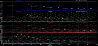

uTracer ( dos4ever.com ) have a mode to create UL charactaristics
