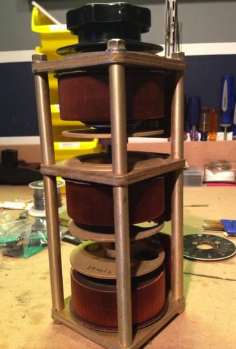

Alright, well I've not been getting warm fuzzy feedback from the transformer winders on the tapped teriary idea - it's apparently just too many taps to be realistic, and would cost and arm and a leg to have it built. To bring the cost down, the number of taps would have to be cut down, significantly limiting it's usefulness. It did not go unnoticed in my reading, that Langford-Smith & Chesterman used a tapped autoformer for their experiments, so I already had an awareness that the complicated transformer idea may not be feasible.
Plan B was similar to the historical test setups - a tapped autoformer, but with a standard OPT in parallel. Perhaps not ideal from a distortion perspective, as the two cores will draw different excitation currents and won't be tightly coupled, but perhaps good enough to be usable within a limited bandwidth. What would really be ideal though, is something more like a variac - continuously variable. Hmmm...
Now, this may or may not be a good idea, but we'll soon find out. A 3-phase variac is on it's way. The idea is to put two of the variacs in series, connected such that the tie point becomes a "center tap", and the wipers will track symmetrically outward, becoming the screen grid "taps". The third variac could be used for position measurement - could even enable servo drive for complete automation (not sure I'm that ambitious, but we'll see first how the initial testing goes). The "CT" and both ends of this arrangement will be AC coupled to the primary of a standard OPT. I went with a 400Hz model on the (possibly incorrect) presumption that it might have better coupling and bandwidth than a 50 or 60Hz version. The trade-off is that the core size and inductance will be limited, so I'll have to avoid low frequency operation.
Any glaring (or subtle) errors with this logic?

I'm afraid the variacs will have less inductance than your OPT, thus ruining the low frequencies. And if you connect the center of the variacs to B+ use a cap. For this to succeed I think you need the smallest type of variac, or a high-volage type which may not exist.

Maybe use a high-resistance pot with a follower, but you need a higher supply voltage.
From the post, Chad is already aware of the low frequency limit, presumably that means that those low frequencies will be avoided at high power levels. What is the voltage rating of the variac?
If one assumes an induction level at rated voltage at 400Hz of, say, 16000 Gauss (keeping in mind that these are designed for power, not audio, and tend to be pushed harder for that reason) then the actual induction level at actual voltages/frequencies can be easily scaled, with the added proviso that this level is additionally predicated on what voltage is applied to what percentage of the windings.
Back to the dual transformer idea, the fact that less than perfect results will be obtained for all the reasons given (though I'm not that concerned about excitation power, it should be relatively low in a well designed transformer and goes down linearly as frequency increases, but not so core power loss which is resistive in nature, it is non linear with frequency though it should still go down with frequency all other things being equal). Perhaps with the dual transformer (or variac/transformer) you can still obtain the right shape curves and expect better actual numbers with a purpose built transformer.
Not sure what AC coupling is going to buy, but I must be forgetting something. Perhaps earlier in the thread you must have said that you wanted a different level DC supply for the screens?
The real potential problem I see with the variac idea is that there is no intentional coupling between variac sections at all so the OPT is going to provide that function. The side being driven toward cutoff will couple its above B+ voltage to the one end of the corresponding variac and that in turn couple to the screen, and vice versa. Is this the way you see it? If the volt-second product thus applied to the variac is appreciable then its excitation current might indeed be high. There will actually be some cancellation of flux on the side swinging high (picture the DC flowing in one direction, the AC in the opposite) but the currents are additive on the low side. Running at 1KHz will let you about double the AC end to end rating of the variac, though the core losses will then go up.

These particular variacs are rated 120V @ 350Hz, but the 117% tap at the end of the winding is brought out to it's own terminal. So it's easier to think of them as rated for 140V. A series pair will thus handle 280Vrms, which is pretty reasonable.
AC coupling indeed merely buys a lower screen bias, which is one of the main things I want to investigate.
Interestingly, the manufacturer states the 400Hz version can also be run at 60V & 60Hz, and the specs show that the 60Hz and 400Hz versions also have the same number of turns. Considering the core sizes look to be roughly 2:1, the inductance of the 400Hz version should actually be about half that of the 60Hz version, which is better than one might expect just from the nameplate specs. However, I'm really not sure how much inductance these will have - I am guessing around 1 or 2H. As long as it's adequate and the core losses aren't too bad, I'm optimistic the setup will do what's needed.
So, the first thing I'll be doing when these arrive is measure their inductance and look at their BH characteristic to see what they can handle. I may have to live with the fact that this setup won't be able to measure more than modest power levels - so be it. The first couple of watts are the ones that matter most from a psycho-acoustic standpoint, while distortion figures at power levels closer to clipping are considerably less meaningful. In any case, the historical literature clearly establishes that UL configurations tend to maintain good distortion performance right up until they run out of swing. So, I'm prepared to settle for distortion optimization at low to moderate power levels, and let the chips fall where they may near clipping.
The lack of coupling between the two variacs is one of my major concerns. I'm actually more worried about stability issues when / if the tubes approach class B territory - another reason to keep the power levels low. I think I'll just have to try it and see.
I've got some setup work to do before this is going to be up and running. Actually, I've got to do some cleanup in the lab and make enough space for this first! 😀
Well, keep in mind that while inductance is proportional, all else being equal, to the area of the core, it is inversely proportional to the length of the magnetic path, again all else being the same. How are the cores different, that is between the true 60Hz version and the one you are getting? Also, the fact that you can run your units at a disproportionately high voltage when reducing the frequency by a factor of 6 tells me that the core may not be made up of thin laminations appropriate for 400Hz work (I always specified .004" lams for 400Hz) so the limit is more for core losses and the margin before saturation is then higher for your units than if they were true 400Hz cores. Don't know which way that will work for you but at least core losses are more resistive than reactive.
