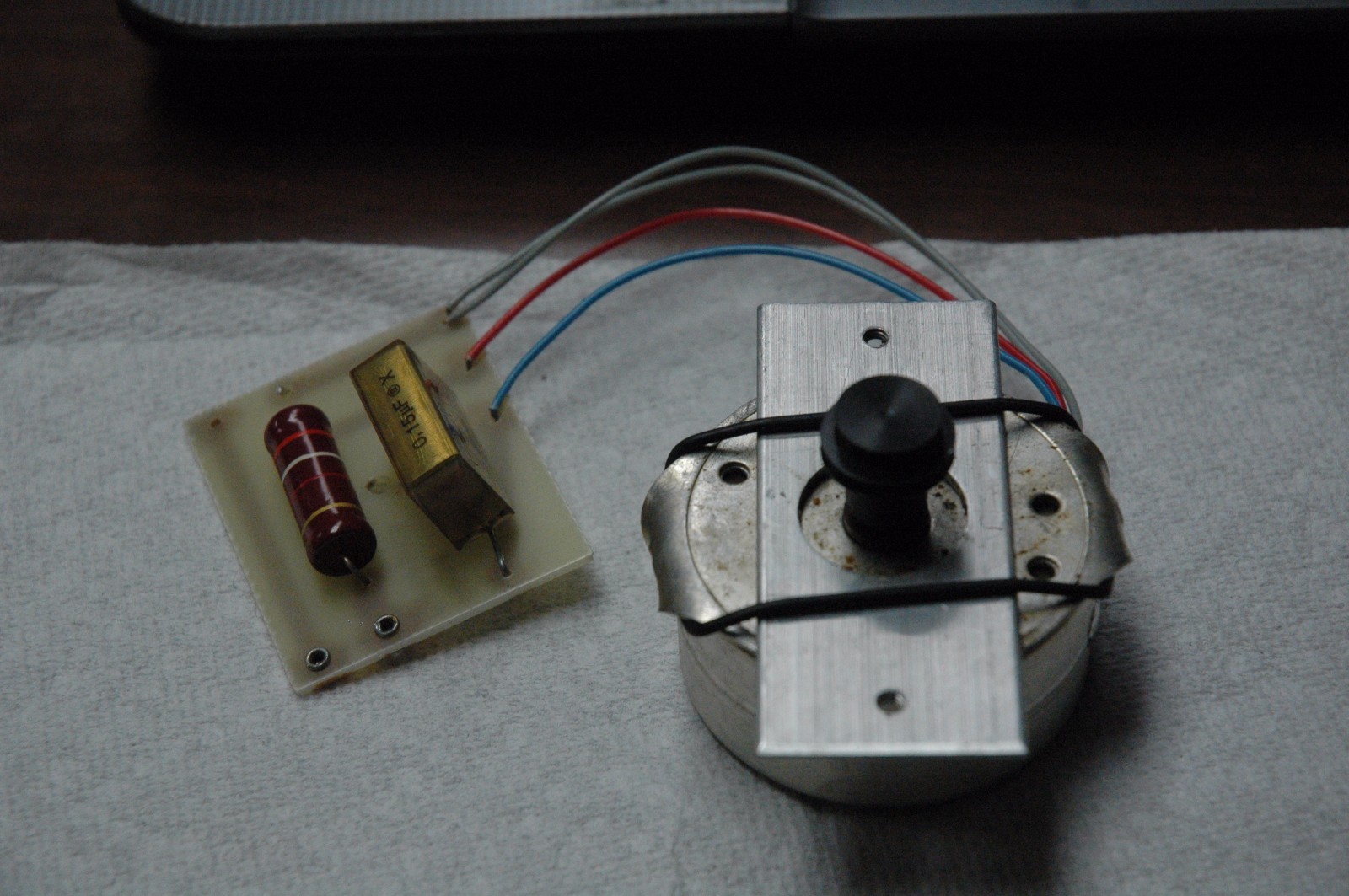

Back in the US and have just taken some measurements with the original resistor and capacitor in place.
Input voltage = 120.6 VAC
Blue + Grey = 39V
Red + gray = 38V
Blue + Red = 60V
I'll break out the soldering iron tomorrow and remove the resistor.

Just found another auction for a planar 3 motor with a nice clear image of the components.
0.15uF capacitor it is and looks to be a 290 Ohm resistor
Just removed the resistor and jumpered the wires. The motor did kick into life and as expected runs a bit fast. It is very sluggish to start at 33 1/3 and needs a push start.

As per the diagram, the wires on the transformer measured the below with an input of 236V
Blue + Grey = 99V
Red + Grey = 88V
Blue +Red = 149V
I'm still going the DIY route on this turmtable at the moment and managed to drop by a local Fry's to pick up a couple of 1K 2W resistors, they didn't have any 0.15 or 0.18uF capacitors.
With 120V from the wall and with the original 0.22UF capacitor. I get the following measurements
Blue + Grey => OΩ = 148V; 1K = 131V; 2K = 123V
Red + Grey => OΩ = 120V; 1K = 101V; 2K = 88.7
Blue + Red => OΩ = 193V; 1K = 164V; 2K = 144V
It's currently got the 2K resistance fitted and fitted a Tangospinner 60Hz pulley, a new belt as well as resoldering the RCAs. The TT now plays at the correct speed and sounds better than I imagined it would.
