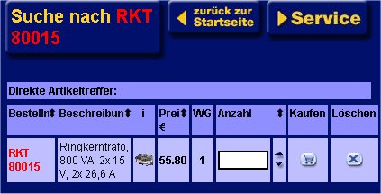

TRANSFORMERS....
Andrew please can you post your ideal transformer requiremnts
I will do a search...........from what I gather we should be looking for approx 600-750va @18v is this correct?
For the amps I intend on building, I am looking at the folowing specs:
Transformer - 15-0-15 to give approx +/- 20V rails (18-0-18 would also be ok I guess, although things may get a littel more toasty)
Bias Current - Approx 5A (Limited by Heatsinking)
Dissipation - Approx 200W (to give around a 40deg temp rise from a 0.21deg/w heatsink)
No of out put devices per chanel - 8 (to give about 25W per device)
Output Power would be about 80w into eight ohms for the 15-0-15 transformer (that would go up to about 100W for the 18V transformer) which is more than enough for my curent speakers.

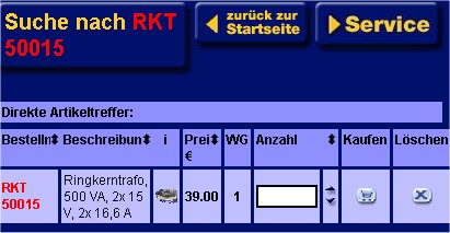

Reichelt has 12, 15 and 18 V at 330, 500 and even 800 VA. Prices are cheap at EUR 39 for 500 VA and EUR 56 for 800 VA.
Elfa has 12/15(only up to 300 VA)/18 up to 500 VA.

Transformers
Reichelt do indeed have the transformers - in the "Suche" (search) box simply type 800va and hit the go button!
