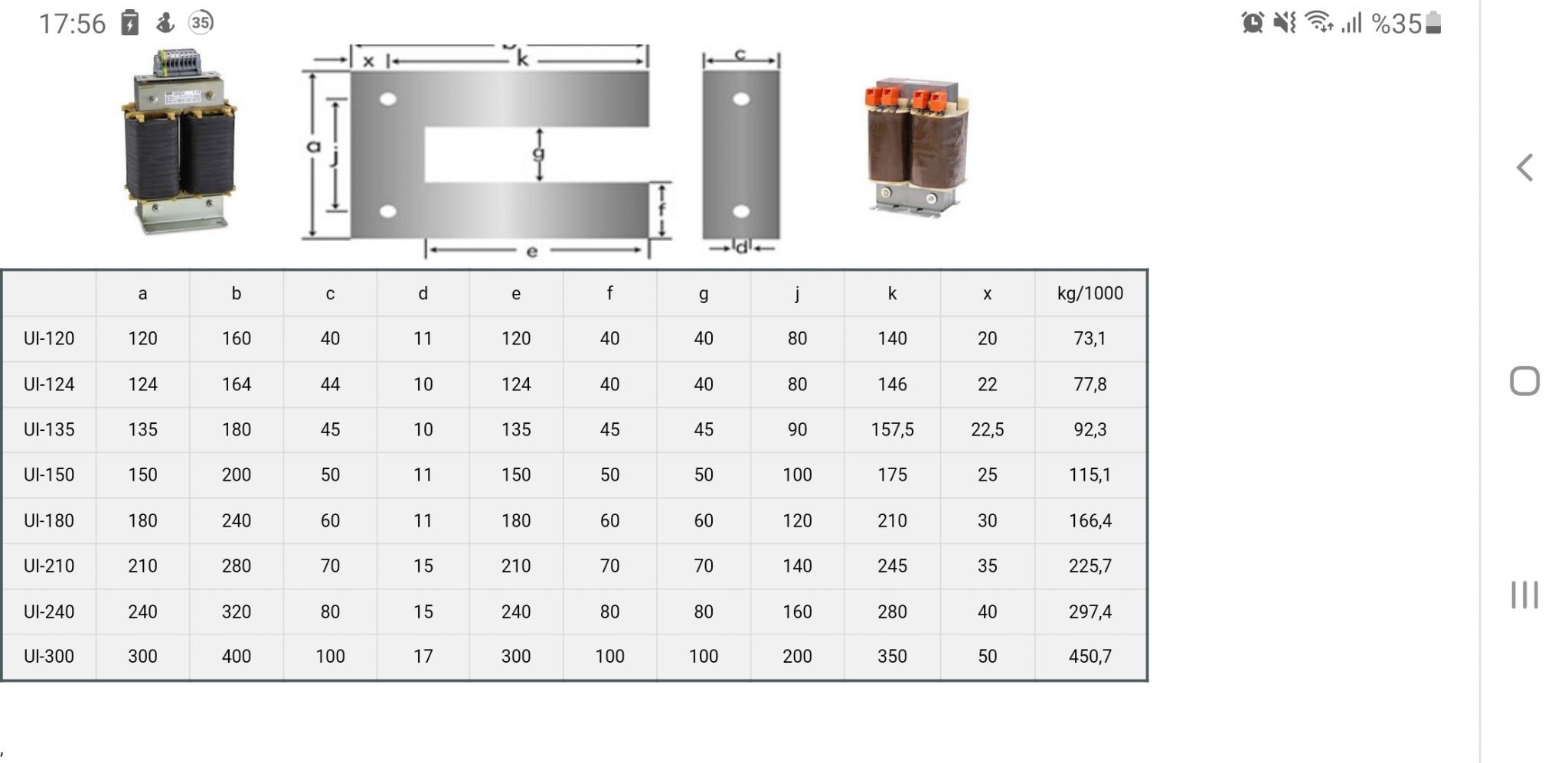

Hi. We will build a high end audio amplifier and think 500VA transformer will be enough. And also we want to build another 50w transformer. We can supply sheets in the picture attached. We want to build with UI sheets. Please check pictures and could anyone tell which of them and how many pcs of them will be suitable. Their gauss is 10000-12000 .Thanks in advance. Best regards Veys

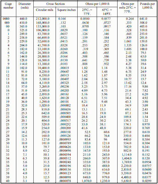

your core area in square centimeters, x 0.95(stacking factor) call this A,
then your turns per volt becomes 42/A, then for wire size, you can start at 500 circular mils per ampere, if more space is available you can choose wires one size or so higher..
ARRL wire tables are available in the net to download...

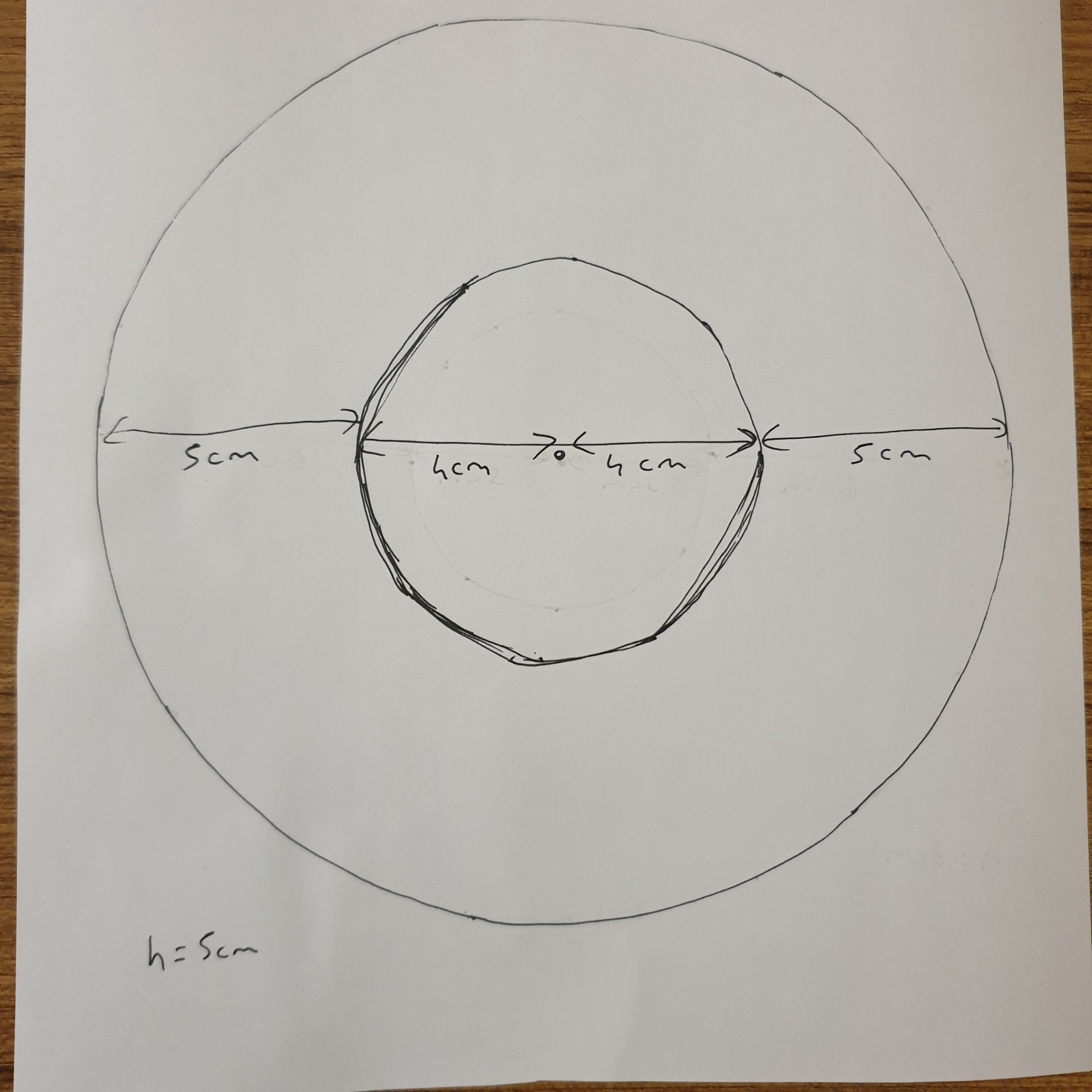

Hi. For 18cm toroidal core which design is better ? First ones height is 6cm and second ones height 5cm. Please check pictures attached .How can we decide the dimensions? Is there any golden ratio for toroidal transformers ?

The first one is "fatter", and should require less material, copper and iron, but the magnetic path length varies heavily between the inner part of the iron, and the outside. This means that it will partially saturate more quickly.
A slimmer toroid will not have this problem, but it will require more iron for a given power, thus higher iron losses and higher reluctance of the magnetic circuit leading to a higher magnetizing current.
I have no knowledge of a single "golden ratio", but it possible to find studies of the subject, like this one for example: https://core.ac.uk/download/pdf/80647289.pdf
Pretty dense stuff, but if you manage to absorb and use it, you will arrive at a pretty optimal design

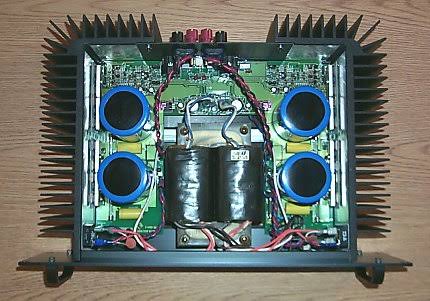

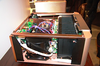

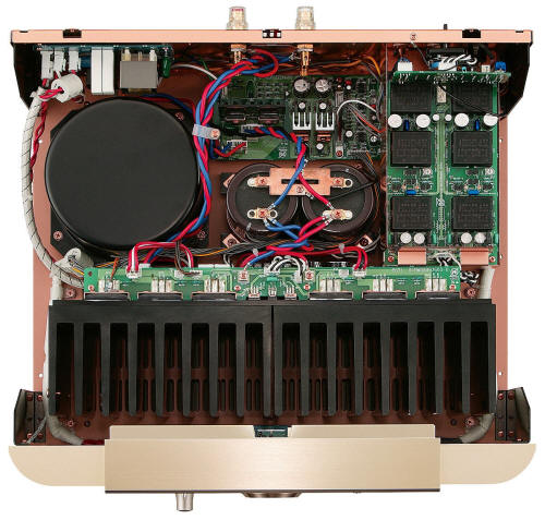

Hi Veysel.Marantz MA9S2 has this toroid which is tall. Please check picture attached. Its dimensions seems about 130mm wide and more than 150mm high if comparing to its body size (about 450mm width and 200mm height)
It seems stell core is slim but high.

Difficult to tell, but one thing is certain: the cross section should be ~square, or thereabout. It will limit the mean turn length and reduce the likelihood of stray fields.
Other than that, things become much more complicated and less clear-cut.
Extreme variations are certainly detrimental, but reasonable ratios are much more difficult to evaluate objectively, and the best case may vary according to the objectives: do you want to reduce the idle power, increase the efficiency for the full load, get the best regulation?
This is complicated, and there is no simple single answer
