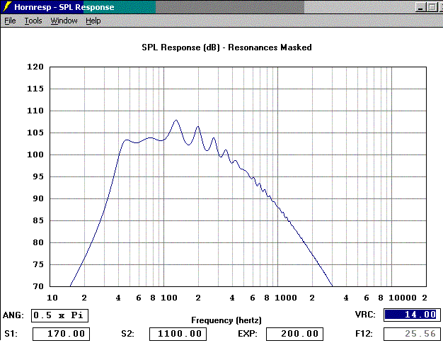

2x19$ NZ 8inchwoofers(10 $ US)
(they used to be 80$ each! such a rip off)'digitor' brand.
with an exponential basshorn
what do u get??
a low sound quality horn,with moderate SPL??
twin 8" 40hz basshorn
you really have to doubt the construction quality!!
...but aslong as i dont go TOO high compression ratio it should survive a few watts
Fs=40hz +-8hz (haha)
Qts=0.5
Vas=42L
xmax 3.5mm
Pe=25watt
only other thing i can think of is dual ported bandpass to minimise excursions,,
or enjoy the ported box quiet 99db levels.. 😛
yes its not quite a jbl2226h 15"(which i have),but its FUN and CHEAP and something to do,
Do you think its worth constructing a horn ?
its not big
200cm long
170cm throat >1100cm mouth
