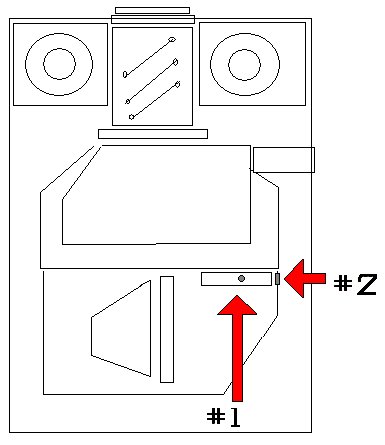

Before I show you how to adjust the image I want you to try something. Shift the lamp inside the projector from side to side and up and down to see if that removes the line on the left side of your screen.
Basically what you are trying to do is center the beam of light that is comming out of the lamp and into the projector. You will have to open the lamp cover, adjust the lamp and close it again to start it ( I did this many many times). An easier way of doing it is to put a piece of paper or cardboard in the lamp cover switch (white button looking thing) to keep the projector going while the cover is off. Doing this will give you time to play with the lamp and wiggle it around till you have a good image, then brace it.

I'll work on that diagram today to show you where the alignment screws are but try what I said first. Might save you lots of trouble.

Dude, your awesome....thanks. I put the lamp back into the housing like you said and shoved the cardboard into the sides to keep the lamp aligned with the fresnel. Boy I hope that piece of cardboard doesn't burn up, I have no extinguisher. I got a picture projected, it shows the line but if I shake the projector a little the line disappears. Tell me this is your picture dim or strong. I can see a little in moderate light but I still have to turn off all lights to have an awesome picture. And is your fan harsh and loud? thanks a million.....Pat

Attached you'll see a crappy image I made to show you more or less where to go. I had a pic of the projector from the top with the cover removed that I wan'ted to use for this but I lost it. 😕
Arrow #1: Points to a screw that adjusts the horizontal. To get to this screw you have to remove a black piece of plastic tape. It'll be rectangle looking. Just stick a blade under it and pull it off. There you'll see an adjustment screw. Adjust till the line is gone (Adjust while the projector is ON ) but don't adjust to much as there is a spring clip holding two frames together. If this clip springs off then you'll have to take the whole projector appart to set it again. NO fun... :bawling:
Arrow #2: Is basically the same thing but adjusts the vertical. It's on the side of the light engine. It might be under the same kind of plastic or it might not, I don't remember. It's really hard to get to the screw so use a small curved screw driver is you have one. If not there are a few screws you remove that will allow you to move the whole light engine to give you some room.
Thats basically it. Im sure it'll take care of your problem.
