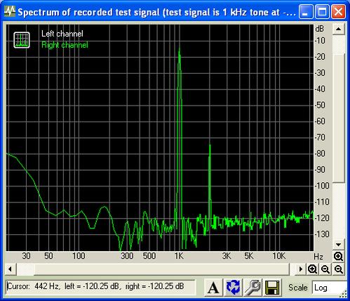

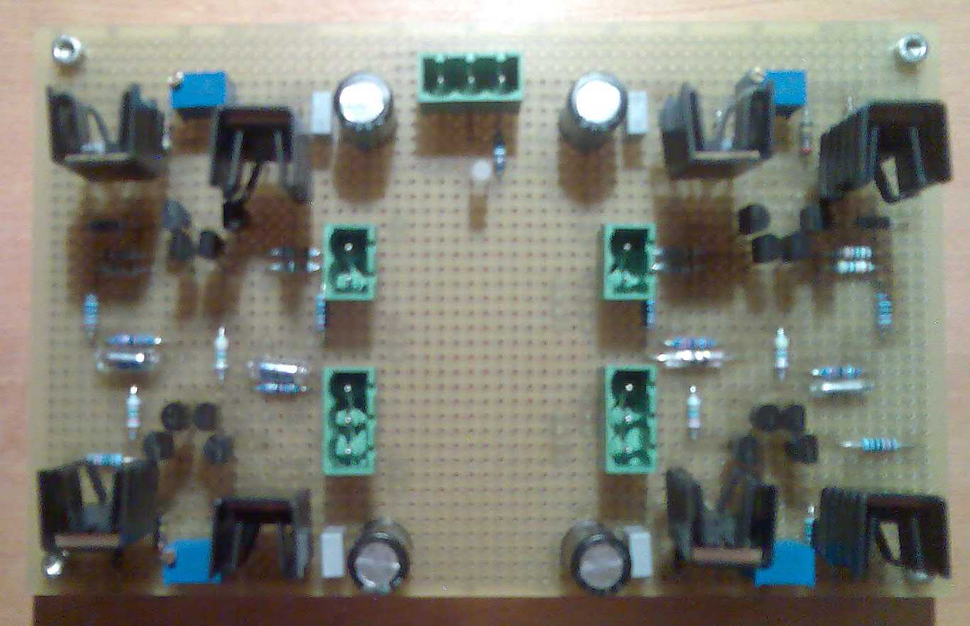

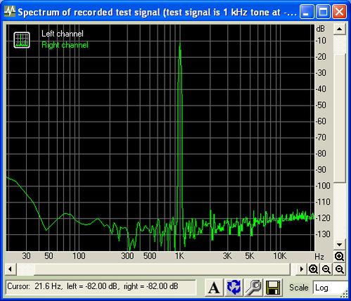

Hi Ian,
enclosed a picture of my UGS board, the schematic and FFT plots.
The first FFT is from the soundcard in loopback mode only. The second FFT is with soundcard and UGS board. For the measurements I used a Terratec Phase26 USB. As I mentioned yesterday, it has only single ended inputs and outputs. Therefore the second FFT plot shows only the spectrum of the positive output voltage. A more professional soundcard with balanced inputs and outputs like the E-MU 0404 would be better for my requirements. The software I've used is RMAA from Audio Rightmark. It is available for free. SpectraPLUS is more powerful and more adequate for such measurements, but it is not for free, after trial period of 30 days you have to buy the software.
Sorry for the bad quality of the board picture.
Uwe
Uwe
Not sure about compensating for the loss of gain by decreasing R6 though. This will increase the current in both input and second stages but I doubt it will have a huge impact on gain. The gain is determined largely by the ratio of R12 to R7 (and the same for the other three quadrants).
Ian.
Of course you're right. Maybe it was too late yesterday evening 😉
For keeping the same OLG for the second stage in case R6 is decreased the source resistors of the mosfets have to be increased as well.
It seems to be hard to find the optimum operating conditions for your requirements (high CL gain, high CL bandwith, less neg feedback, high output voltage swing). My requirements are more relaxed. Basically I need only a single to balanced converter with some gain in the range of 2 for driving my balanced F5.
Nevertheless, I think spice simulations are best suited for such optimizations. Do you have appropriate models for the mosfets you use? So far I haven't found spice models for IRF610/9610 on the net.
Regards, Uwe

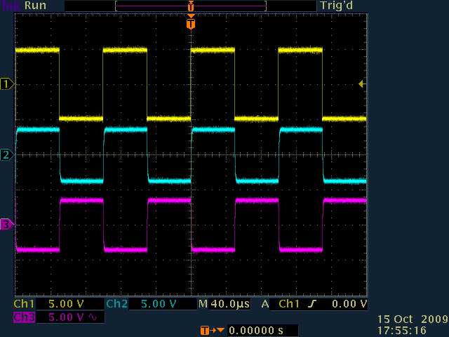

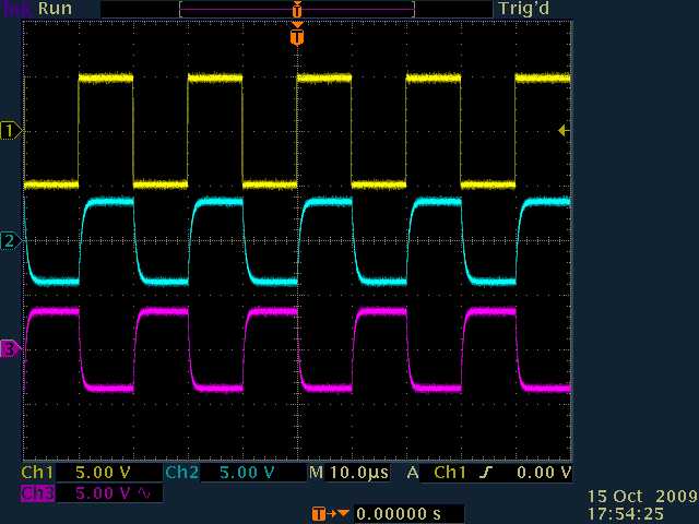

Ian,
as promised, some scope plots. The input voltage (top trace) is 10Vpp, the middle and bottom traces are the output voltages. The left plot is with 10kHz, the right one with 50kHz.
I would be glad if you would post the spice models for IRF610/9610 and/or IRF510/9510 you use. Thanks a lot.
Have you checked if Toshiba offers mosfets with lower Cgd? I'm thinking about to replace the IRFs with 2SK2013/2SJ313 in my UGS.
Regards, Uwe

Hi Uwe,
I would say the performance you are seeing with a 50KHz square wave is pretty impressive. Why do you want to change the MOSFETs? The Toshiba devices you mention are laterals and hence have lower transconductance (0.7S) than the IRFs (2S). They also have a lower Vgs so you will need to change the resistor values round a bit. Given that they don't have that much lower Cgd (17 rather than 20pf) I am not sure it would be worth the change.
I have a few suggestions to make regarding your circuit which I will try and write up shortly and post. Maybe you will like them but even if not, hopefully food for thought or experimentation.
I'll post the spice models this weekend when I have access to my home computer.
Ian.

I’ve spent the last week or so going back to basics and analyzing things more carefully to check my understanding and hopefully avoid going off at a tangent. So, I built another UGS omitting the output followers so see if practice matched the theory. I have included an updated schematic as I made a few small changes.
I’m running each half of the diff pair at 6mA (Idss was measured at 12.7mA) and Vds is set at 7.3v. I’ve lowered the values of the bias resistors (R1, R2 and R3) as it has been suggested several times. Also included this time are the capacitors from the cascode bases to ground. For simplicity, I used a single ended input signal and measured the output at Q6 collector.
The results of my measurements are: Gain = 26dB, -3dB point = 200kHz, with a slew rate of 1.1 v/uS. This is very close to the simulated values and seems quite respectable.
Out of interest, I repeated the measurements with a lower diff pair current of 4.75mA with very little change other than a small drop in gain to 25.3dB. Again this in accord with simulated results.
I also tried varying Vds, increasing this seems to speed up the circuit a little but not by much. Dissipation constraints in the FETs will in any case place an upper limit on the Vds, Id product.
Adding source resistors also had the expected effect, 20R increasing the -3dB frequency to 270kHz for example.
One observation I had not expected is the influence of R27 and R28 on the frequency response. Increasing these from the 3.7K I just happened to have in the circuit caused a marked reduction, the -3dB frequency dropping to 40kHz with 200k for example. Perhaps this has to do with the effective source impedance and its interaction with the input capacitance of the JFETs? Anyway, it is a fortuitous effect in that I need something around 3K in my complete circuit to ‘throw away’ some of the feedback. More on this in a later post.
For now I am going to conclude that my original theory about the output followers being the cause of the low slew rate is looking increasingly plausible as the diff pair and cascodes appear to work just fine. Proving this however will have to wait until the alternative devices I have ordered show up, hopefully in the next few days.
Ian.

A few days ago I've tried your suggestions regarding my UGS. Low open loop gain rules! It gives definitely the better sound. Drawback is the poorer dc offset stability (maybe more 1/f noise). Unfortunately I haven't found time to do some measurements so far.
Uwe
Uwe
