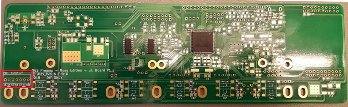

Quick question. The input selector, can a rotary selector be used or is it strictly limited momentary SW ?
since nobody answered your question, then I will.
Answer: Yes you can. But the rotary switch have to be a "brake before make".
Can be connected with wires here:
So you can proceed with your renderings 🙂
Thanks for the information. I honestly didn't do a proper investigation, figuring that since the designers are active in communication that it would be faster to just ask.
So a 6 position rotary switch will do the trick ?
I think you will need a seven position ? Position one = nothing selected.
Not sure about that, so I let Alex or Eric answer that one. But, it has to be a "brake before make" switch.
If a 6 position is O.K, an Elma switch is a good choice.
If a rotary switch is selected instead of the pushbutton-switches, it would save people a lot of time designing/making their frontpanels.
I know……. 😉 Spent a lot of time designing mine 😎
