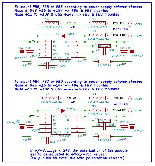

Here is the schematic for the regulation for the UGS module:

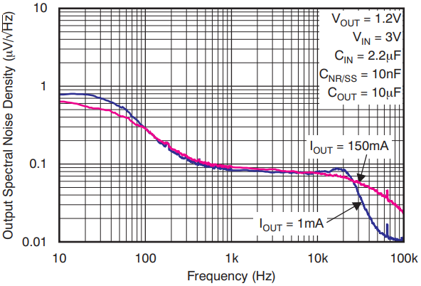

And it's noice performance:
You will then see that it is in the range of many of the other controllers, but is a bit poor at 10Hz where it has 0.6 uV / SQRT (Hz)). Total integrated noise from this is about 12uV RMS up to 20kHz.
