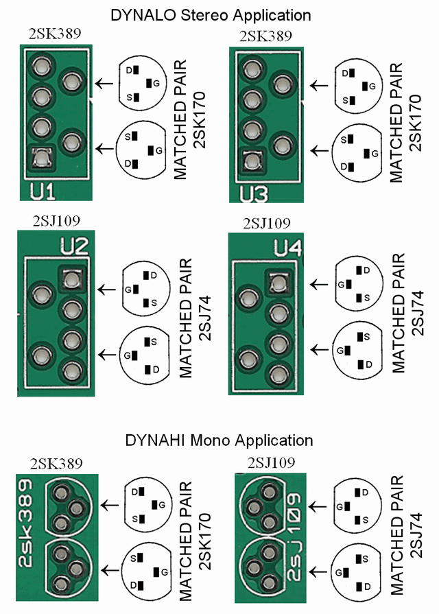

In fact, there is no need to redesign the UGS-3 PCB to accomodate LSJ74/LSK70 grade B.
LSJ74 and LSK70 have DGS pinnout whereas 2SJ109 and 2SK389 are DGS-SGD.
So soldering them side by side in opposite orientation would do it.

I guess picture will tell more than 1000 worlds 🙂
The only downside of this arrangement is slightly more complicated thermal coupling of both trannies. So the only one reason to re-design existing UGS PCB would be to re arrange location of those devices to glue/join them together with flat surface.

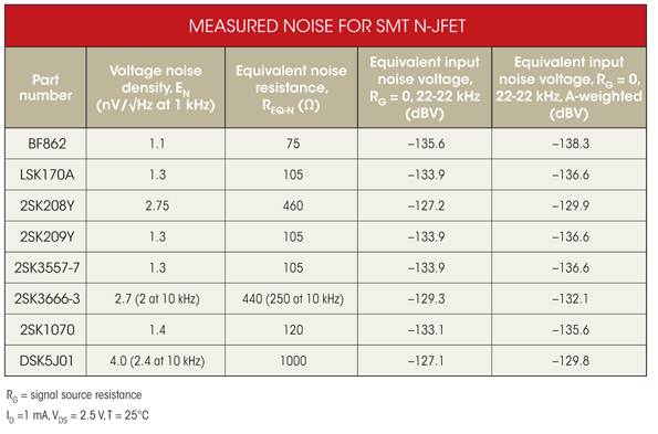

how do the LSK compare sonically and technically to the toshiba jFET‘s?
anybody already used them?

That I don't know. There are some reliable vendors on Ebay that sell matched original Toshiba 2sj74 and 2sk170. If you want genuine Toshiba JFet's, that's what you need to get. I have not heard anything bad about the Linear Systems reproduction, perhaps others have.
