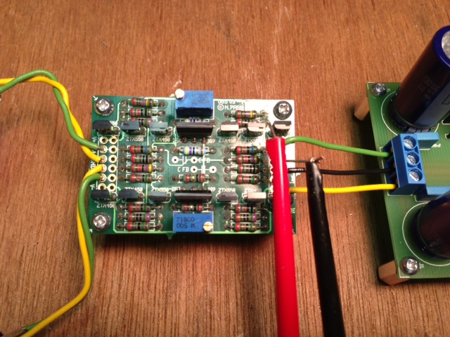

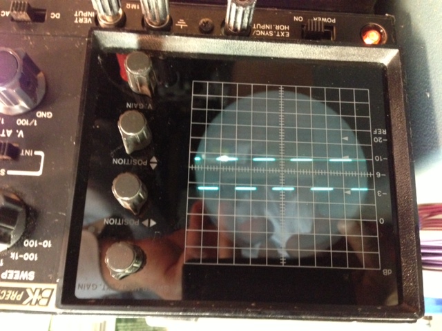

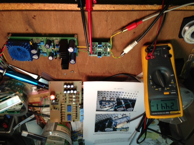

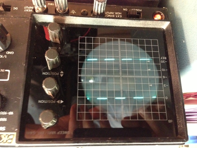

UGS module first test
Hello again, I am doing my first UGS module test and I am seeing about 6dB gain. What should be the gain of the UGS module? Attached are some pictures of my test: 1KHz square wave input / output signals.

I see you are measuring unbal output, will you use UGS unbalanced ?
site is up http://psykok.dyndns.org/diy/preamp_ugs but no trace of expected gain
I'm afraid original site is now down
Can't remind the gain
if you read french : http://psykok.dyndns.org/diy/preamp_ugs/pdf/UGS pour les nuls.pdf
differential gain is 10.4dB, unbal is 4.4dB
seems you're OK (not same Rin and/or Rfb, I suppose)
Thanks Maousse, you are right I am testing unbalanced connection at the moment. Rin is 15K while the feedback Rfb is 56K like it is in v3. The finished amp will support both balanced and unbalanced inputs/outputs.
