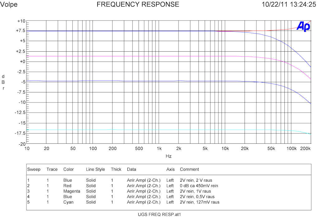

here is a Audio Precision Frequency Response measurement of my UGS all-inclusive build (all-inclusive means PCB set including volume control, input selector, CPU and display boards from french HCFR forum).
The measurement was provided as a free-of-charge service by Mr. Fuchs from Volpe-Audio Electronics - electronics development at the Analogue Audio Association event in Krefeld/Germany. Thanks a lot for the nice talk and measurement session !
Measurements revealed that the frequency response is flat between 10hz and 80khz (-3dB point with 2V input and 2 Volt output)
Frequency response of UGS Preamp shows dependency on the volume setting.
Cause is probably parasitic capacitance (here: Vishay Dale CMF-55) of the resistor network - maybe to some extend also switching relais or PCB circuits.
Red Line: Volume attentuator set to 0dB - no attentuation.
-3dB point is beyond 200khz.
Other lines: Frequency response at different volume levels. -3dB point varies with volume level with minimum at 80khz.
Based on a lot of listening sessions, my impression is that the preamp sounds very neutral - the difference between the amp and amp-bypass at same loudness is minimal. But I also find that when bypassing the amp - or when setting volume attentuation to 0db (none) - the sound is a bit better.
Not sure where to look for, but the volume attentuator resistor ladder and relais circuits could be an option........

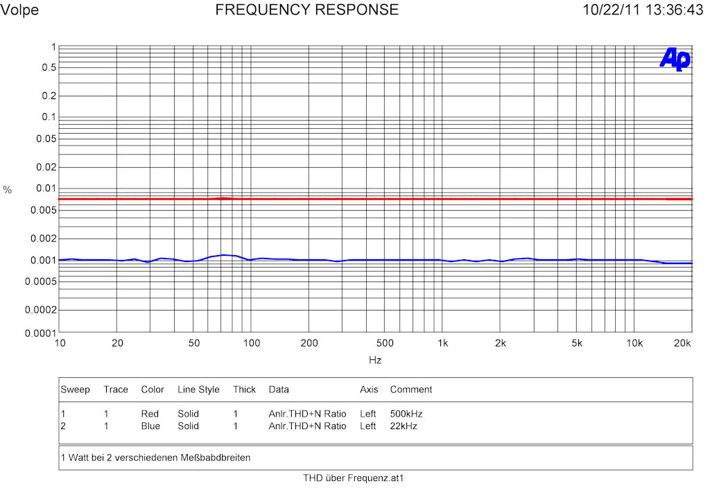

here is a Audio Precision THD+N over frequency measurement.
THD with 500khz Bandwidth is ~ 0.004%.
As this distortion curve is independent from frequency, it seems to be dominated by background noise.
Limiting the bandwith and excluding the high-frequency portion of the noise result is:
THD with 22kHZ Bandwidth is ~ 0.001%
I am not an expert in THD figures of preamps, but I'd say it looks very well...
[Measurement kindly done by Mr. Fuchs from www.volpe.at]

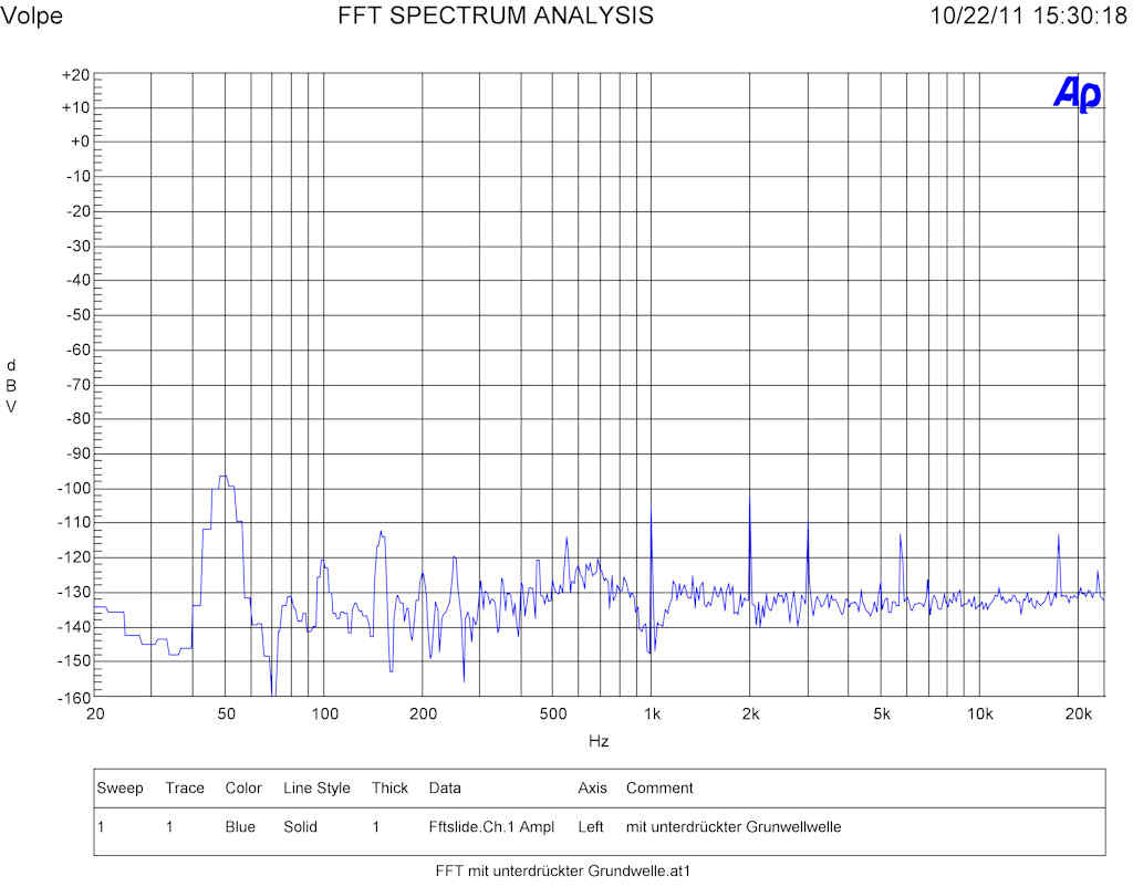

UGS CCMR and FFT measurement

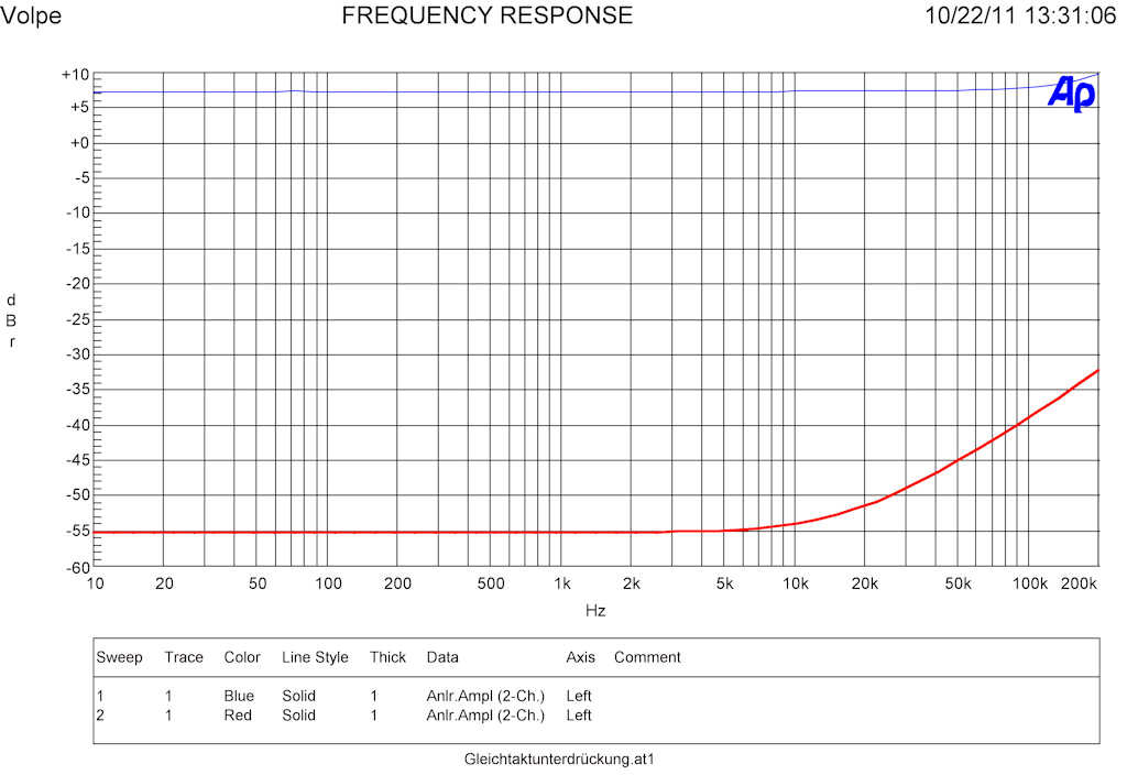

Last but not least the CCMR and FFT measurements:
Common Mode Rejection
Common Mode Rejection on the symmetrical input is around -60dB.
Not too bad, but maybe some even better matching of transistors and some resistors is required here to lower CMRR ?
FFT with suppressed ground/base wave
Residual 50hz AC-line-noise is at approx. -100db - looks fine.
FFT shows some -115dB noise at 5.9khz and it's K3 at 17.7 khz.
There is a small noise-generator hidden somewhere in my circuit layout.
Measurements with different inputs and separate ground-reference of the audio-precision
indicate that there is a grounding problem in my layout.
However at -115db level of this noise - it is probably not really audible on the speakers ?
Ouahouh!!!!
Many thanks Dsdjoy for these nice measures!
Cmrr is finaly not so bad!!!
