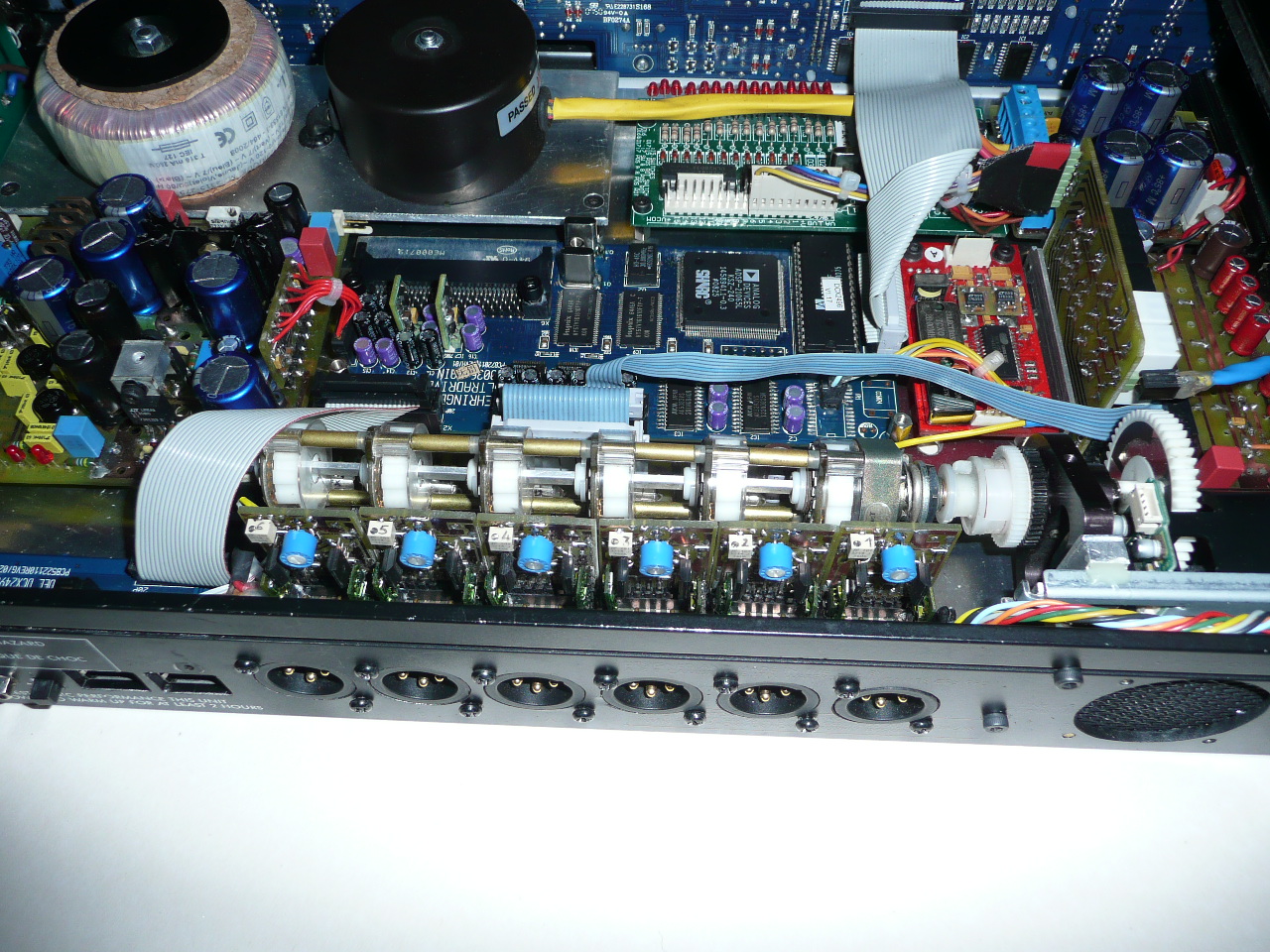

Hi, CheffDeGaar.
I am new on this forum, while I did read it all with enthusiasm.
I then decided to bring some contribution to your thread.
Please find attached a picture of my DCX equiped with six downsized UGS output stages.
They work very fine and they are amazingly stable.
Thanks again.

I don't know what a DCX is but it seems you have done a very nice work ... Félicitations ...
Manu
Hi, Manu.
Sorry for the lack of precision.
DCX stands for Behringer DCX2496 Digital X-over.
You will find a lot about it on the following URL : http://www.diyaudio.com/forums/showthread.php?t=15943&page=199&highlight=DCX2496.
While the set has few drawbacks it only cost 300€ in Europe. DIYers love it...

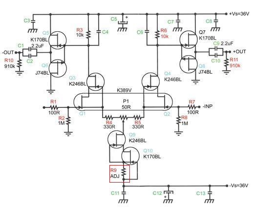

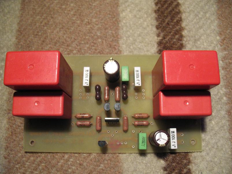

Hello
Can someone help me with these Borbely pre ..
Any idea about R9 ADJ(resistor )or trimpot . Actually I finished the preamplifier but because that (one) value missing I can not power it up .
One of my PC board not fully populated and mounted . I attached a picture from that to..
Greets
Merry Christmas
Hello
Greets
Merry Christmas
Testing and alignment
Select R9 to give 16V (max 20V) voltage drop across R3 and R6. Then adjust P1 to give equal DC voltage at Q3 and Q4 Drain. (Test on R3, R6).
Merry Christmas too!
Thank you Walter
I will finish soon my preamp , I will report the result .
Also I'm planing to put together a UGS preamp .
I just ordered the parts for that .
These preamp I have 2 years almost ready only information was missing how I adjust R9 and what would be the right value .
Now I know , thanks to generg and to you .
Greets .
