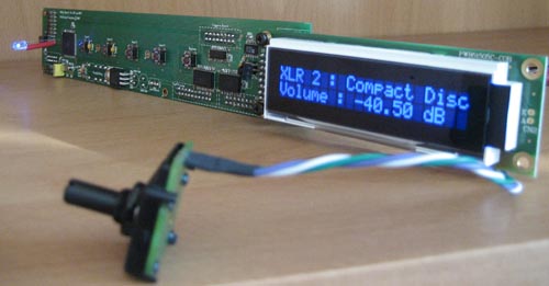

Ok, as promised here is a picture of my Type 1 display.
Almost all is well, discovered yesterday that the brightness control is not working, although the contrast is....
This is clear from the picture, the background rectangles are way too visible.
Just a little bug, i hope.
Does voltage on pin 12 of AD8402 (wrt ground) varies when you change brightness ?
(Limiting resistors for the pot are 12K7 and 3K92 n my case, instead of 12K and 4K7 as written on pcb)

12k1 and 3k3 works for me....just because i had them lying around hehe.
........i confused the values with Type 2 display 🙁
all is well and lovely, thank you!
Those PCB are original CheffDeGaar's own UGS, ultraFlat design 😉
So there will a second unit in the world 😛
The PCB GB vmoreau did is for a 2units enclosure design.

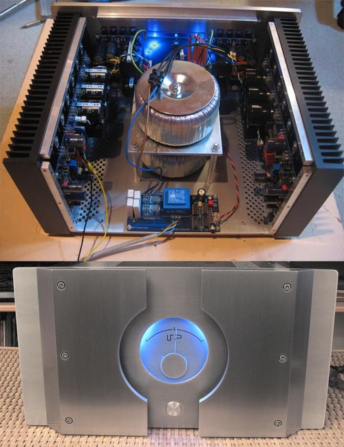

The board was made for me by the same company that made de GB boards, found them through the discussions with Pavel Dudek......his amplifiers are built with some of the most beautifull boards i have seen.

jacco vermeulen said:You mean : Pavel's amps are in all respects amongst the most beautiful.
Jacco,
Talking about beautifull amps and boards.....seen this ?
