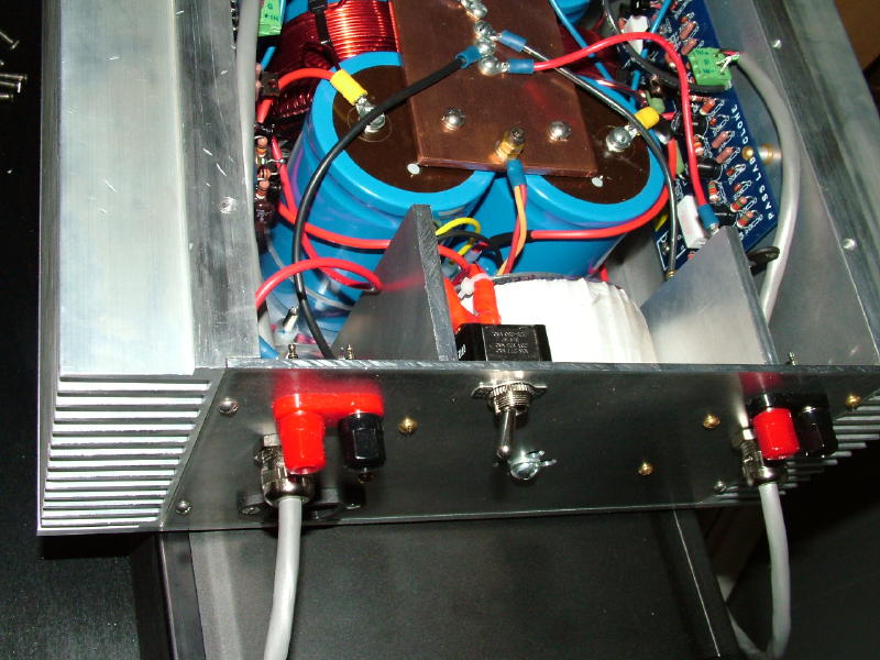

I do not usually comment on metal work, but that's a pretty spiffy looking chassis.

hi there,
some of us have continued to work on the UGS "atours" as we say in French !😀
For menu :
- 4 inputs unbalanced and balanced
- 2 outputs (un and balanced)
- 4 triggers IN
- 3 triggers OUT
- volume control attenuator 128 steps of 0.75dB by relays
- sources selection by relays also (TQ2-24V)
- LCD display 2x20 characters
- IR remote control (not yet defined for me !!!)
- subwoofer module !
- bypass to use your amplifiers for HT (for example !) without using the UGS part
- etc.....
So, it's a jewel that Cheff has thought !😎
Thanks a lot to him !😉
Just a picture to show you !!!!

Sorry, i forgot to show you a pict of the backside of the UGS !
So guys, what do you think of this ?😀
To be honnest, it's not mine but one of the 2 of them who helped Cheff to build this preamp...😎
Ugly!
but- I personally don't like any sort of connectors seen on these pics;
good for DC supplies,but for sig...........in DIY...........naah.

nice connectors , but dreky pcbs .
well...i can't see any pictures, so can't really comment, but i am curious as to what connectors are no good for quality audio.
The connectors you don't like (I think you talk about the flat cables?) are for le µC board, plus the relays command lines. No audio signal is leaving the main boards.Zen Mod said:Ugly!
Maousse said:No audio signal is leaving the main boards.
Could have fooled me.
Not trying to fool, just talking about the flat cables. 😉jacco vermeulen said:Could have fooled me.
But you are right, at that place, there can be some hard wires soldered instead of connectors.
I'll test, but not sure my system allows me to hear something.

Counting angels on a pinhead ?
These are gold plated connectors, with max contact resistance of 12 milliohms/contact, and are //ed two by two, so 6 milliohms/signal line max.
OK, I do not have figures about capacitance and inductance, so the reason of dislike must be there 😉
