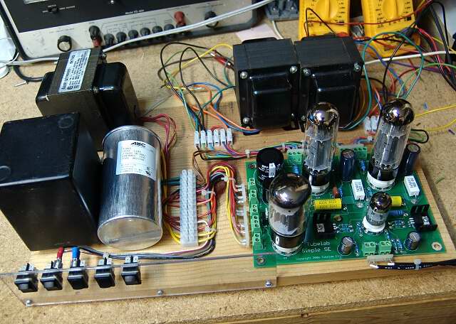

When I started making TubelabSE amplifiers I realized that testing newly built PC boards was a pain. I would drag out a set of transformers, tack solder the wires to the PC board, then test everything, only to disconnect the transformers and put them away. People assembling amplifiers also told me that they would like a better way to hook up the transformers. I decided to use connectors on my latest design. That worked out well so far.
I am always trying experiments with different transformers, tubes, chokes and so forth. The connectors made it easier to do this. I have ordered a batch of PC boards for this amp and I would like to have a way to test a newly built board without the setup time. I started thinking............
Then I thought of a way that I could test a board, or an OPT, or a power transformer, or choke, with only a screwdriver. So, I built it!
It is ugly, so call it a breadboard, or a test fixture. The pins that are used to plug into the screw terminals on the PC board were saved (for a long time) from my earlier life making SS-50 buss computers. The "euro - style" terminal strips are from All Electronics (also available at Radio Shack). Each OPT and the power transformer are connected using one of these.
It is not even finished yet, and I have already cranked through about 5 different sets of OPT's and 3 power transformers. I have several more waiting to be tested. After playing with it this weekend, I added the switch panel. It is not all connected up yet, but I will be able to switch from UL to triode, turn on or off the cathode feedback, switch from tube to SS rectifier, and go into standby.

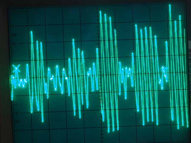

While playing with this amp, and testing the different output transformers, I captured this bass guitar run on my storage scope. This is a burst of 5 notes, each at about 90 HZ. The scope is set at 5 volts per division and connected directly across the left channel speaker. There are clean waves of about 35 volts peak to peak, across an 8 ohm (nominal) speaker. This is from an EL-34 in triode mode. Cathode feedback is on.

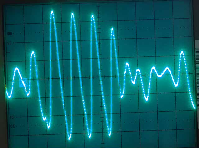

Same trace, zoomed in to 10 mS per division.

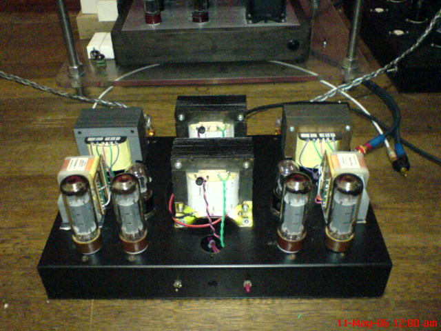

Let me show you what ugly means...
That is not even close to ugly! I have seen (and built) far worse. If we need to have an ugly amp contest, I need to make a trip to the warehouse to visit the "amps that didn't make it corner". Everyone has built one (or more) of those amps that we don't talk about on the forums. You know, the one that you hastilly put together, that never worked, or smoked on initial power up. I have a few of those, that I rob for parts now and then.

20W from an EL34 in triode mode single ended?
35 volts P-P across an 8 ohm resistor would be almost 20 watts. I know my speaker is NOT 8 ohms at 90 HZ, although I don't know what it really is.
I have not taken the time to accurately measure the power under the conditions that I am currently running the amp. I would suspect power near 10 watts since I am running 480 volts B+ and a 3000 ohm load. The cathode feedback allows me to lower the load impedance without sounding gross, and the high B+ gives a lot of headroom.
I am running 60 mA of tube current with 435 volts across the tube. 480 volts - 33 (cathode resistor) - 12 (OPT) = 435 volts. This gives a total tube dissipation (plate and screen) of 26 watts. Near max, but the JJ EL-34's show no signs of distress. This was not the case with the "Winged C's".
This combination sounds excellent on real music, but I haven't made measurements yet. Real measured data under different load conditions with several different transformers will follow shortly. That is one of the reasons for building this amp.

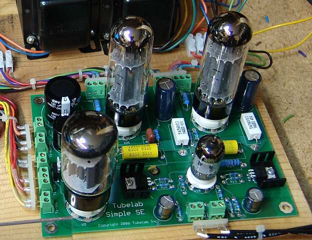

I reduced some of the ugliness by dropping in a shiny new circuit board. I got the batch of boards back from the board house on Monday, and had the first one built and playing music in just over 1 hour. This amp makes testing a new board easy. The board swap took about two minutes. It played flawlessly all day Tuesday.

Those OPT's are One Electron UBT-3's. I have used several different OPT's in this amp since it now takes me about two minutes to change them. I have been testing different OPT - tube combinations for the construction manual for this amp. Expect a big report with real measured data in a few weeks. I ordered some more Hammond and Edcor transformers to add to the test.
I found an anomally which I just solved this weekend. While testing transformers, I discovered that a 5K ohm transformer was the best compromise for power and distortion. I also found that a 3K ohm transformer made for an SE 300B (UBT-3 and Transcendar 300B) sounded better. The lower impedance transformer had better bass, was louder, and had more punch, despite being down almost 3 watts for the same distortion level.
Then I found the impedance VS frequency curves for my speakers. My "8 ohm" speakers are over 20 ohms at 90 Hz. That explains the 35 volts peak to peak from a trioded EL-34 shown in a previous post (same transformers). The EL-34 is seeing a leisurely 7500 ohms at this frequency.
