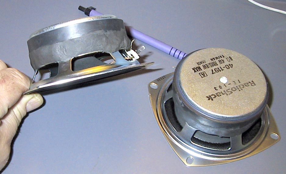

the thin pincushion framed Fostex drivers
Technically not a pincusion frame, as pincusion have just a flat piece of metal as the bezel (ie RS 40-1197). The pressed steel Fostex frames have a shaped bezel which increases strength, but are still thin enuff to have little-to-no impact on the sonics if surface mounted. A rebate is primarily for cosmetics.
RS40-1197
It should be noted that the clever curves are all over the basket, making for a nice frame.
