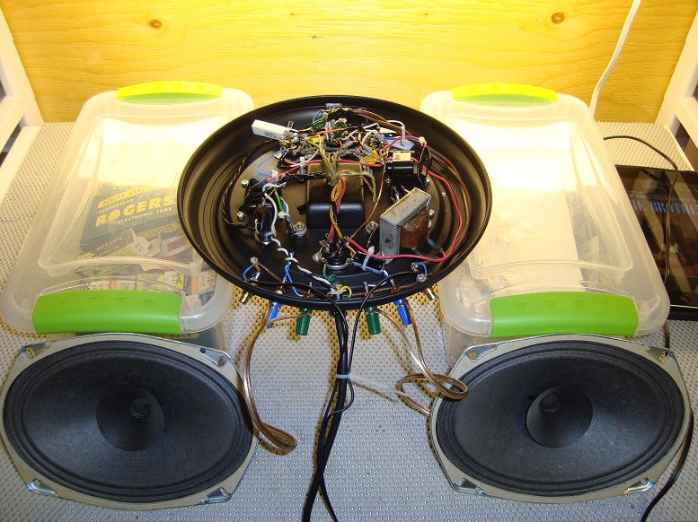

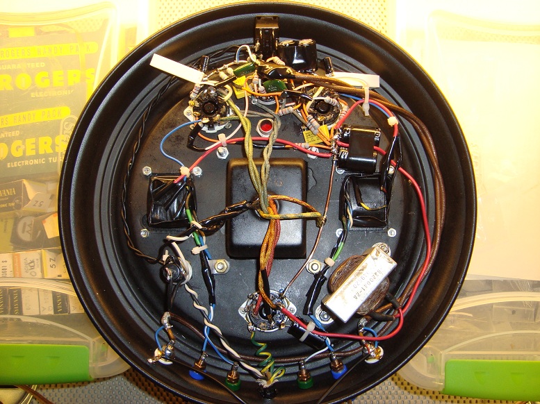

So the amp is pretty much complete. One snag I have is those cheap gold plated RCA jacks. They are too small, broke the tip off of one of my cables and everything. I can't say where they are from, I got them free with some parts I ordered off eBay. I have more, maybe I can drill it out a bit, I would rather find something different to go in the same holes. So for now I just tacked the RCA cable to the jacks on the inside. I also need to make up a base when I get some wood next.
I am a little over 300B+ so I upped the 6V6 cathode resistors to 330ohm from 270ohm.
The 12AT7 has a slightly cathode higher resistor, 270ohm rather then 250, this appears to be at 6ma.
As far as I can tell the 6V6 are running at 44ma, so I might have to address that?
Now I might be able adjust the B+ down a bit by adding around 150ohm to the power supply.
Right now it is just a basic pi, consisting of 22u-1.5H/53ohm-80u.
I was not sure on how much of a negative effect having a resistor added, but I'm sure it would be fine. If I did add the 150ohm I could add more capacitance after the choke as well.
Thoughts?

I think my 6V6 are running at about 44mA and 300V. Seems a good choice.

I wanted to add that I do get a bit of hum from the PT.
When I did the test, I did not have the center tap on the OPT secondaries connected, that's why I got no hum.
It's not bad at all, I can certainly live with it. I am using pretty efficient speakers too.
Just something to consider with this small of a chassis, now mind you if you spin the OPT's 90 degrees or flip them upright you could likely get rid of it all together.
I did not have the room or the option with the Telefunken OPT's.
