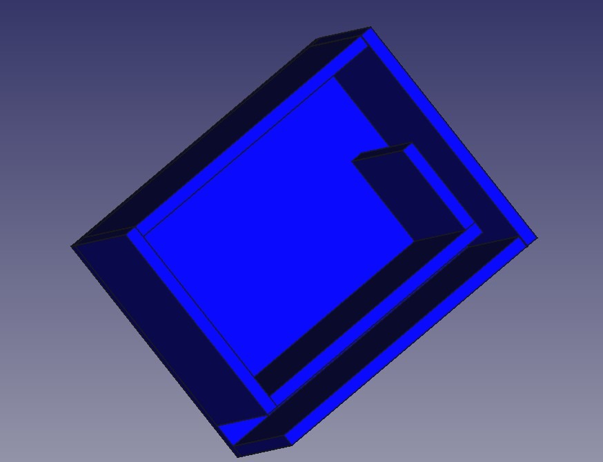

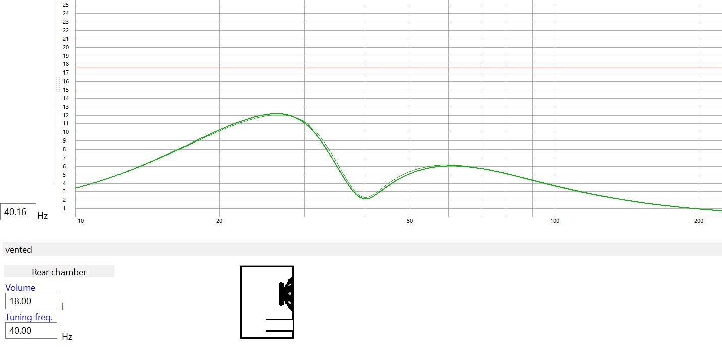

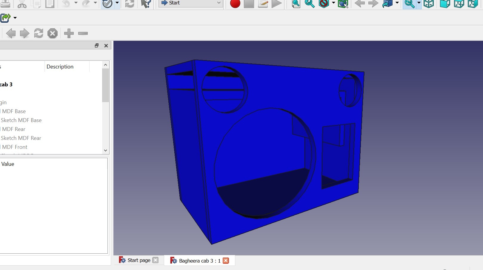

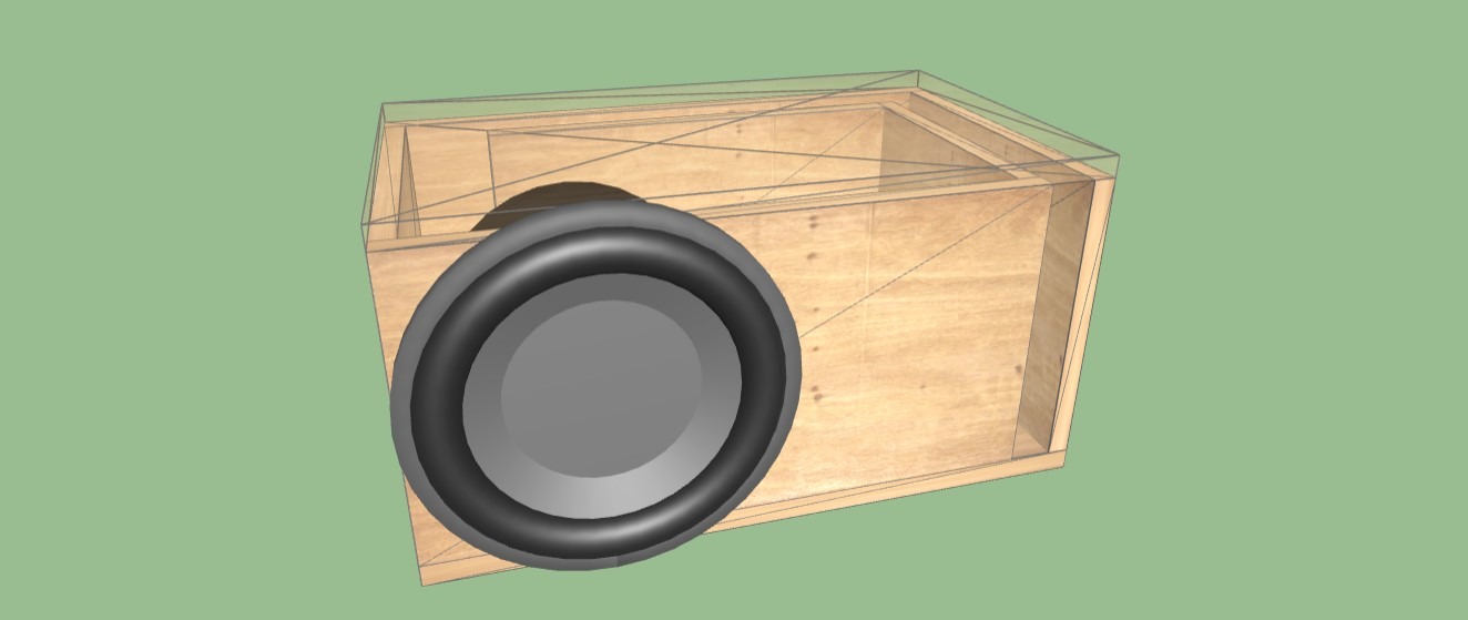

Freecad model of the bass driver section. This is 48cm wide and 18L, tuned to 40hz. Today I tried to get Bunnings to cut the MDF for me, but their wall saw was down. Tomorrow I am driving out to Bunnings in the next town. I am ok with MDF for prototyping

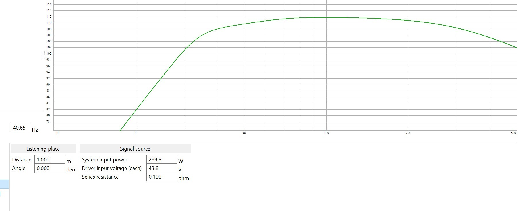

The SPL and excursion plot for the 10" in the 18L net cavity, signal is 300w

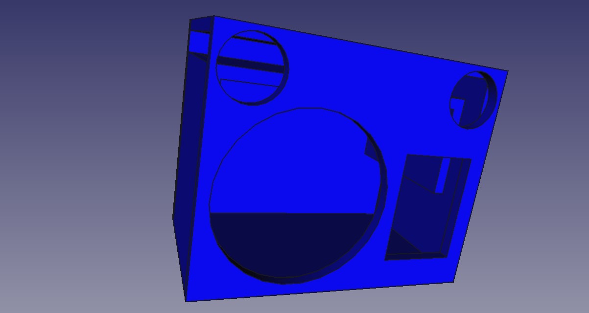

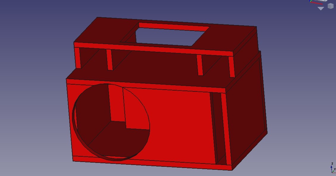

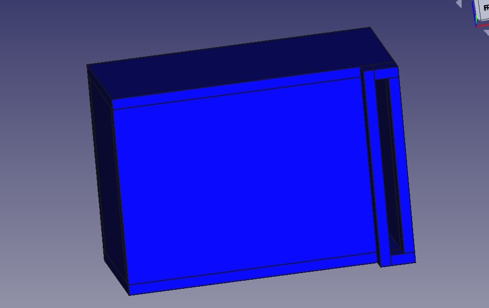

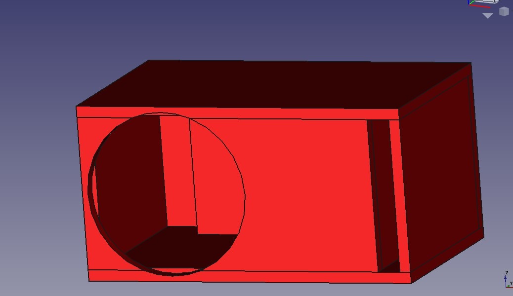

The complete MDF skeleton model, including some of the electronics and full range driver cavities. This is all the wood work apart from the location holes for the fastners and such. Once those details are sorted, I'll add them to the model so that I can CNC them into the panels prior to assembly of any additional units. This project should warm up my creativity for breaking away from the fender and marshal lookalikes and black boxes. I am building for a presentation that freshens up retro appeal with correct use of colour and modern aesthetics

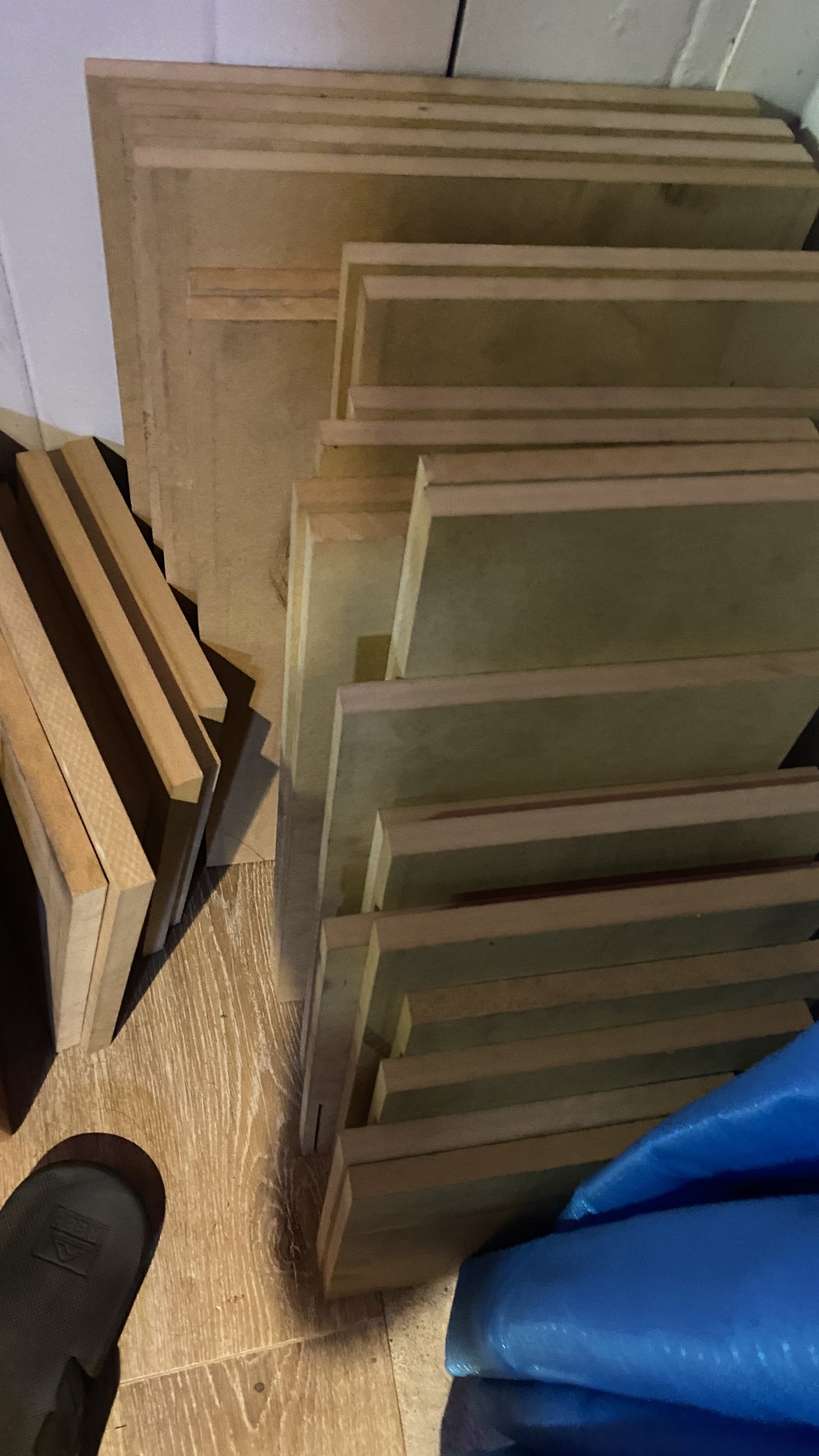

Had all the MDF cut today. One sheet yielded enough for two cabs. I’ll do the juniorcat version with the jfet based Uffornica preamps and tone controls. These 7” SVC and 3” pair (140wrms and 35wrms+35wrms) are from the first prototype with a solid two years of use in various venues for school and concert and concerts prior to that as DJ booth/desk monitors for five years work
We got back home from the town where we got the MDF from pretty late so glueing will be tomorrow

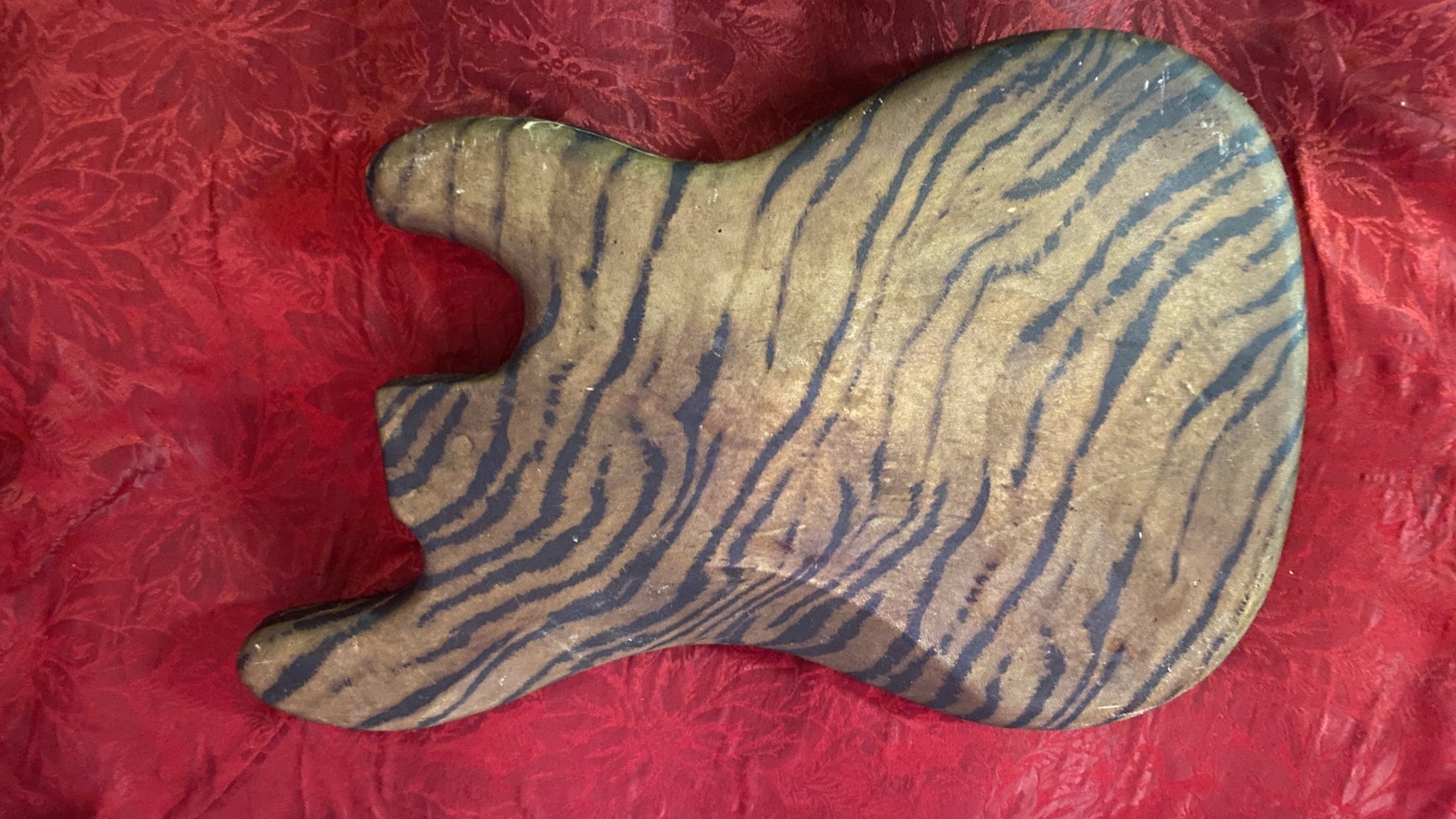

Working on another halted project tonight while my wife is studying. I have only been playing fretless as I prefer the sound and my thumb just knows what to pluck and fingers knows where to lay when playing along. I want to learn the theory side and picked up a fretted PJ bass from the only music shop in town a while ago
Being a lefty meant only one item to choose from in the store. The finish is plain black and I hate it. I have been doing her up and just working on a wet tiger appearance. And yes I would rather call her wet something other and more acceptably, “Sonehri”

Trying to glue this up today and it's not happening. Most of the cuts are off. 290.7mm has been cut, 297mm and so on. A couple of bits are short by 10mm. There is enough in the offcuts to make up for the short bits. I might be able to still glue and trim all the excess with a router. The whole point was to keep this dust less at home. Our local shop has a master on the saw, so this has never been an issue before. I need to look into some CNC DIY forums to see if my machine can be modified with longer rails
Also applied a top coat to the front of the bass to lock it all in. The rear is already ready for wet sanding. This is done the same way as applying skin or feathers to fishing rod blanks. I did extensive work with layering and inlays in a previous enterprise

Trying to get the guy in Bunnings Maryborough to understand the nesting was painful. He was a junior and the only guy in timber on shift. I only paid $12 as the sheet was only $2 being the capping sheet. $10 for the cutting. Took him over 1.5 hrs. Not worth the grief. The local Bunnings panel saw wonth be fixed till the new year

The MDF has been very badly cut. All the wall heights were cut 2mm short and aren't square. Some cuts were off by 10mm and some 4mm. Squaring up has left the boards even shorter. I think this bunch is a write-off. This design is also poor for wood cutting efficiency and increases the tediousness levels of this project. Turning the box around in my mind, I think I can reduce panel count by 5 pieces, if I move the electronics to a different area
It will be better if I did the new box cuts using 18mm ply instead of MDF too. I am tired of bad cuts at the hardware shop. I started the following thread regarding the table saw that I will be getting and a mod project for an accurate and repeatable cutting system

Had the boards cut at the local Bunnings today. Couldn't find any 18mm ply so decided to with MDF for the prototype. I was attended by a senior who is usually in the paint section. He did a fine job, and it should come together nicely. Still, the mucking about it took to get all the cuts right was annoyingly painful and time-consuming,. My speaker saw project makes more sense after experiencing what it takes to get a box cut right on a full size pro machine
Also finished up on the 3D model for all the woodwork needed and baffle cutouts
