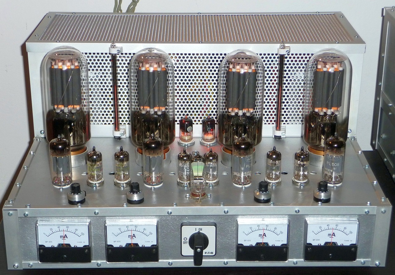

Hello elac310,
I also have built such an amp with about the same configuration than yours, but as a push-pull version. Phase inversion is done by the input transformer (Sowter, 1:1+1), followed by a PCF200 - Triode input amplifier, Pentode voltage driver for the 211. Followed by a PL508 (former vertical deflection output in color TVs) adding the necessary current needed for operation into the positive grid range of the 211 (galvanic coupling), so I can use quite a low plate voltage of 750V. The PL508 do not only have a cathode resistor (820 Ohm), but also a choke formed by the 8kOhms primary winding of a small PP output transformer - to reduce the loss of AC driving power. Biasing of the 211 (actually on 70 mA) via the grid bias of the PL508. Output transformer 8 kOhm, 100W from Experience Electronics. I am using the Psvane 211 (the pair at ca. 300€) which have already about 3000 hours (counter) - and are still in perfect shape. Really good quality. Heating by two Meanwell switchmode supplies (adjustable) 12V 10A over thermistors and additional RF filter chains. The amp is dead silent, I mostly use it as home cinema amp due to its power and dynamics. Friends of mine love its smooth performance with classical music.
Salut de la Moselle, best regards 🙂
Uli
Uli
