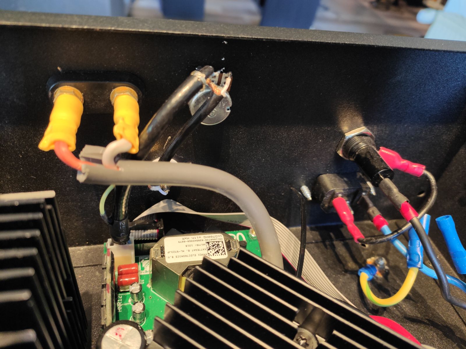

Oh, two images of the setup:
Setup:
RCA connection UcD700 (with volume pot, since it will be used for subwoofer duties):
